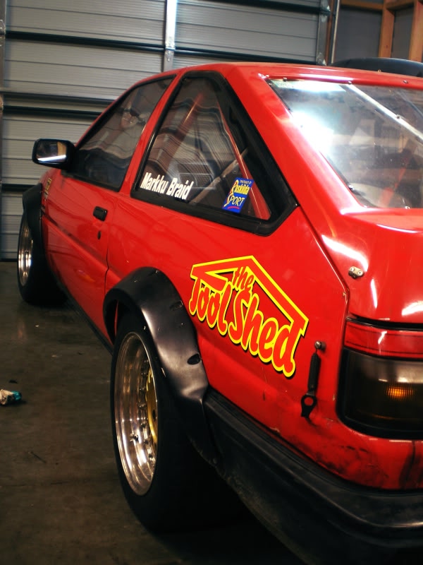

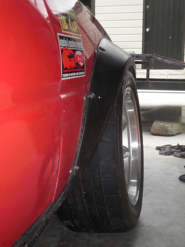

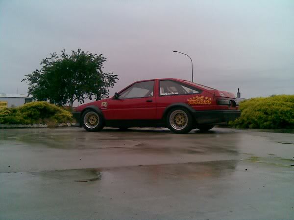

I then had a break from the race car, focused on Uni assignments and spent my time being boring. But that's changed over the last week. It needed work - a new CWP set in the diff, sealing a leak in the diff housing, getting new brake pads.... And slamming it by 30mm.
To lower the rear meant making shorter extensions for the top of the shocks as there's no room for up-down movement on the thread.
Front:
Rear:
The car feels considerably lower when you walk around it now, which is cool. It also needs more castor but there's a clearance issue with the LF inner guard where the battery bracket lives... Will chop that out and replace it with panel steel on a more generous angle, pull castor, cut the bumper and flare for clearance and go for a skid.
Hopefully it handles better :P .

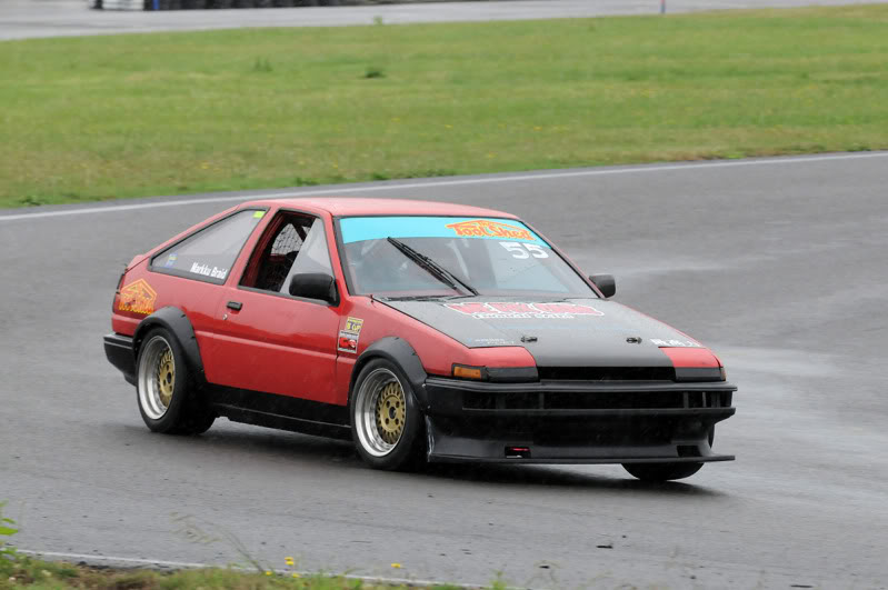

Took it to Manfeild with the new lowness and noticed definite improvements. It was raining for all of my runs so we were unable to get a real idea of what was going on with the car.
It now has truckloads of rear grip. Moving the panhard rod and adjusting the four link setup obviously worked, along with more front castor. I was able to plant boot at the same points I usually use in the dry. Any sideways was predictable and easy to hold. A+
We're going to have a play with the front setup at the next dry day cause it wasn't turning in too great. This could be a result of a wet oily track so dry time is needed.
Feels good to be making changes that have the right effect!

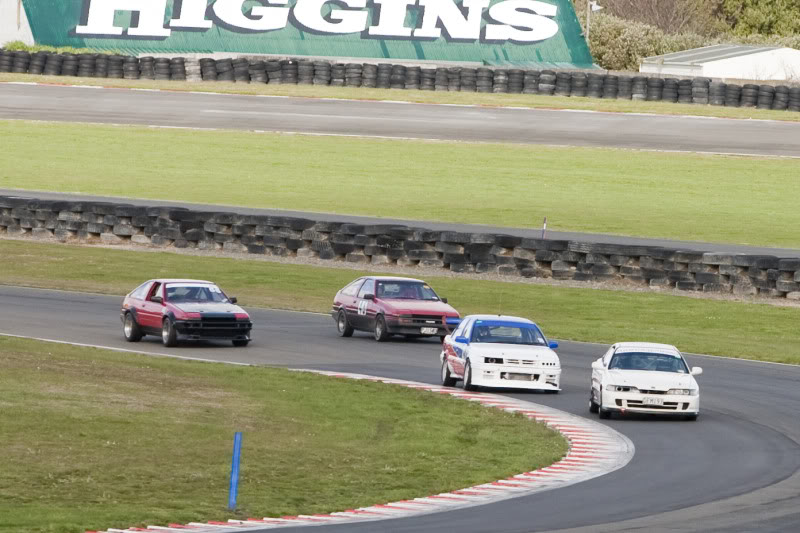

Tested the setup in the weekend at the IRC race meeting and all is well. The front suspension feels good and the rear is reasonably well settled. It needs more fine tuning but we're starting to get there.

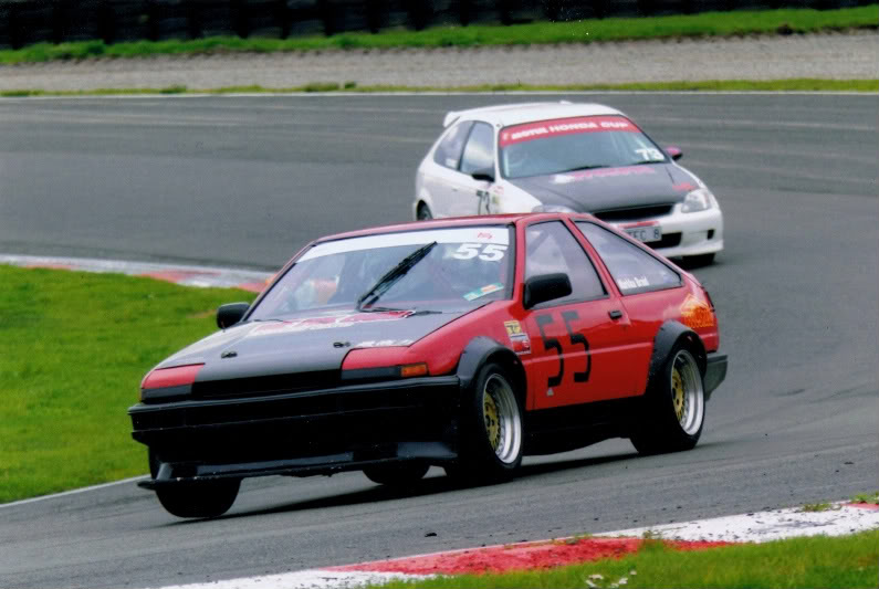

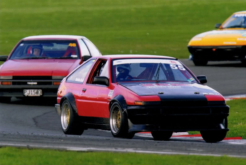

All three of the weekend's races were intense and busy, which made for an exciting weekend. Qualifying was wet (which works to my advantage) and I ended up qualifying on pole after two hot laps. Then the gearbox jammed in 4th gear and wouldn't come out, so that spelled the end of qualifying.
We pulled the box to re-locate the selector and had it all back together in the nick of time. Made it out JUST as the field was leaving the dummy grid. Drove around the warm up lap and took my spot on P1. It was dry so I took it easy-ish off the line and was swamped by escorts and Paddy in the Ute which meant I had to play catch up for the rest of the race. Managed to get back up to second and was on Paddy's tail at the finish. Good race.
Race two was a handicap ( :salute: ) with Paddy & I starting from the back. Missed a gear off the start again and fell behind. Still managed to drive through to 6th and had a sweet battle with a Torana driver who was quite adept at blocking lines.
Race three was the best of the lot. I started 55 seconds behind the lead car and Paddy started 5 secs behind me. We had a lap or so of hard running on an open track. By the time we caught the pack they were all together, so we had to find gaps around each corner. Craig slipped the ute into a tiny gap on the inside of dunlop and took a 8 places in one lap! It took me 4 laps to do the same and I ended up in third.
So overall it was a successful weekend! It was a lot of work but it all payed off after three trouble free races. I broke a left hand axle in the pits as we loaded it onto the trailer... Lucky timing! It might be time to figure out how to shoehorne an F series head into the T series housing.

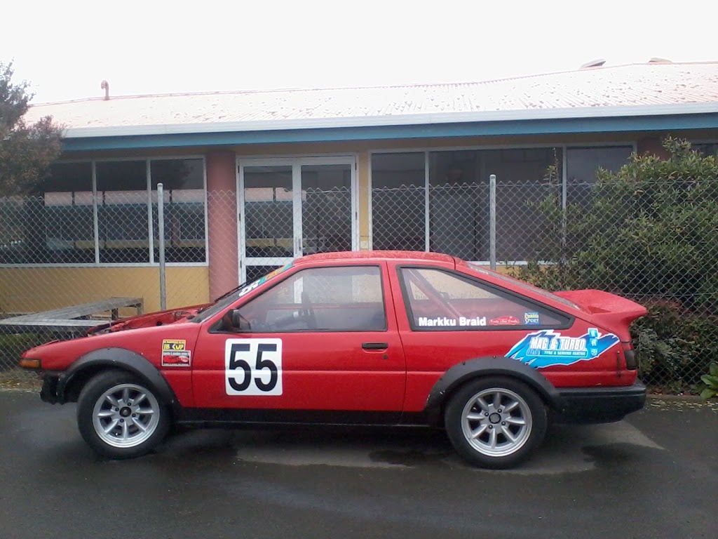

Pic for proof - the slam makes it look LOTS cooler in shots. And Richy's photography isn't too bad either :P .

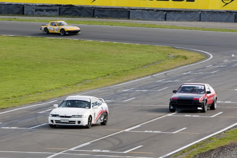

Threw this back together and went for a skid on the weekend. The car went really well and I didn't need to touch it all day - bonus.
I've also dipped back into 1:20's for the first time since 2009.
I did ZERO car prep apart from skimming the discs and spent the day running on RA1 semi slicks... And was consistently around the 1:21 mark (+ -). This means I'm going to be too fast for the IB cup during winter series, so will need to run the old worn Advan's and possibly change gear at 7000. I don't want to cheat by doing a fast lap and slowing down on the straight, so if I go too fast and get penalised, so be it.
Here's the one vid I got from the day - first run against a V8 MX5. He had straight line speed but was slower in the corners.

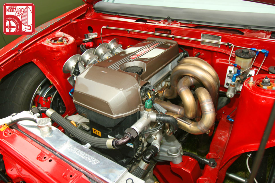

Engine bay will end up similar to this but with a couple of extra bars:

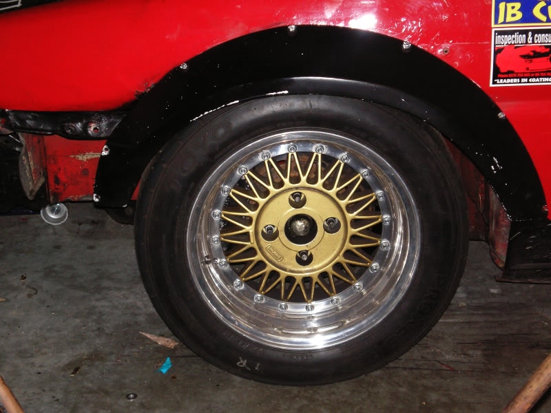

Also thinking about having all my wheels widened to be 15x9 -25, approved?
Here's a pic so I'm not wasting your time

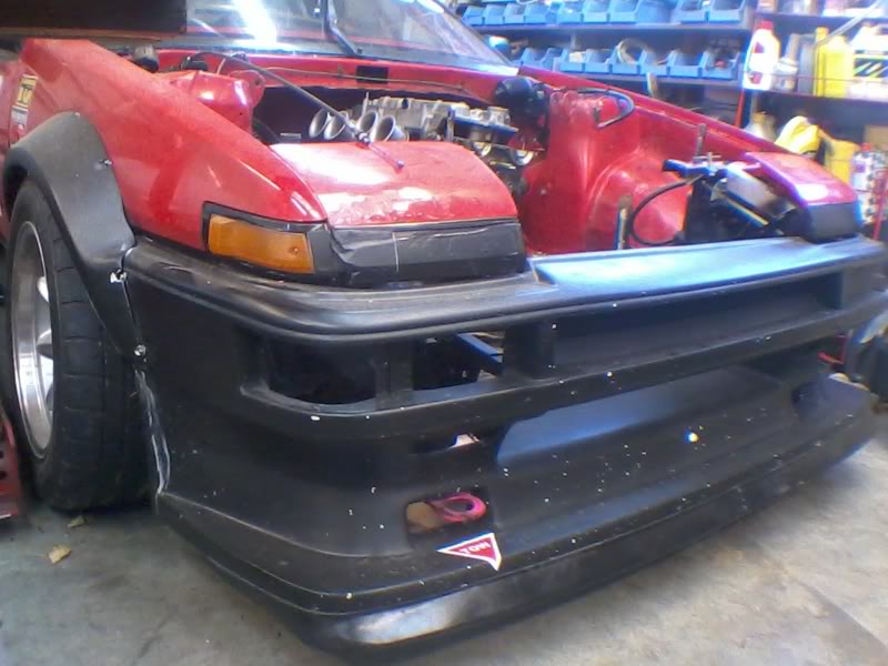

My foot is pretty screwed again, so I've played around with a couple of basic things.
Test fitted this:

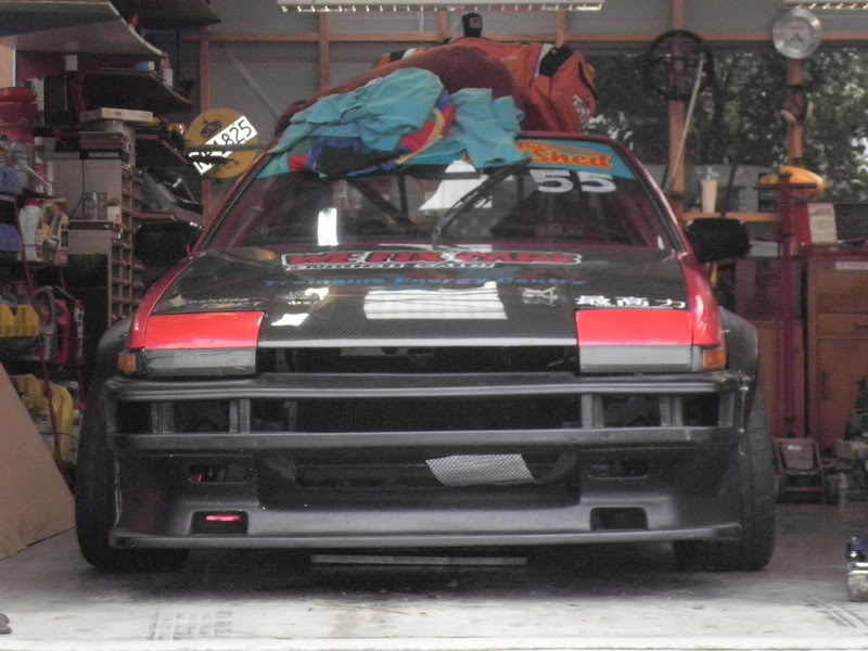

And this front lip (still need to figure out how to mount a splitter tray underneath):
Next on the list is engine/gearbox mounts & driveshaft.

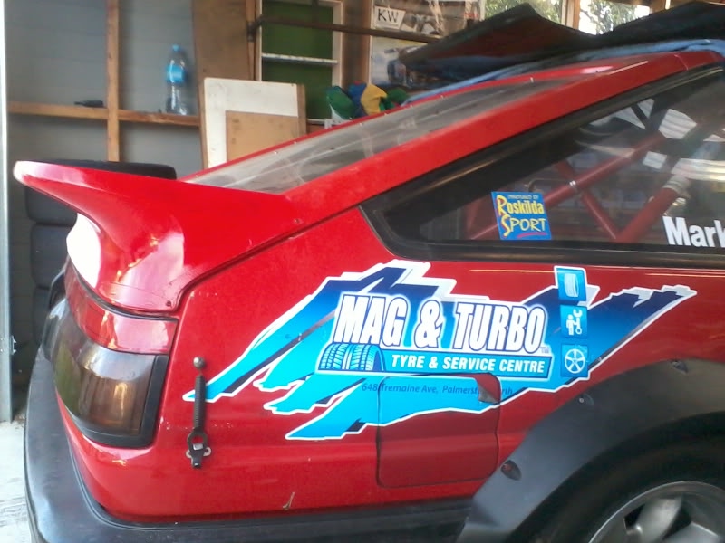

Added 1x ducktail

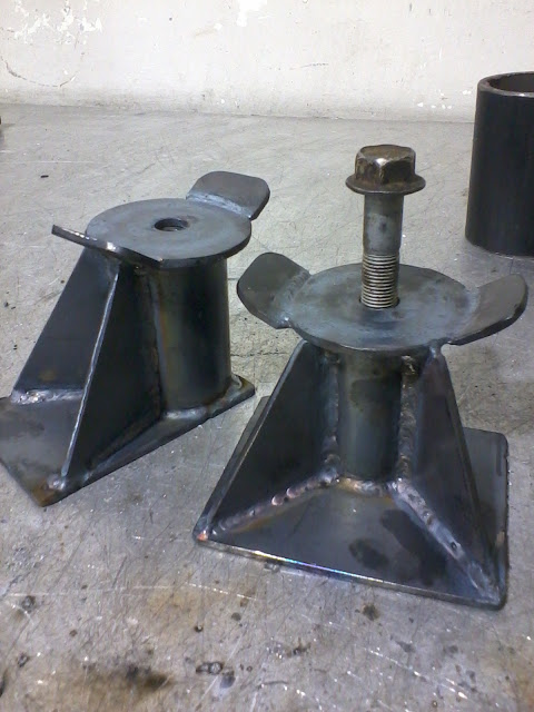

Cut out 2x mounts
Safery first
Mocking - far enough back?
Bit of sumpy cutty-weldy
