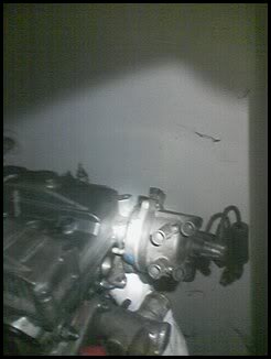

Started again at 11am this morning. First job, swap the sumps over (wanted to have the oil return fitting for my catch can). Turns out the sumps are slightly diferent.... It has space for the crank angle sensor and a lug in a different place. So we looked and thought some more and decided that the factory oil return plus a non-return catch can was good enough.
Degreased the engine and looked at it some more. The engine mounts don't fit up the same as the gen 3 block... Another slight difference. On the gen3 there are 4 bolt holes on the intake side of the engine, the beams only has 2, with another 2 further down the block. This means I'll have to make another mount plate for the engine and weld it up.

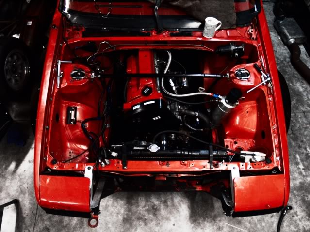

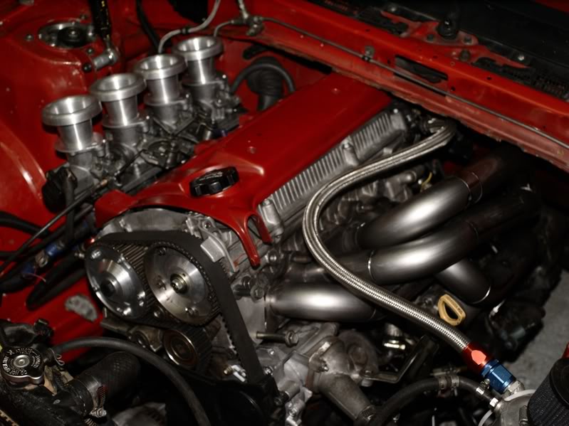

Also, I did something today. Curiousity/procrastination got the better of me, as I sat and looked at the intake & exhaust cams and cam gears.
Ended up deciding to try my luck and see if the Adjustable Exhaust cam gear was the right offset for the beams. It was. Followed that up by trying the Gen3 exhaust cam in the beams head.... It fits. Interesting.
Recently I've been worried about the possibility of the Beams not having as much power as my Gen3 - due to it's lack of cams and my lack of ability to use VVTi. That problem may have been solved today.
So I pulled all 4 cams out and went down to see the gentle folk at Kiwi Cams, told him my story and he understood exactly what I wanted to do. As we speak he is finding out a price for a brand new billet for the intake side to grind to my specs... And if he can't find a billet blank for a decent price we'll look at re-grinding the factory intake cam and shimming to suit.
So I'll have the same cam grind as the old engine in the Beams, and will only have to buy one cam and gear. I'll need to re-shim as the aftermarket exhaust cam from the Gen3 has a slightly smaller base circle than the Beams.
He's pricing an adjustable cam gear for the intake side as well... So once this is all decided we'll be good to go.
Hopefully eke_zetec jase will be around one night this week to talk about intake mani, headers and modding the engine mount.
Watch this space.

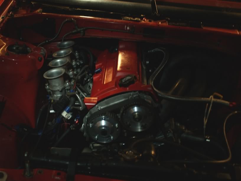

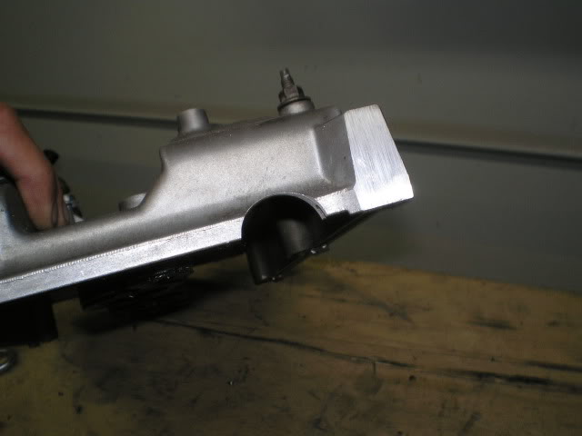

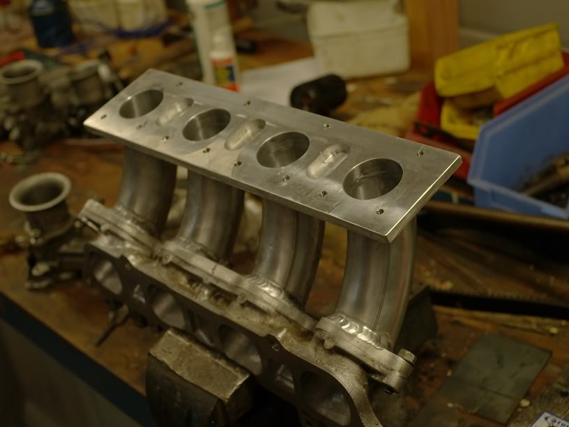

Bought some aluminium today - a metre of 100x10 flat bar for intake flanges and some 5" billet to make a cam gear centre.

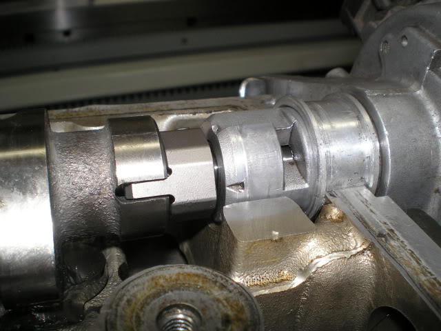

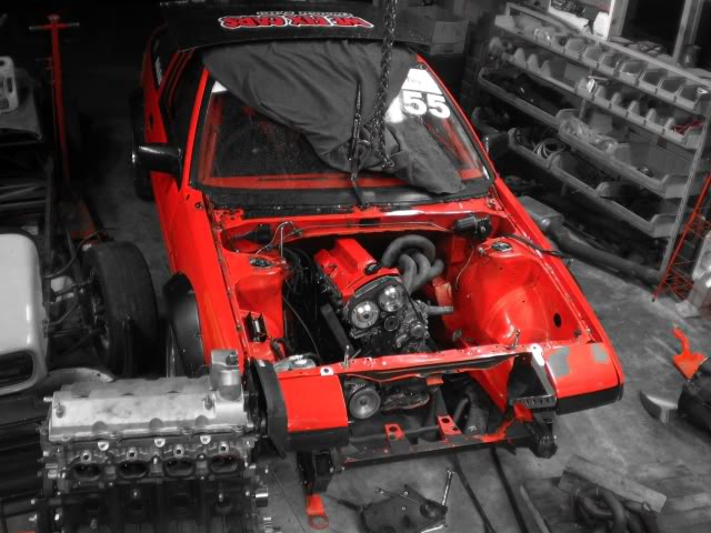

Jase (eke_zetec) came around last night and we figured out a way to run the dizzy off the back of the cam. This means the wiring wont need to be touched. Was going to have to go to wasted spark, but this is an easier option.

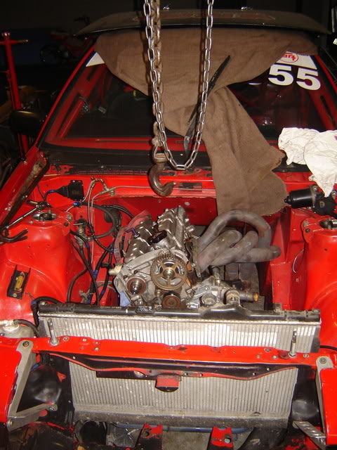

Dummy fitted the engine. The modified engine mount lined up fine and there is enough space for a dizzy behind the head. Good.
(Put the extractors and huge radiator in the pic for laughs)

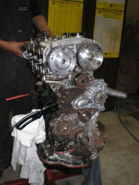

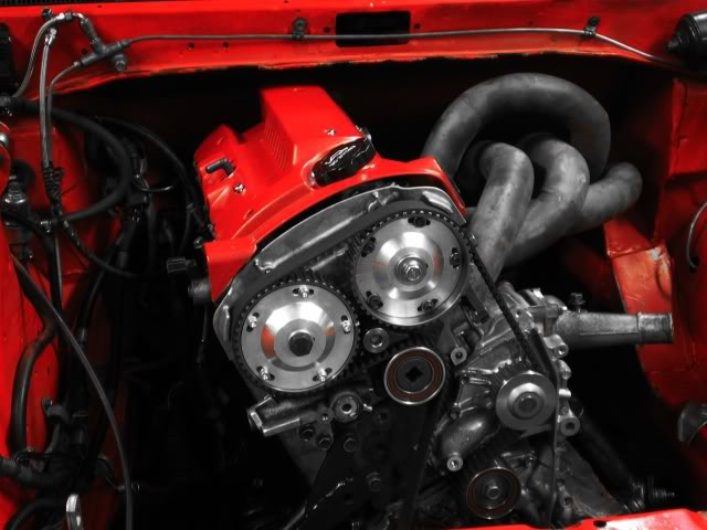

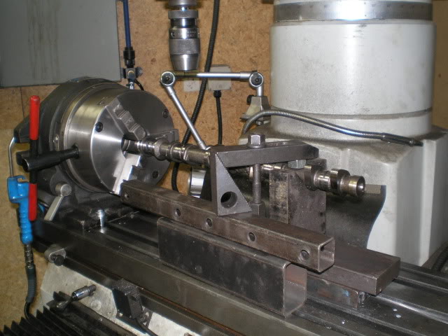

Adjustable cam gears made and fitted. One flange made with another two to come. The cam and cover will be machined to take the dizzy this week and I've got to make covers to block off some water galleries that are exposed. It's all happening.
Once the dizzy is fitted I can take it home, mount it and get it cranking... May even be able to get it running if the standard beams manifold will fit (T/B will be pointing backwards but it will tell us if we have our timing points right). After that the intake and exhaust manifolds can be made to get the business going...
No pics.
Dizzy slotted in the hole. Looks factory. Thanks again to Jase eke_zetec_rwd for the mint engineering. The cam still needs slotting but the main part is done.

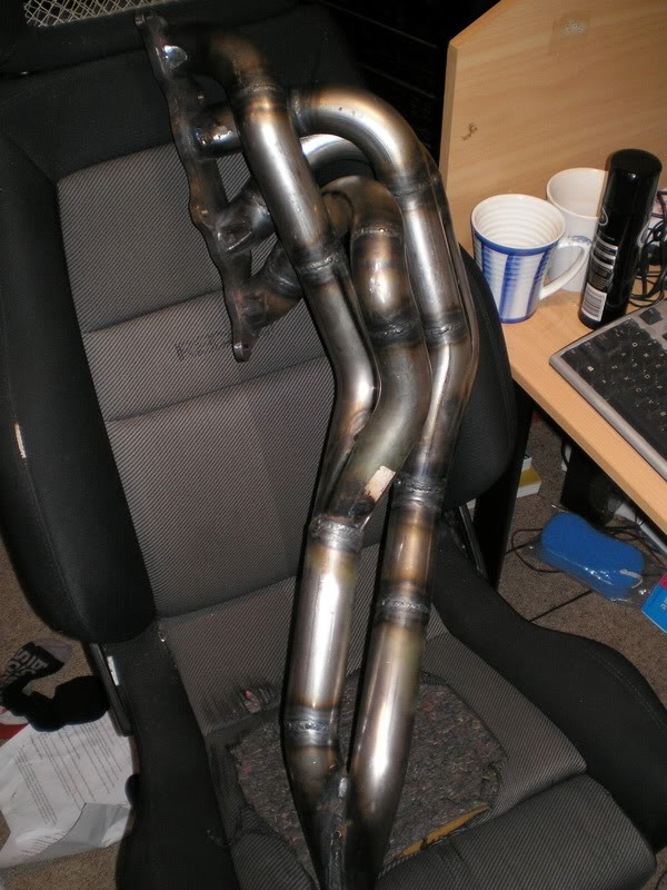

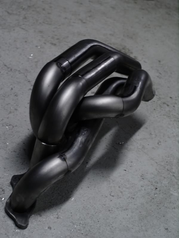

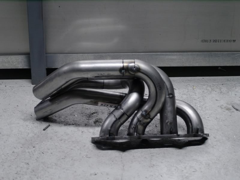

Also, John CXGPWR has lent me a set of factory Altezza extractors to get me going. This is just in case we run out of time before the winter series. It NEEDS to be running by June 5th.
So next on the list is to mount the thing (Maybe this weekend)... Then if we get really into it we can also put the FWD intake and T/B on it to see if it will run and fire in the right sequence...

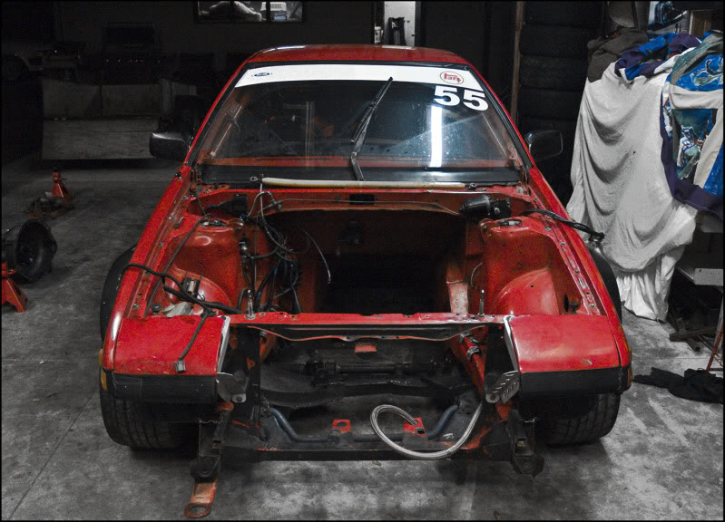

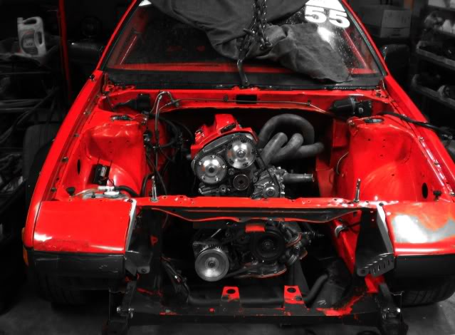

It's in for good this time. We decided it would be easiest to install the engine and trans separately because of the way the mounts work. Box will go in tomorrow.... Manifold time!
Still can't believe how well the Dizzy fits in there... It's almost factory (But lurks in the shadows in all of these pics).
Extractors are done. I'll do the exhaust and the rest of the extractors tomorrow and if my dyno man can make time we'll be tuning tomorrow as well!

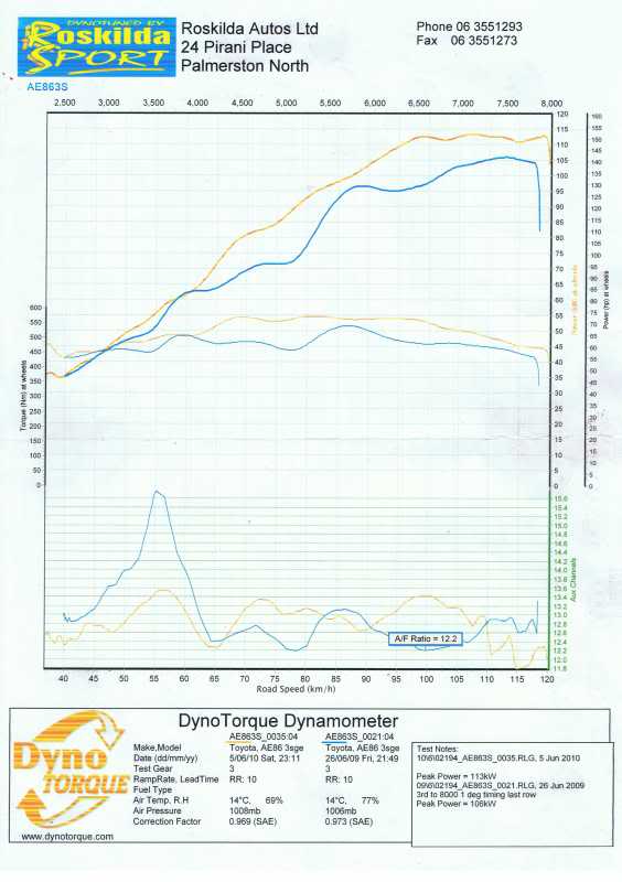

Got it bled after some feckling around and we went to see Rodney (my dyno guy) at his house. We mentioned that my beast was ready to run and he said "I'm heading back to work in 1/2 and hour to bleed the brakes on a race car, come along if you want to quickly tune yours".
So off we went at 8:30pm, unloaded the car and slammed it on the rolling road. We dyno tuned until 11PM!
The result of our quick tune was 115KW ATW. This doesn't sound like much but all we did was a safety check to make sure the engine wasn't going to explode. Within the 115kw, however, was a 20KW gain at 5000rpm and a 20kw gain at 6500rpm woth 80NM more torque, so you can see the potential of the new setup.
Graph - Blue = Old red = New.

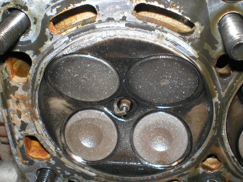

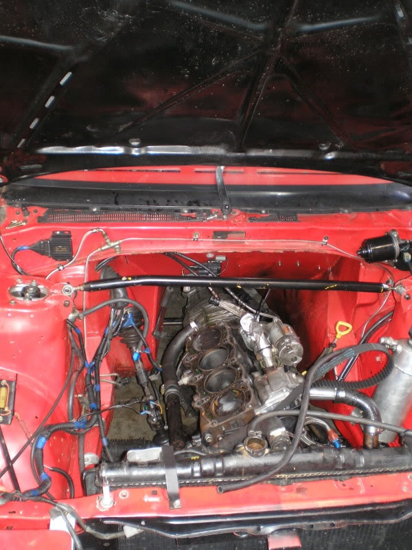

The engine detonated and died at the round 2 test day after about 9 laps it let go in a big way. After heading around Toyota into the sweeper and hooking 4th gear with a buried foot. *DOOF* - the cabin filled with smoke. I slammed it in neutral and turned it off as soon as possible. A quick look under the hood showed that it had breathed a lot of oil onto the extractors.
It looks like #4 cylinder has leaned out badly and detonated. The most likely reason for this would be a stuck injector - and it's possible since the engine was sitting around for a couple of years before being used. The damage is a melted piston and a dead bore - I think it'll need to be re-sleeved as the damage is quite deep.
Pics:
The bonus is that the head is OK (apart from having piston particles stuck to it)... So this might be the beginning of a race engine build... We'll see.
