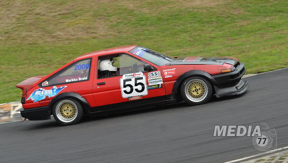

The Manfeild round went quite well. I had brand new tyres and am starting to get the hang of the car in this class. It's a big step up from the club racing I had been doing, so I've had to spend more time preparing the car and am pushing to find every small development I can.
New rose joints and a decent suspension tweak by the boys at Mag and Turbo in Palmy mad a massive difference, along with the new Hankook Z214 soft compound tyres. This was the best my car has ever handled! So we're moving in the right direction.
