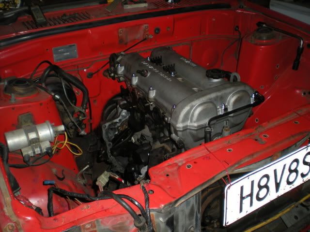

R100 Posted November 21, 2005 Posted November 21, 2005 I put an MX5 engine in into a RWD 323 was an easy fit, ask me questions and ill tell you everything yopu need to know, i used the MX5 gearbox with a RX7 tailshaft and bongo van selectors Quote

Bombsquad Posted July 1, 2011 Posted July 1, 2011 I put an MX5 engine in into a RWD 323 was an easy fit LIES!! Ive done it aswell and it was an absolute fucking slut!! It will depend largely if you want to notch the firewall or not, if you dont (I didnt) youll have fuck all clearance between the engine and firewall and the weight will be too far over the front. the radiator has to go in from for the slam panel (rx radiator with both outlets on one side) and you have to flip the thermostat cover to change the radiator piping (no biggy) I used th factory mx5 box with rx7 s1 tailhousing conversion and used factory gearlever hole and modded factory gbox x-member. Quote
