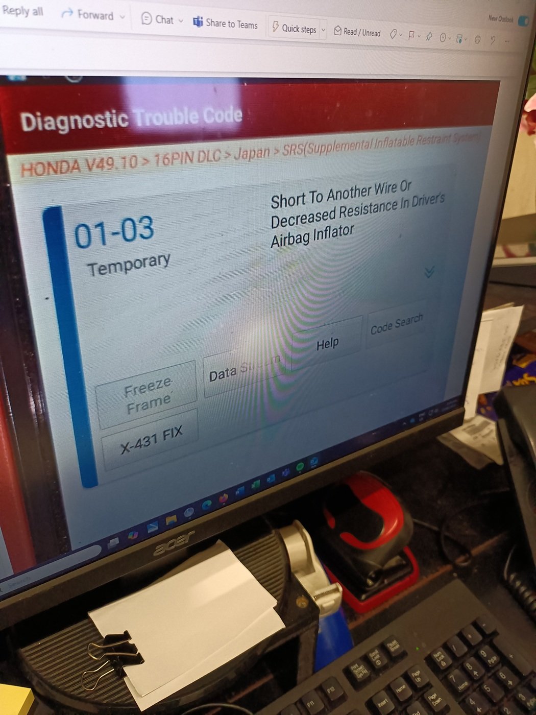

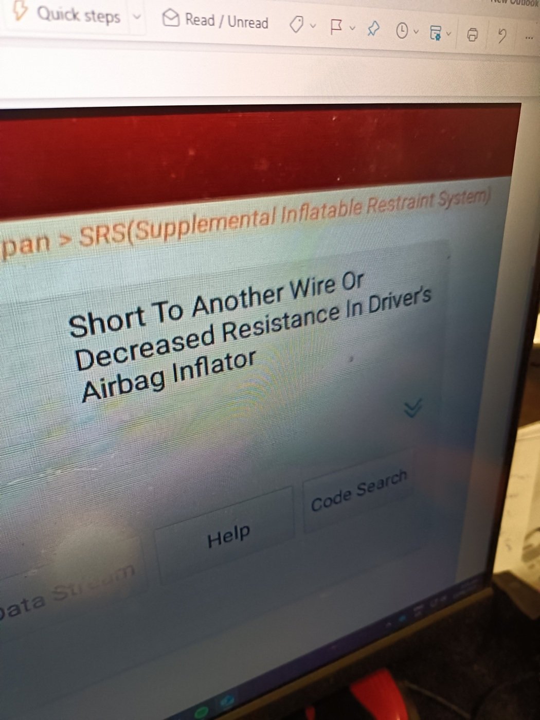

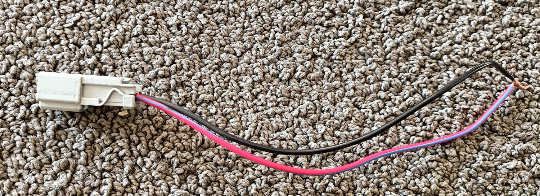

@fuel thanks for the tips - i searched high and low until last night i couldn't get a yellow plug to go back into what i thought was its spot. Turns out it goes into a blank spot and is an SRS reset plug. Check the video out below. I was hesitant about jumping wires, so I did the same thing with an old seatbelt plug. It worked the second time, as I wasn't fast enough connecting and disconnecting. It's funny that the new scanner didn't pick it up. It probably would have cleared the code if the plug had been jumped while scanning. So simple, but it worked. fingers crossed it stays out.

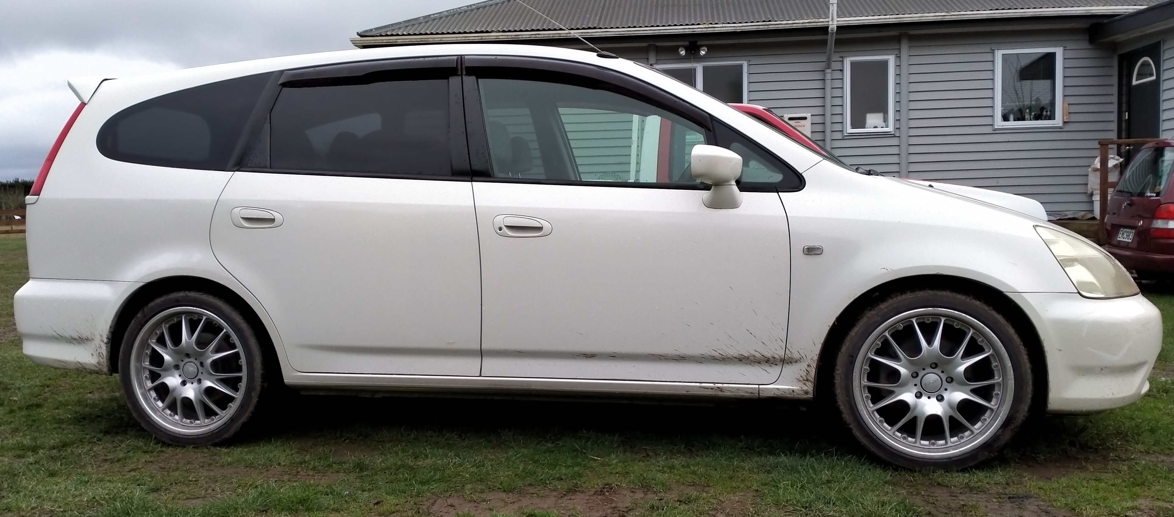

Hi guys, ill try to be brief . 2001 Honda Stream K20, I removed the steering column without disconnecting the battery (disconnected to reconnect). I had to replace a heater control motor, and that was the easiest way—they really like to stick those right where you can't get to them. I had the column on lock so the clockspring stayed where it needed to be, and yanked it out complete, wheel etc still on. Once it was all back together, i got the SRS light. Tried the disconnect battery overnight, but since found out usually a scanner job for SRS. Had scanned at local garage for free when they did the warrant - could not get it to go out and came up with this code. Went home a little deflated, but then realised the no seatbelt light wasn't working, under seat plug very loose, swapped out with another buckle of same model (spare car, same 2 wire plug) seatbelt warning light working now - still SRS on. Also swapped out the clockspring with the spare car just incase - still SRS light on. Should I just go back for rescan (im sure will start charging) with swapped bits and try again - anyone got a scanner to try narrow it I dont have another airbag to try as the spare car has deployed, was thinking maybe seatbelt but I didn't touch any of that. The spare car seatbelt pretensioner hasn't gone off so maybe that as a last resort. Any help appreciated.
