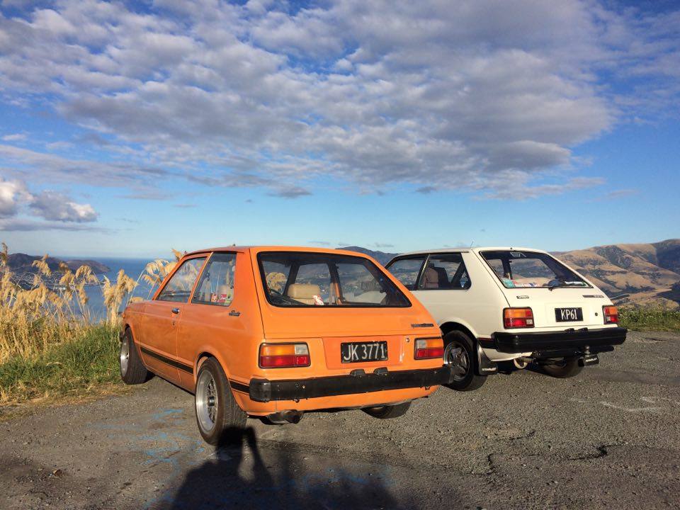

Baldwin (@malarky) managed to get a WoF/Reg on his bug so we went out for a celebratory hoon up the hills. It was also a good chance to test out my new Genuine Toyota thermostat - heaps better than those Tridon piles of rubbish. The Toyota ones have a far bigger actuator and a stiffer spring - leading to more positive action. They also have a bigger diameter opening, giving higher flow rates. The result is a way better controlled cooling system and no more high temperatures going up hills.
