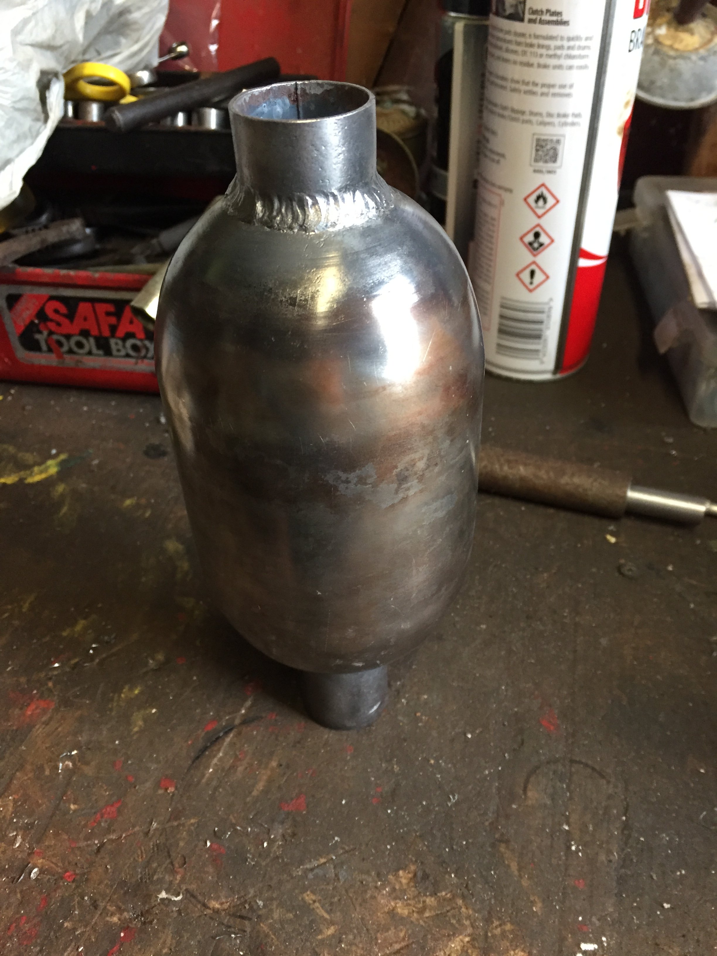

SOHC Posted October 2, 2019 Author Posted October 2, 2019 Suzuki all ways made the most strange little muffler things for the MX and trail bikes, I found this stainless steel thing, I will pack some scotch brights inside, 3 Quote
SOHC Posted October 3, 2019 Author Posted October 3, 2019 Muffler is finished, I think it was ballcock from a toilet. 7 Quote
SOHC Posted October 3, 2019 Author Posted October 3, 2019 I ended up drilling twice as meany holes in the muffler core before welding it in, 7 Quote

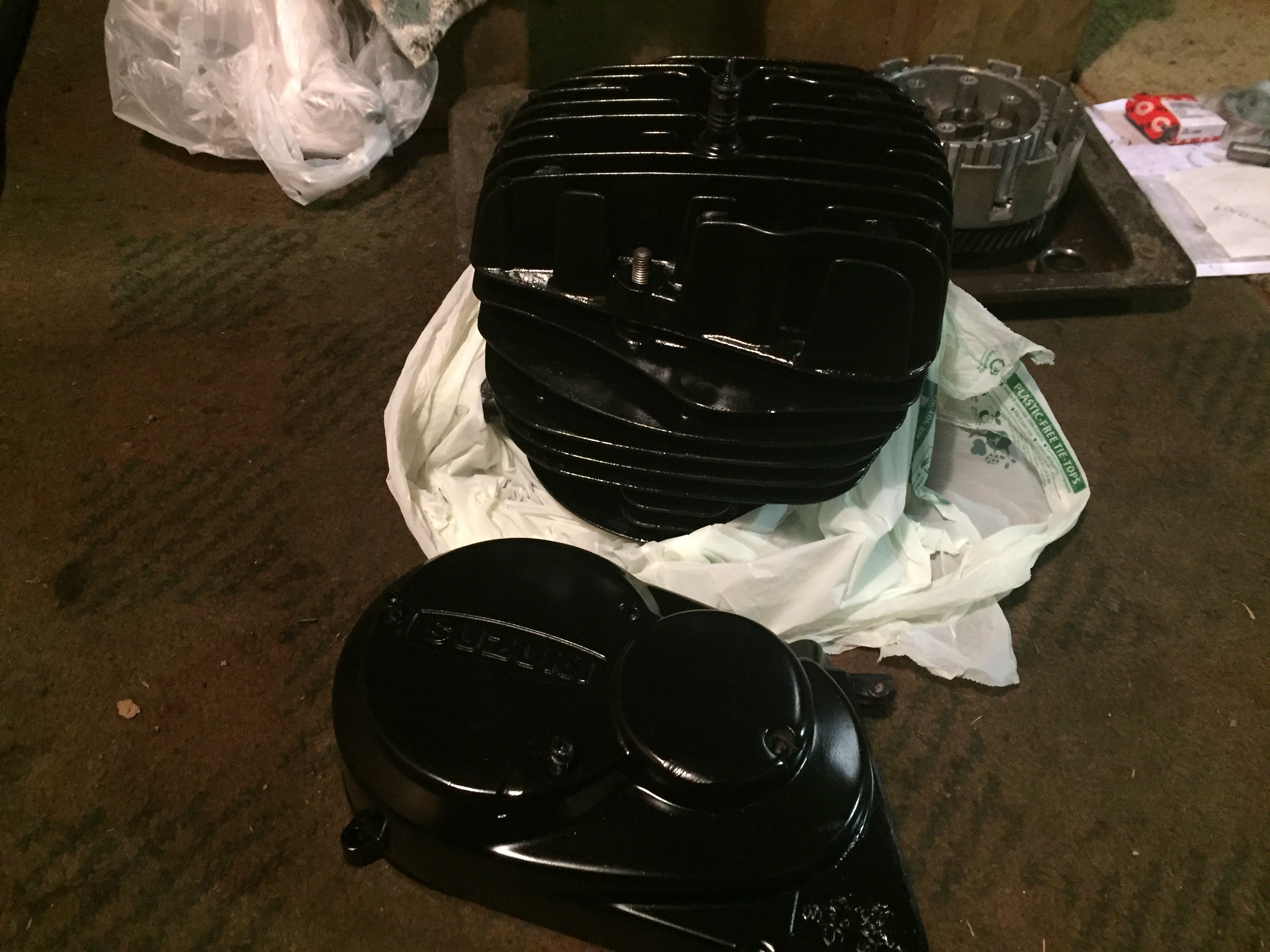

SOHC Posted October 16, 2019 Author Posted October 16, 2019 Started painting engine parts, I am going with a black engine, with VHT paint you never know what’s going to come out of the can, it sed mat but it’s gloss, brakes rebuilt, surprisingly the shoes are still good 3 Quote

Raizer Posted October 16, 2019 Posted October 16, 2019 Cold there? I'm finding with vht high temp and CRC satin black it they both come out glossy and take forever to dry on cold and humid days. Warm dry days they are mint and matt/satin like normal. 2 Quote
SOHC Posted October 17, 2019 Author Posted October 17, 2019 18 hours ago, Raizer said: Cold there? I'm finding with vht high temp and CRC satin black it they both come out glossy and take forever to dry on cold and humid days. Warm dry days they are mint and matt/satin like normal. I heated the parts so the paint dried very fast and I baked it a bit once it was on, 1 Quote
