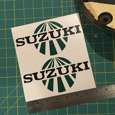

SOHC Posted September 29, 2019 Author Posted September 29, 2019 Could someone make me a set of tank decals? someone here was good that. Quote
Truenotch Posted September 29, 2019 Posted September 29, 2019 37 minutes ago, SOHC said: Could someone make me a set of tank decals? someone here was good that. Yip, we should be able to do this. Hopefully we can find a good image of the text to work with. Quote
SOHC Posted September 29, 2019 Author Posted September 29, 2019 5 minutes ago, Truenotch said: Yip, we should be able to do this. Hopefully we can find a good image of the text to work with. This txt looks to be the same and its bigger. Quote
