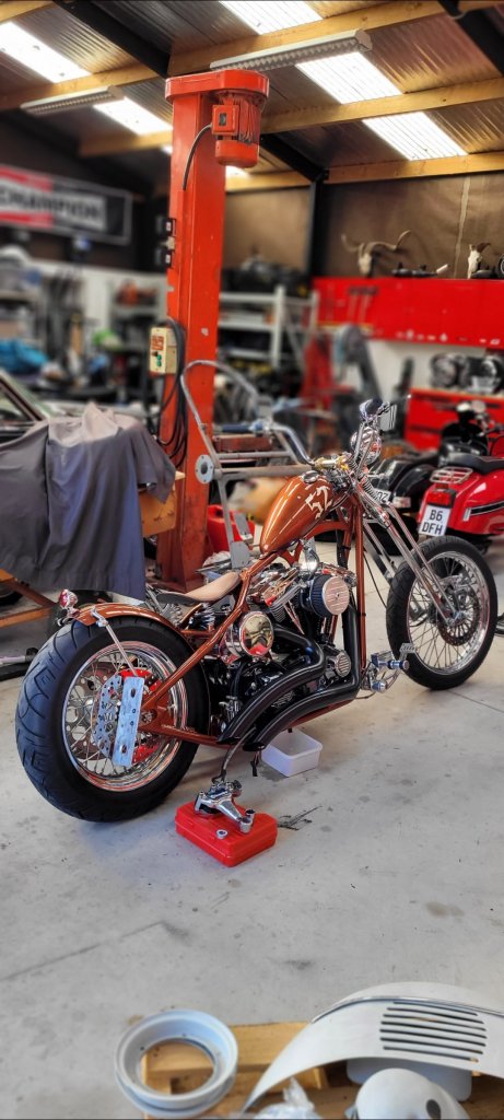

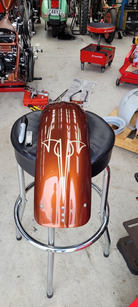

Need brake fluid, then could ride. But ideally I'd like to mount the rear fender before riding...but we'll see what happens

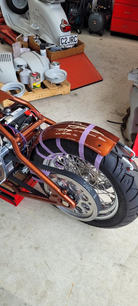

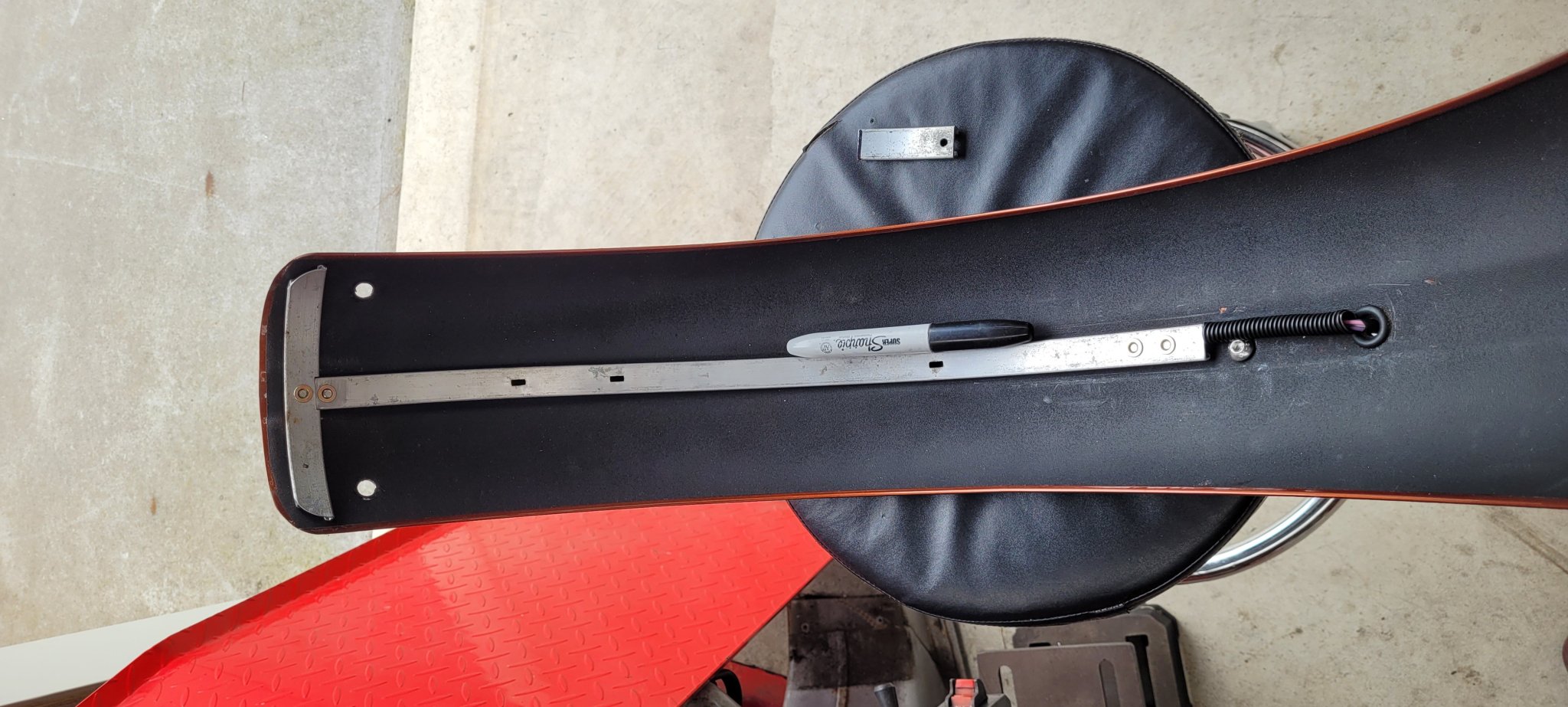

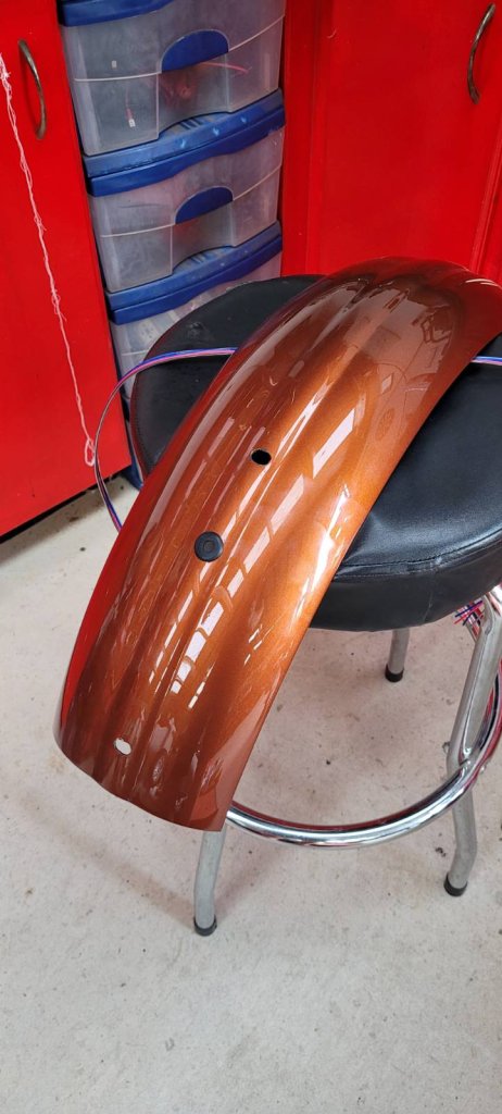

Setting up rear fender. Im redoing all my original ones, as they were set up on a 16" rear rim, but im now running a custom 17" rear rim (harley softail  hub, laced into a modern 17" rim) to add extra ground clearance.
Fuck the fender...I can ride it without one.

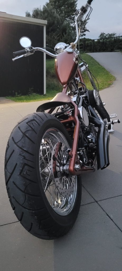

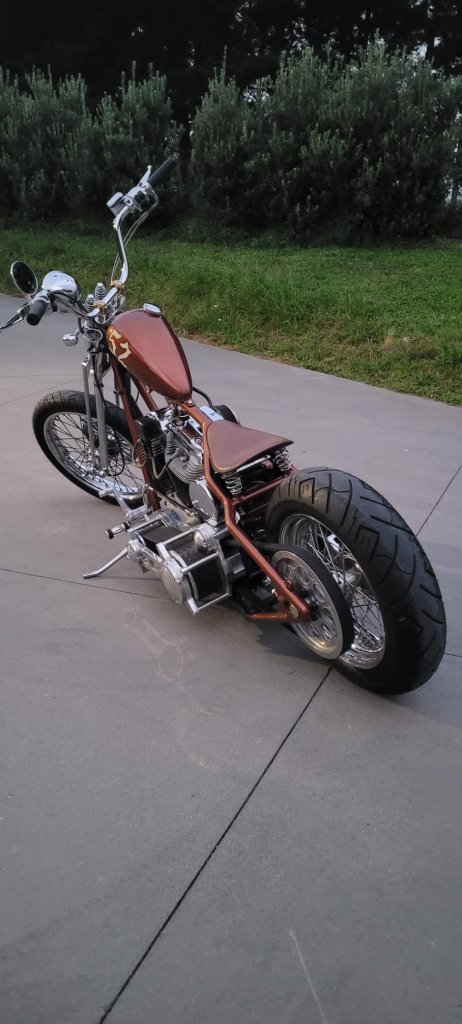

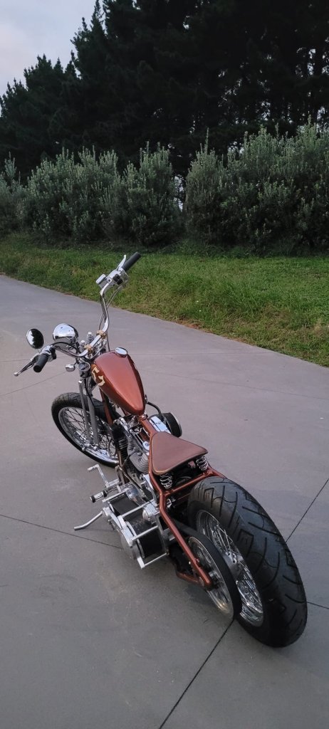

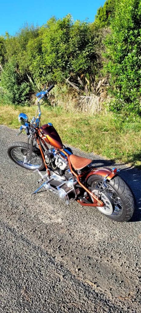

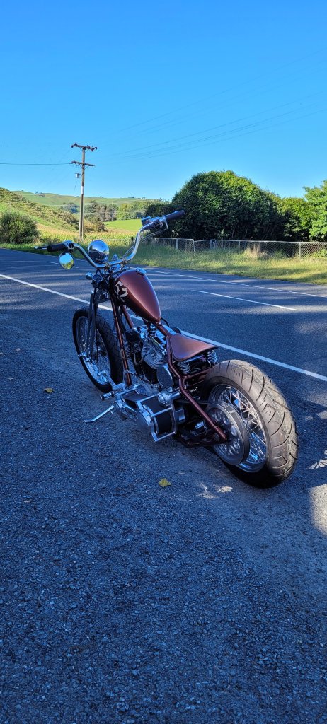

First test ride went smoothly. Nothing weird happened, and the ride quality was better than expected, especially taking into account that I've got 36psi in both tyres to set my fender gaps off.

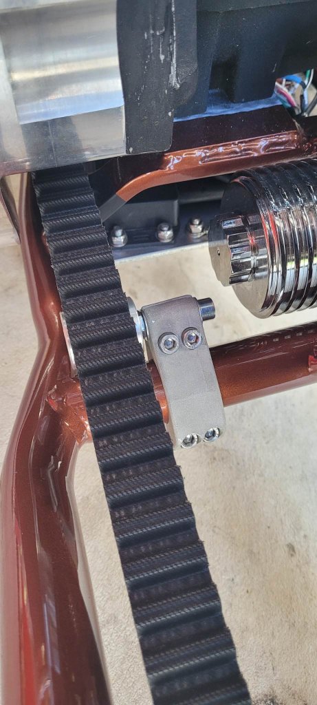

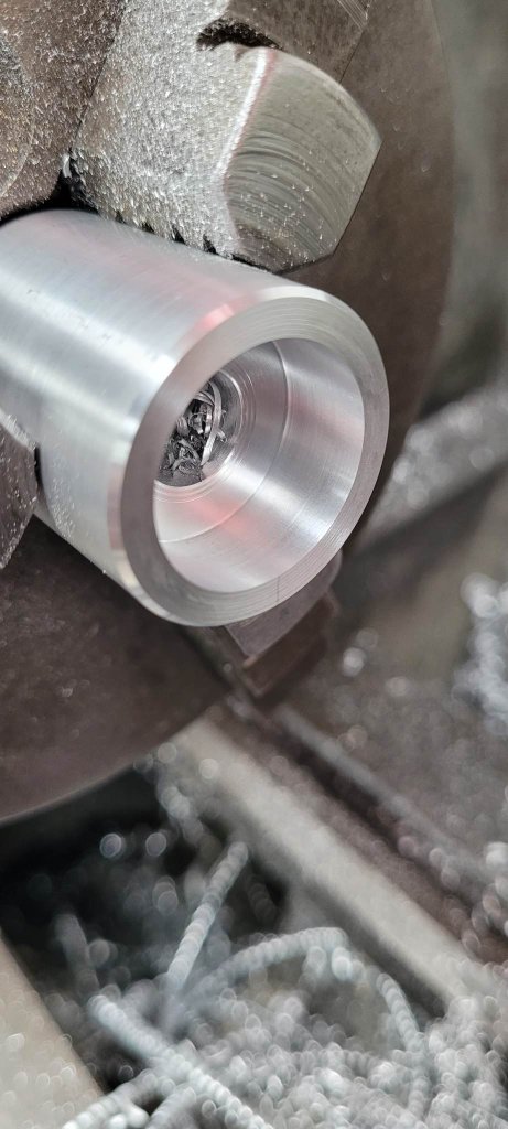

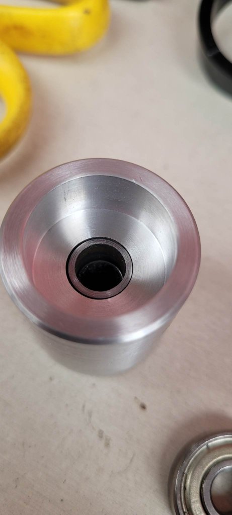

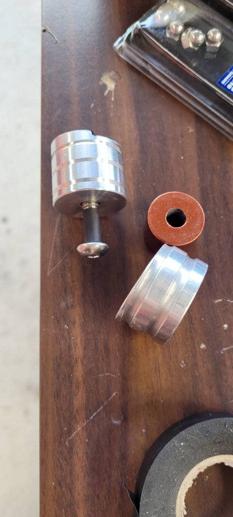

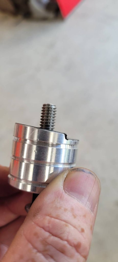

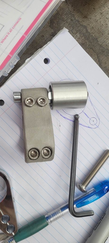

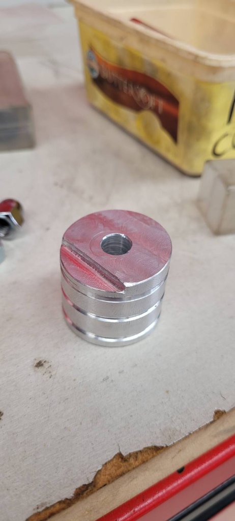

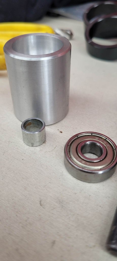

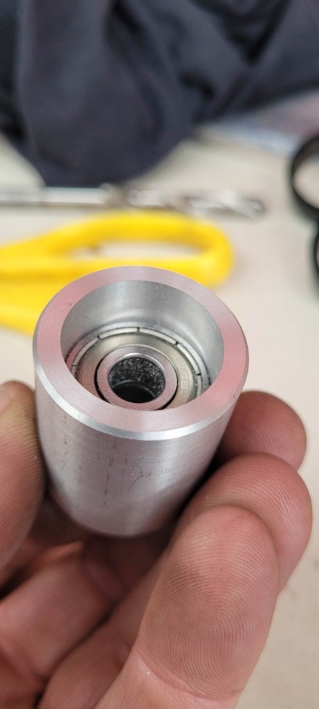

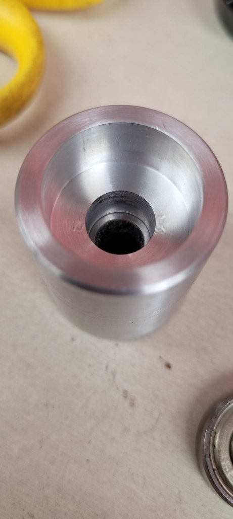

Pretty stoked with this belt roller, solves a problem and doesn't look out of place.
Ive designed it to only be in contact when the slack side whips around, normally if you chop the throttle harshly. The rest of the time it won't touch the roller.
Made fender struts today. I'll either powder coat or get them chromed eventually.

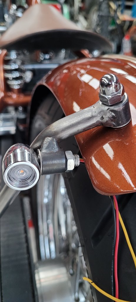

My mind had been going in circles with turn signals, as whatever I try...its ugly. Unfortunately the rules for these require them to go in the worst place visually to be compliant.
I'll run these for now, come back to it another day (or not?) If I still hate them in the future.

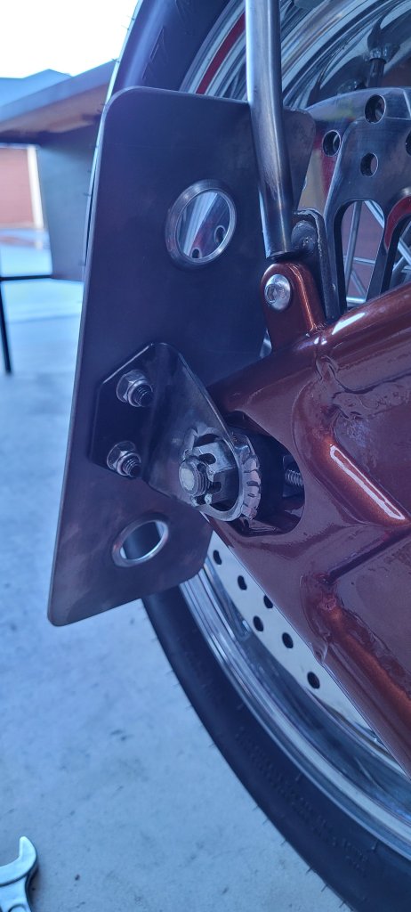

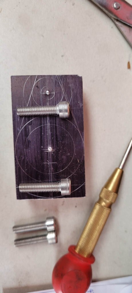

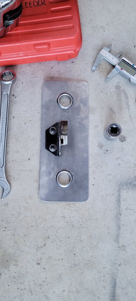

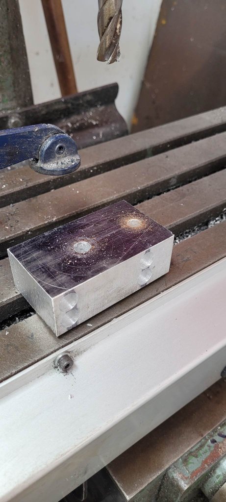

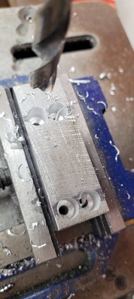

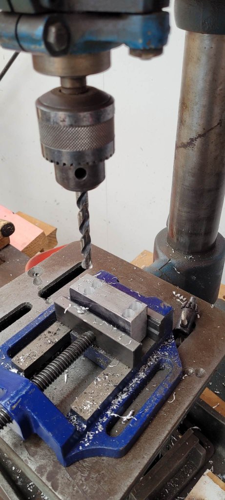

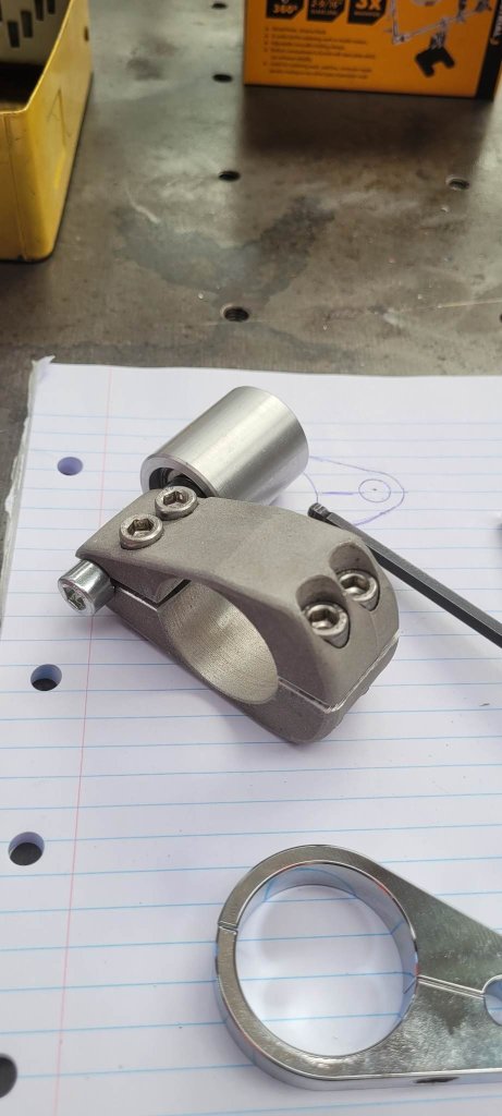

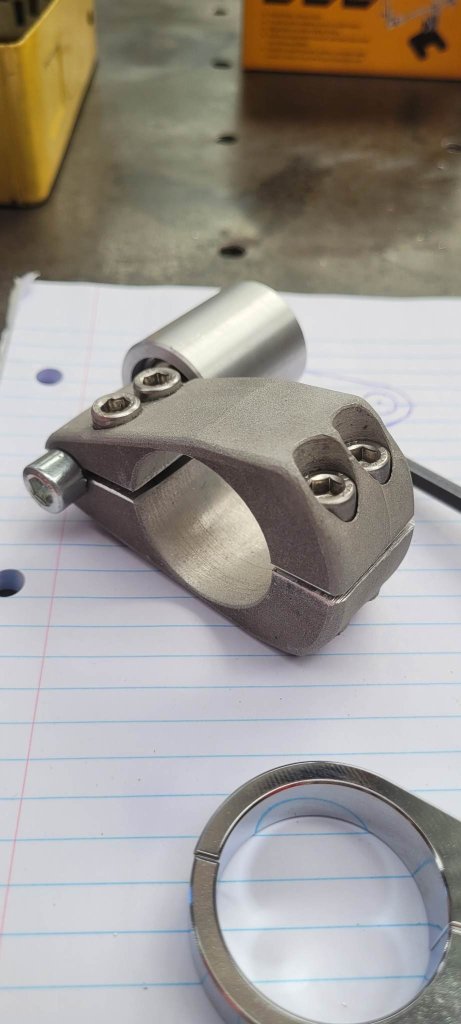

Number plate bracket, and axle block multi function part.
Without reliving it too much, a stupid amount of work went into this, probably 12 hours or more. The block, not very visible on the side has a lot of engineering time put into it. The bits you can see only took an hour or so.
Its a really complicated solution to a straightforward problem.
Hiding the wiring inside these aluminum channels I roll formed for the job. Once again, ridiculous amount of time and effort, but I think its worthwhile as it'll look pretty clean because of it.
The holes are all multipurpose, they hold things above, like struts, stop light etc...and the opposite side holds my aluminum channels for the wiring to hide in. Looks super clean.

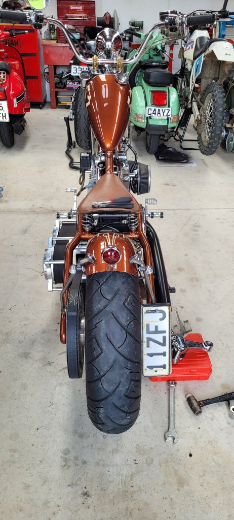

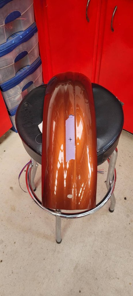

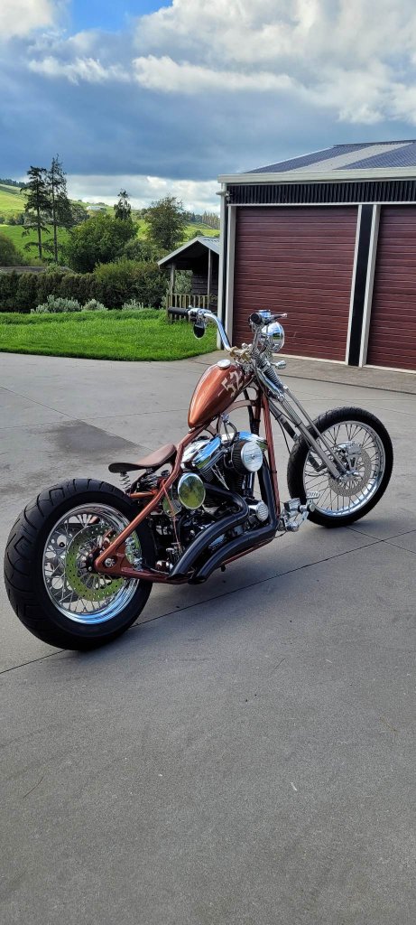

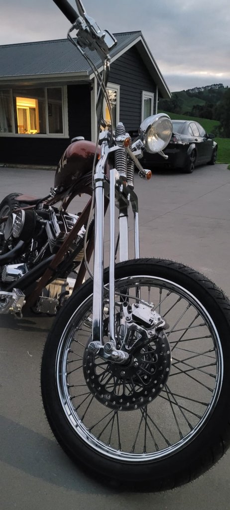

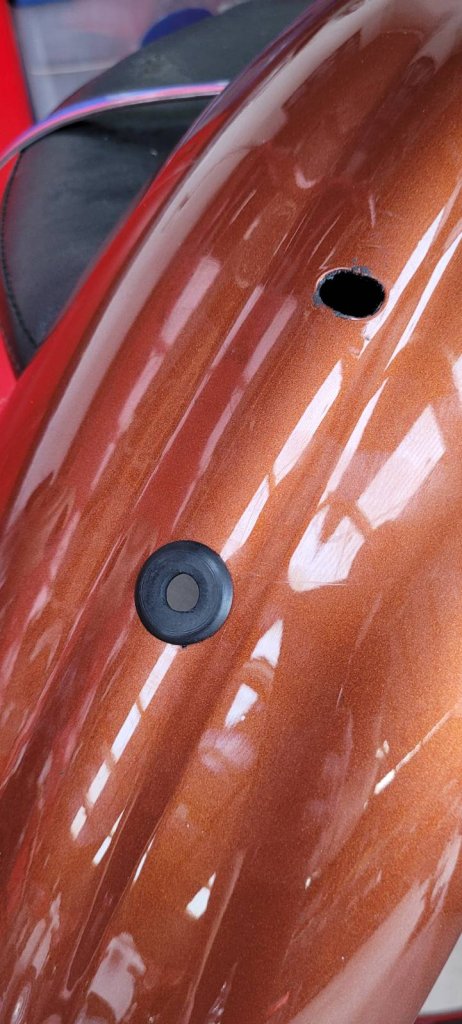

Fender struts back from chrome, so I was able to push on with mounting the rear fender and sorting out the wiring.
Its mocked up here, but I'll add connectors to the rear fender loom so its removable.

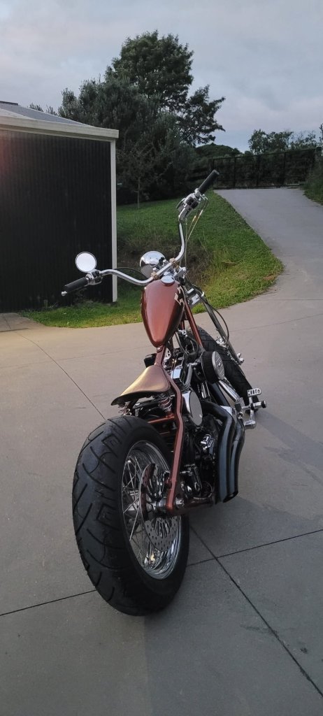

Pretty much the last stuff I needed to sort out. Time for cert, wof, reg...ride!!

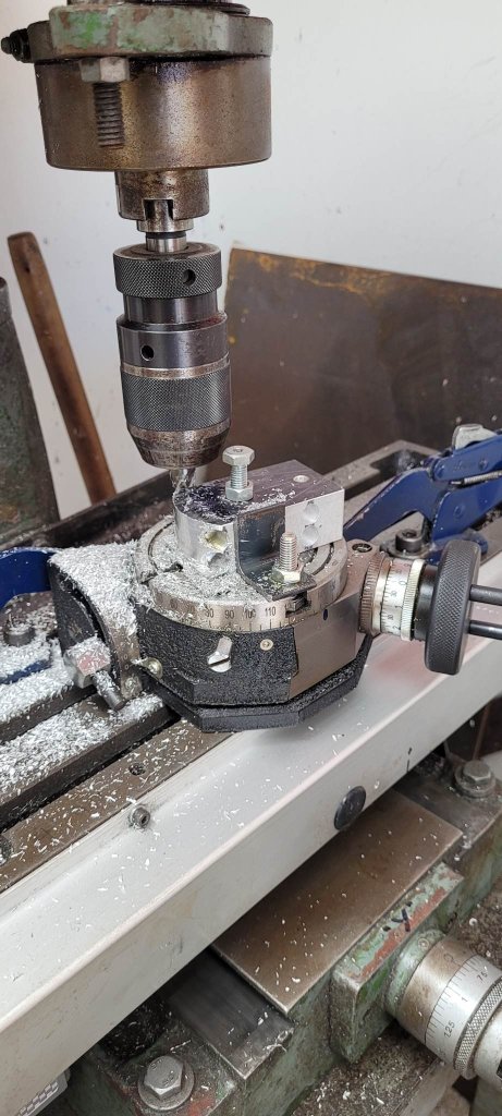

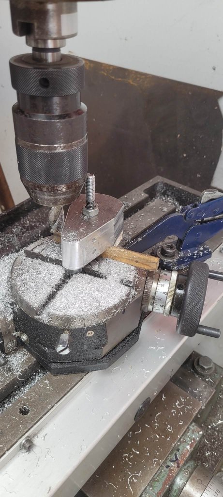

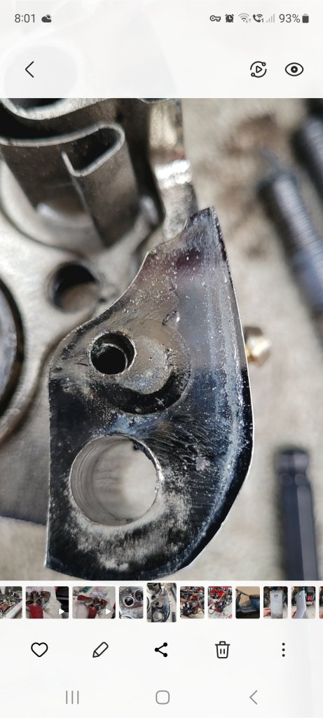

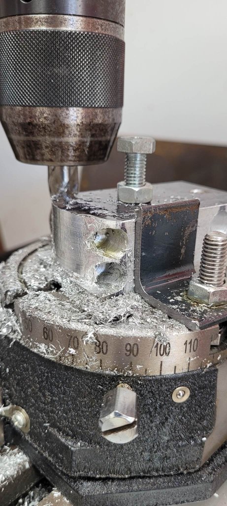

Hard to see, but that wet looking witness ring on the flat surface is an impression left behind by a rubber seal. The hole (not centred) is where brake fluid transfers from one side of the rear caliper to the other side.
Its a complete fuck up. Drilled incorrectly at the factory. Cunt must have been itching to get to his meth dealer on a Friday afternoon?
Anyway, I tried to machine out the defect and press in a new part drilled to offset the hole. It will probably work - but I then thought about how long I've been making this bike and the money I've put into it and decided another $500 is a drop in the bucket, so I ordered a new rear caliper from America. This time I'm going with a different brand and style (once bitten...twice shy).
Fingers crossed it fits, but worse case I'll make it fit by machining new brackets etc.
