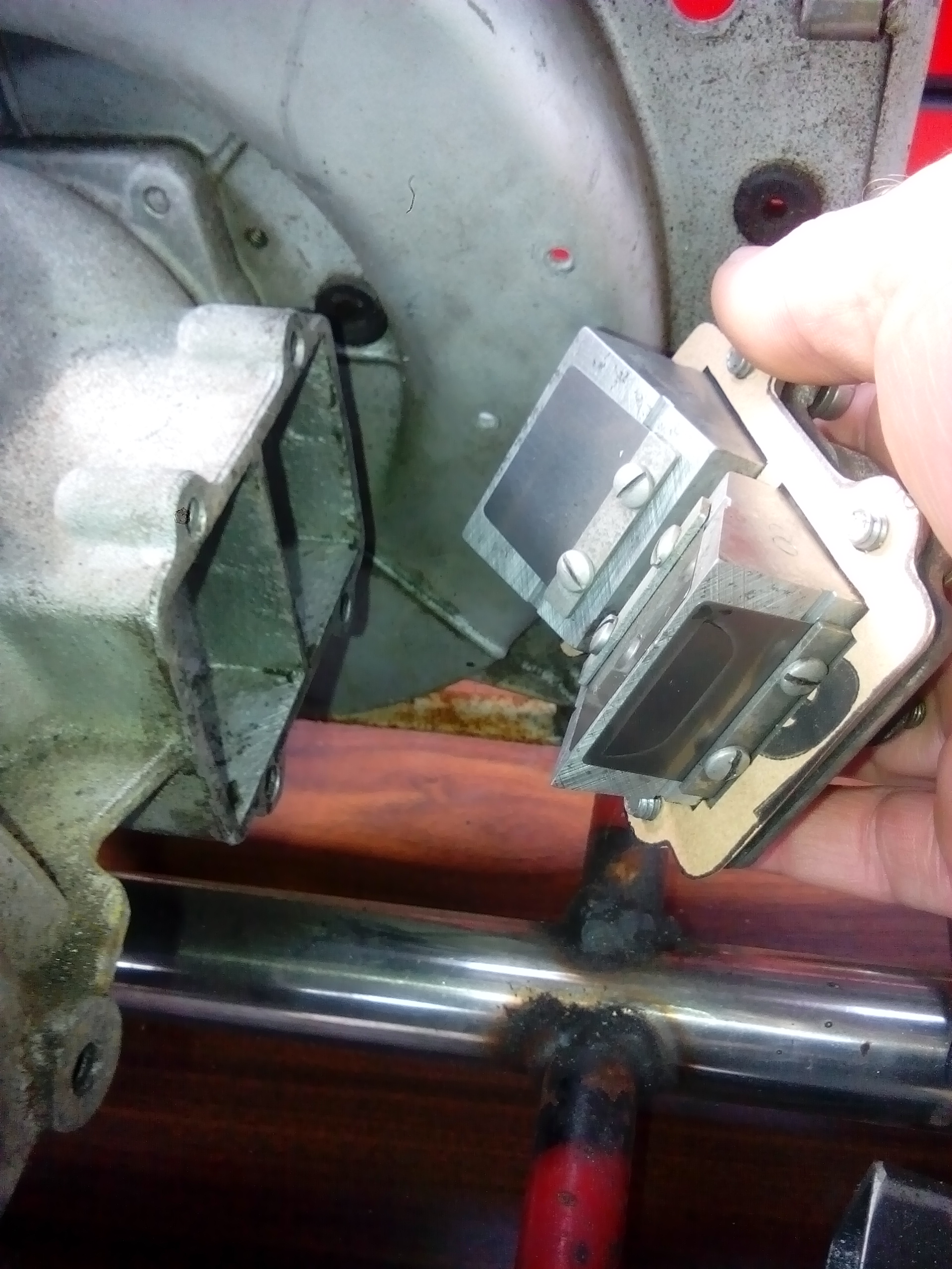

Got some questions about the carburetor. Pete thew in this carb; he never got around to installing it, but thought it would be a huge improvement over the original.
I've made new gaskets, fixed up the rusted out reed valves and found some rubber hose to connect the carburetor to the new intake.

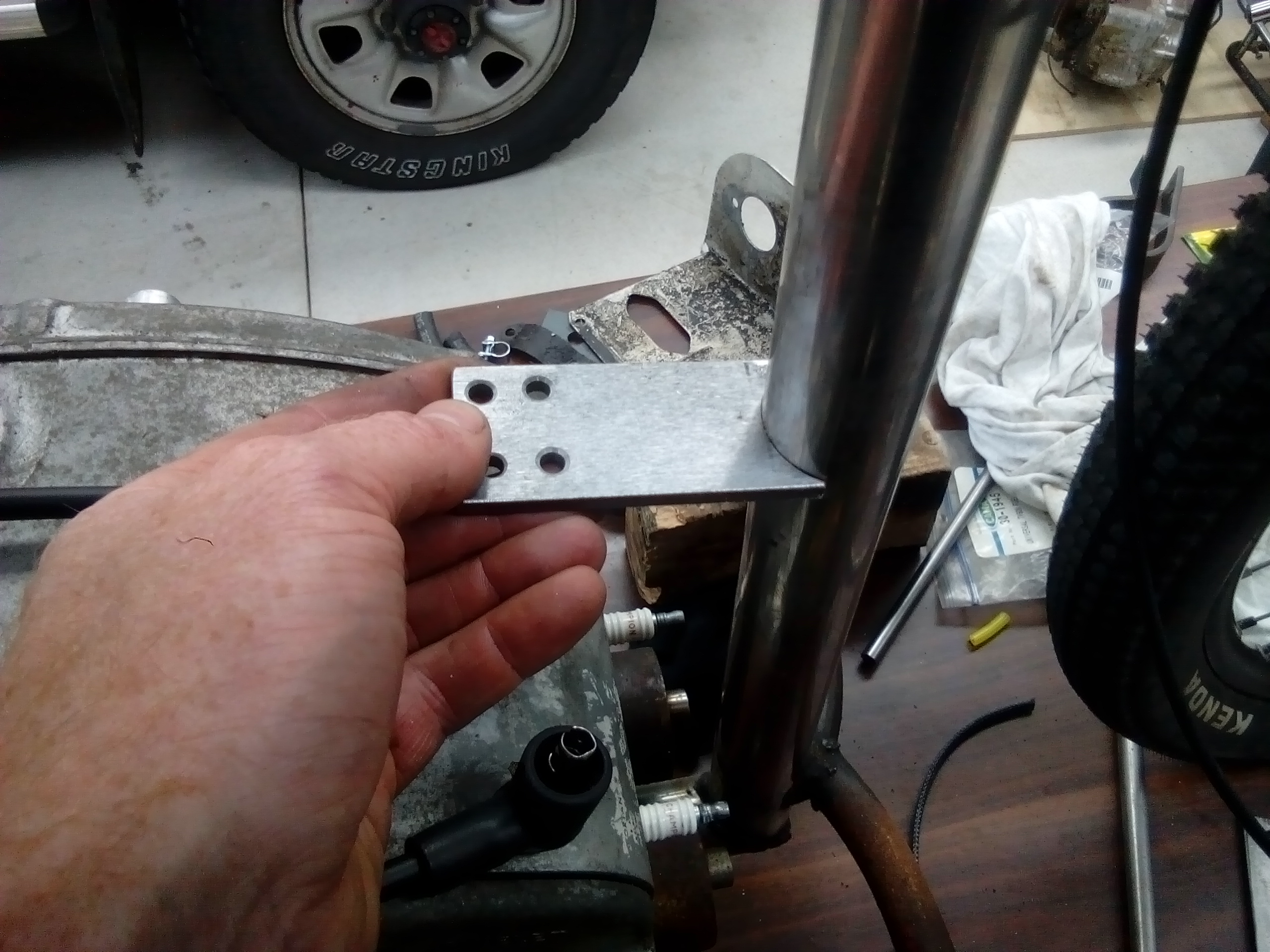

Overview from behind with new coils fitted. I figure there's no bonnet on a motorcycle; so if you've got to have it, you may as well make it a feature.
  • Like 9
Not a lot going on with this lately. Toying with this idea for a choke lever
And made this little fitting out of 4140 to hold the cvt to the motor.
It has an 8mm hole, with allows me to use a long UNF bolt to pick up on the crank. The key way takes the torque, this just stops it going west!
I made the fake oil tank in order to house a battery for the coils (I have to externally bypass the magneto).
Initially I thought undoing 4 bolts to swap would be fine, but it's a total pain in the arse!
Solution:
IMG_20170719_164052.thumb.jpg.853543585b3c4bd63071c05610c334e4.jpgIMG_20170720_110147.thumb.jpg.254a70e51bad84a5700c9268e0606137.jpg
