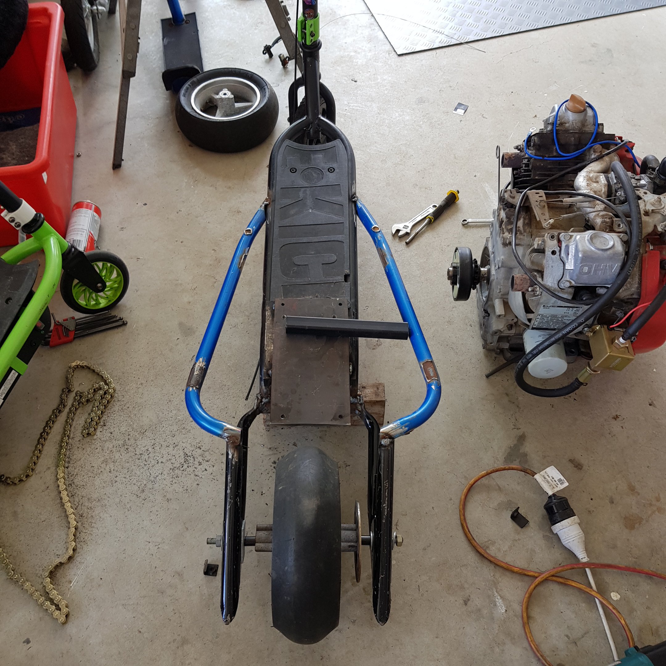

Muncie Posted December 30, 2017 Author Posted December 30, 2017 Some pics of the hidden stuff. That chunk of box section went between the tubes behind the motor. Deliberately kicks out on the right hand side to fit around the engine pull start had to go. Quote
