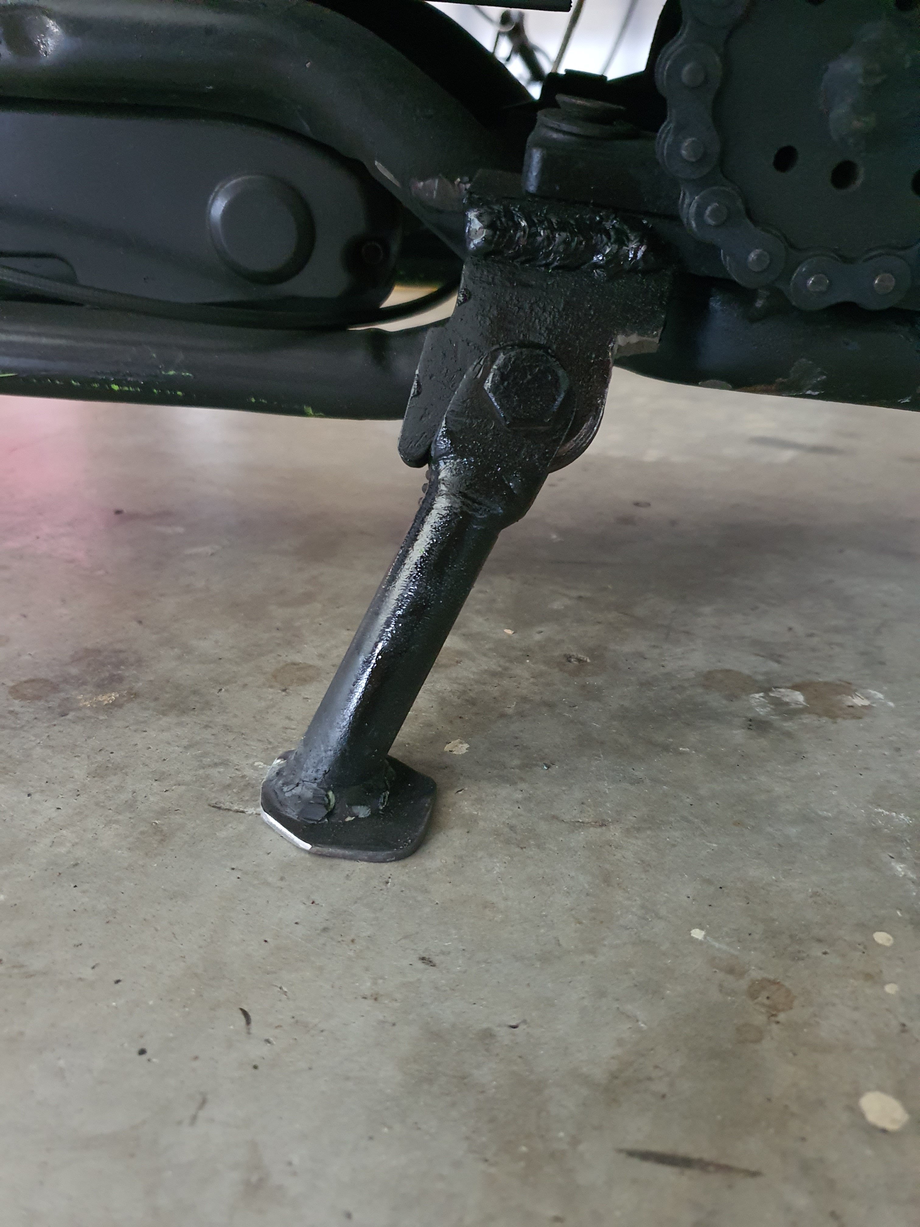

Muncie Posted December 19, 2020 Author Posted December 19, 2020 Revisions! The kickstand on this was a freebie from Kimjon thats served me well but was really undersized, at night ive heard it creak as it struggled to hold the engine up. I whipped this up from one i chopped off Truenotch's mini chopper frame i butchered its solid as fuck! And the scooter doesn't roll down hill when idling on hills (like my driveway) 2 Quote

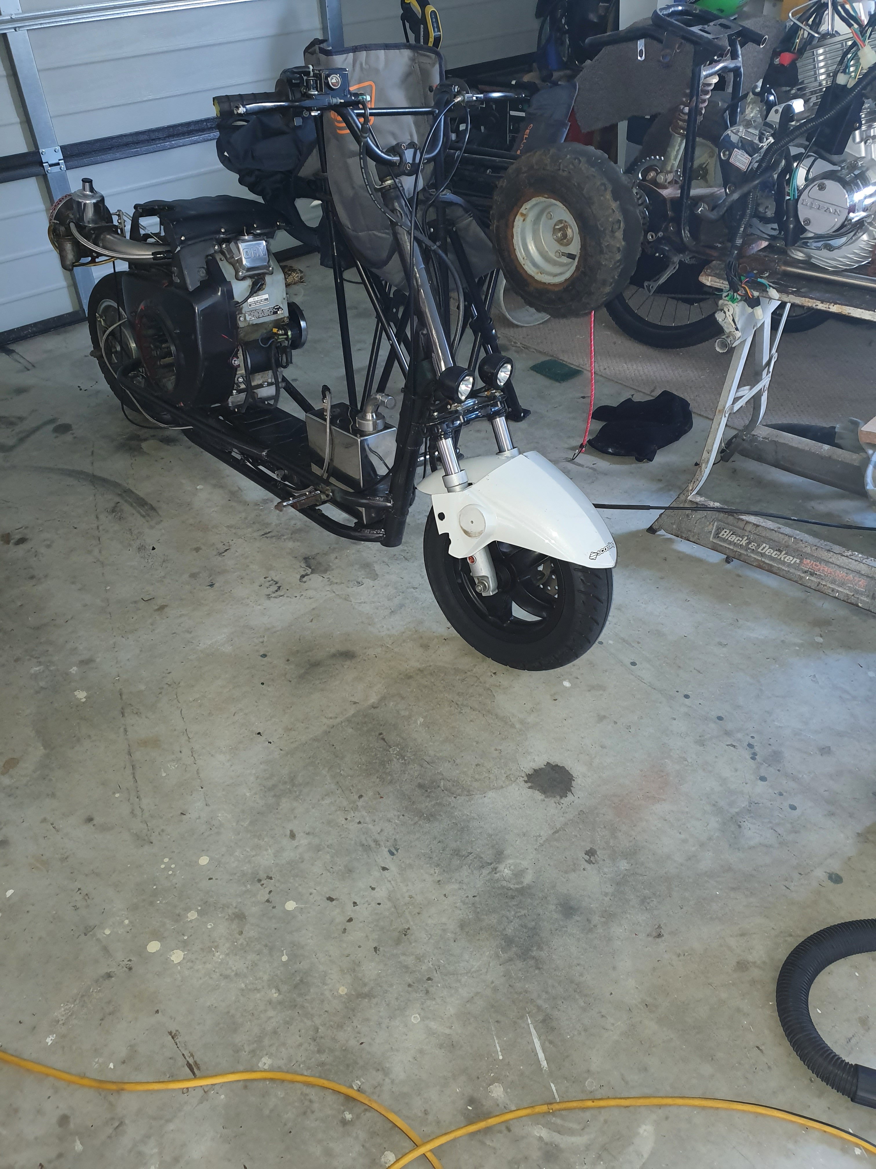

Muncie Posted February 28, 2021 Author Posted February 28, 2021 Found this front mudguard on side of motorway haha its a good fit in forks and over the wheel but theres not a whole lot to mount it too. Best thing i can come up with is to bolt some flat bar to the guard mounts and hose clamp to the forks..... more i think about the better it gets as easy and will have some give should it suck up a rock. Will need a guard over back wheel now too as ive got burnt rubber all up the back of my leather jacket and helmet. When engine was further back the back of engine caught it all. Quote
