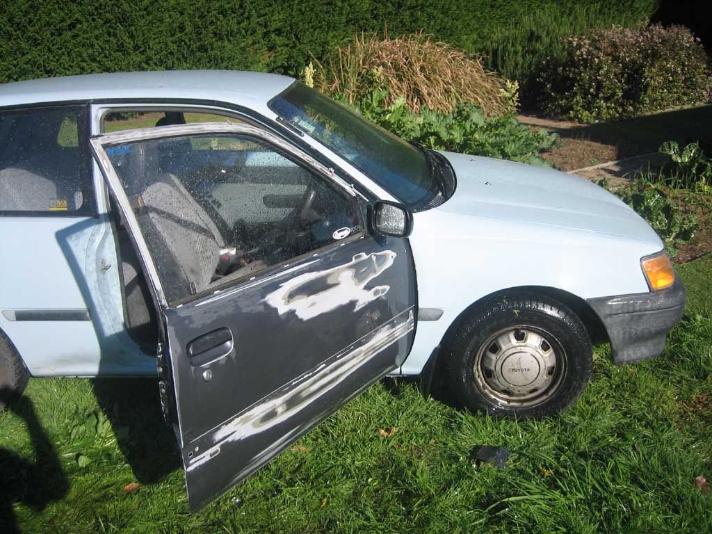

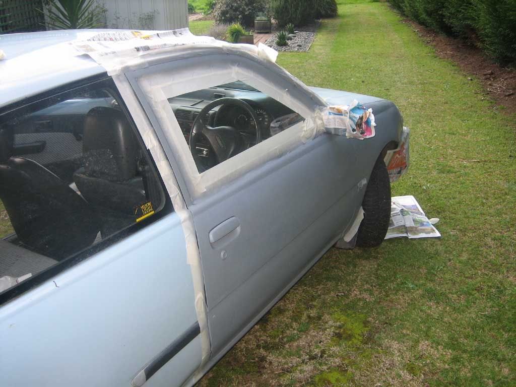

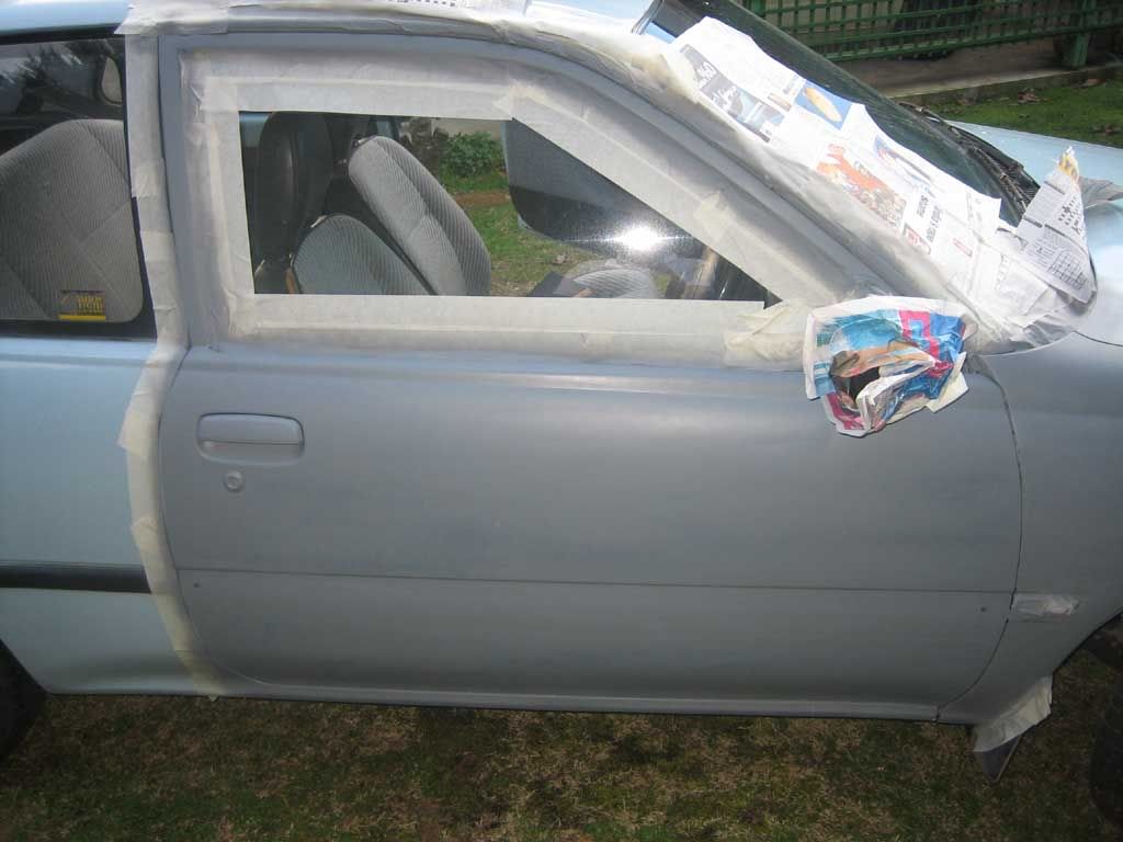

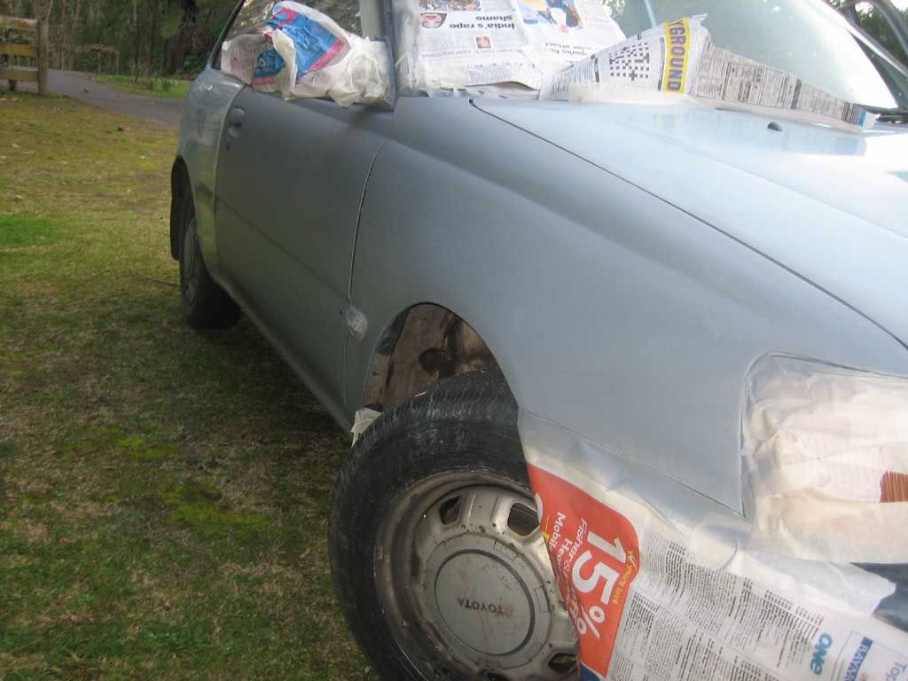

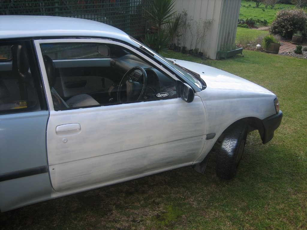

NewGuy Posted August 13, 2006 Report Share Posted August 13, 2006 Hey guys, This is my starlet i know its not old school etc. Im just tidying it up as i have been driving it around with a black door for a while now and i kinder want to sell it. Now over the weekend, i just sanded the door down and took some areas with scratchs right back to bare metal. Then i went over the whole door with 230 then primered, then i started on the front panel and a bit on the bonet which i didnt really plan on doing, so i am now gunna respray all 3 of these. The front panel has bog all the way threw it and is cracked in some places, i just wanna fix it the car up to sell on, so would sanding the cracks out with 80 grit just in the effected area, and filling them, and sanding them off etc be alright? i wanna try to the least amount of filling as possible. Ive been doing wet sands. I put a undercoat over the panels to stop rust and water getting into the bog. Also with the bonet, it has been flicked with paint before, would it just be a good idea to sand it down wet, with say 200grit till the top layer clear coat etc is gone? Then Primer it and 400 it with the door, and front driver panel Also, tips on how not to get pin holes with filler? Pics Quote Link to comment Share on other sites More sharing options...
cute wee gem Posted August 14, 2006 Report Share Posted August 14, 2006 First off for the cracks I personally would strip all the bog out then use a hammer n dolly to try an get it straight as possible then do a skim of bog on the whole dent area then block sand it back. Yes you can just sand the clear then prime over. To get rid of pin-holes in the bog try mixing the hardner/bog differently, try "fold" it rather than swirl it around Quote Link to comment Share on other sites More sharing options...
