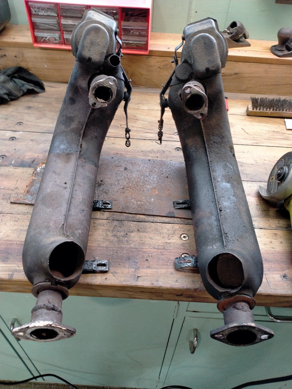

So on the vw started making a weird fluttering sound. I checked the basic things like oil and removed the fan belt to see if the fan was rubbing on the housing. Guessing it was a massive exhaust leak I finally admitted that I'll never have a working heater system, I went and bought these. Which replace these old shitters. Volkswagen heater boxes, which are air heat exchangers, the hot exhaust goes in those ports at the back, turn 180 under the heads and connects to rest of the system, whilst the engine fan pumps cold fresh air (hahahah) though the large holes over the alloy fins that incase the exhaust and into the cabin. Fair to say these things have done their dash and weigh about 5kgs each. Now factory vws have these annoying slip joints were the heater boxes attach to the muffler. As mine a bit low and the aftermarket exhaust flange is the first thing that hits the road pulling into a driveway (which can be seen in the last pic of the last post) it would crack the seal and would start leaking again. So I was able to reuse the flanges off the boxes and weld them in place thanks to my brother in law's weld as mine decided to die. Ugly welds but strong. So much better using gas! I told what I was doing and mentioned that the muffler was also on its last legs and he pulls this out from under his house. The openings are a little bigger as it's off his V8 prem, but the can looks to be exactly the same size as the bugpack muffler I have tucked up under the bugs fender. Next project sorted. Here is are J pipes in place. Please ignore the oil slick under the engine. So after fucking around all day, I start it up and bugger me if it was still making the fluttering sound! Me and Darrel spent a couple beers trying to suss what was making the noise, getting pretty gassed in the process, carbs need a tune, running very rich. So I go down the road to turn around, give it the old italian tune-up, and waa hey, problem solved! Still not sure what it was but I'll take the win.
