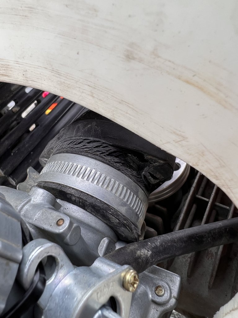

Yea I’ll enter tonight, was on the fence due to some family sickness. now I face a bike dilemma, today was the first chance I’ve had to do some prep, and the inlet to carb manifold on the trombone is crumbled, so it’s out, unless anyone has one handy they can bring to the start. my CT is fucked and in bits. Only running things in the shed are kids bikes and my drz400, so I might have to be a punishing medium bike barry if I’m still to come Soz -
