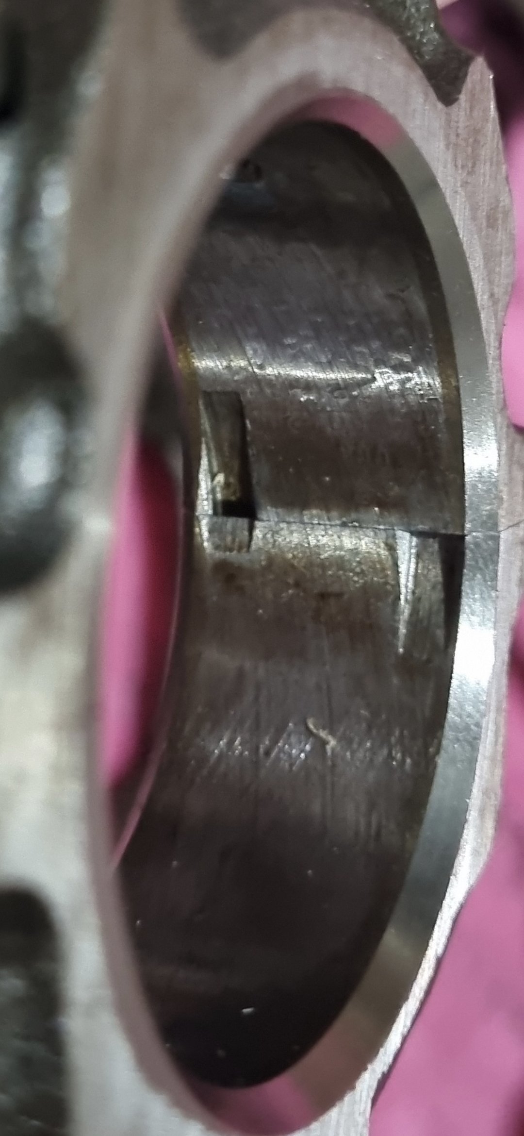

  3. 25/26 rods are the same, 20 has a smaller big end (48mm rather than 51mm), the crank mains are the same between them I am surprised they don't have an rb20 design tbh as they probably make the spool rb20 rods lol It seems the notches are more or less the same (just on a smaller dia big end) between rb20 and rb25 except for the small notch/relief on the left side of the bottom piece, it's more significant on the rb20 than on rb26 (which is barely perceptable) I wonder if it's even needed as the bearings themselves don't have a tang there
  4. These guys So I can get ok measurements with vernier but not perfect. Kind of wondering how perfect it needs to be so long as it seats the notches in the bearings
  5. So im most of the way there on ordering custom rods with max pee ding. They don't seem to keep the rb20 big end on file (weird) so I'm trying to find out tang size and position in big ends, can try measure but they're pretty small so not super sure on being accurate, would be easier/more accurate to find the specs somehow, any ideas from the brains trust?
