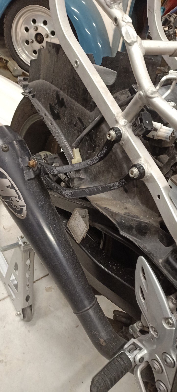

  12. Next up was the Exhaust hanger brackets which also hold the pillion pegs. These are cast aluminium, sculpted to suit the shape of the bike and they weigh 700g each! I love making carbon fibre stuff so I started really stretching my brain to figure out how on earth I could DIY produce something that is robust and aesthetically pleasing. These are made for MANY other bikes, but unfortunately not the busa. First I took some measurements, then I guessed the bulk of the profile and made a thing in fusion 360. Eventually I'd like @ThePog to mill some MDF molds for me, but before then I need to make sure I can actually draw the thing properly in F360. This is TOUGH and requires skills that I don't yet have. V1 was printed overnight by legend @Roman so I could test fit it the next day. you can see that the mounting locations are all correct but the legs of the support exit the fairing in a less than ideal location (it needs to come further out as well as further forward) one of my main problems is that I'm good at Draftsight but my licence has expired and I dont want to spend a few hundred on renewal so am struggling along.
  13. Also happening in parallel with the wheels is a weight loss plan involving nearly everything else. I bought some digital fish type scales and have my super accurate resin scales, so I started just pulling stuff off and finding lighter weight replacements. A list of weights so far is below- the Exhaust was done by the previous owner but the factory exhausts were included so I was able to weigh and compare. The most fun of these items was the rear subframe. This is an aluminum subframe as used during the first three years of Hayabusa manufacture and I bought it in from Norway (ebay). IT was bloody cheap, but after freight and conversion etc came out to around 190 NZD. There was one recently on trademe for $400, so thats a bargain. Its needed a huge amount of bracket trimming and cleaning up- I'm still not quite finished (have some threaded aluminum bosses being made for me which will need to be welded to the frame) but the comparison when you compare the weights is incredible. Being for a gen1 some of the fairing mounting bosses are in the wrong place- but there's enough in the right place to mean its not too big of a job to get the alignment correct- and the important things like rider seat retention loops are in the correct place. The other items were all very very easy- footpeg weights to lessen vibration, pillion pegs, etc etc. Also, strikes me as funny that they go through the trouble of using subframe mounting bolts which are drilled and relieved for weight reduction- when basically none of the other bolts on the bike are. Just seems futile considering the very minute savings. All in all, 16.3 KG is not bad so far! but lots more to go (lighter wheels etc will help, plus stuff covered below)
