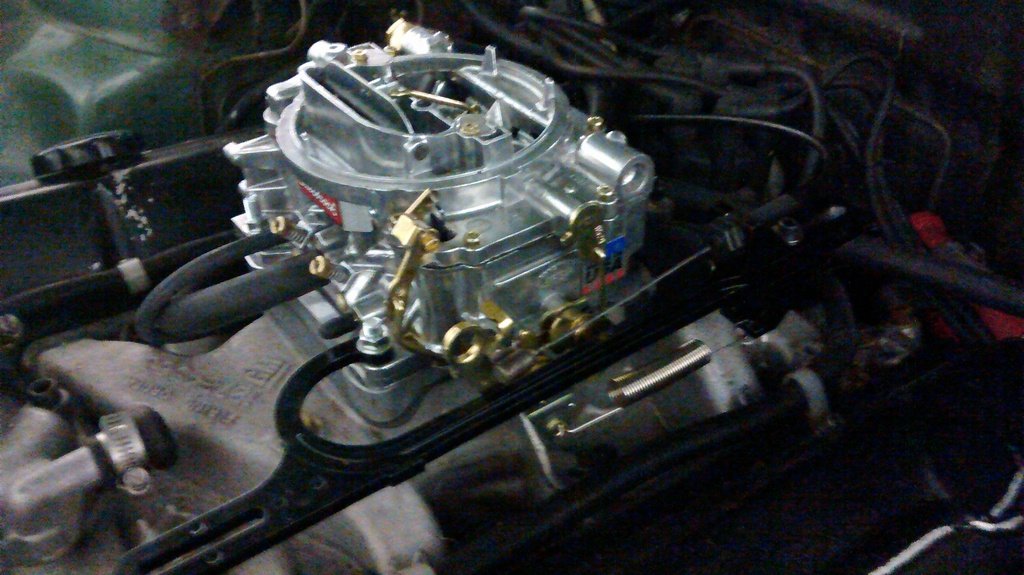

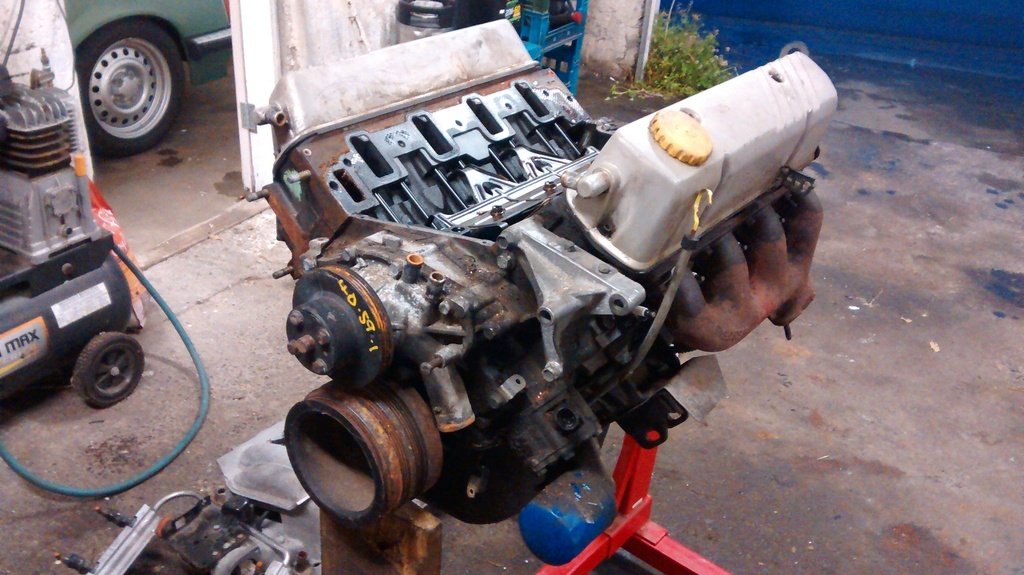

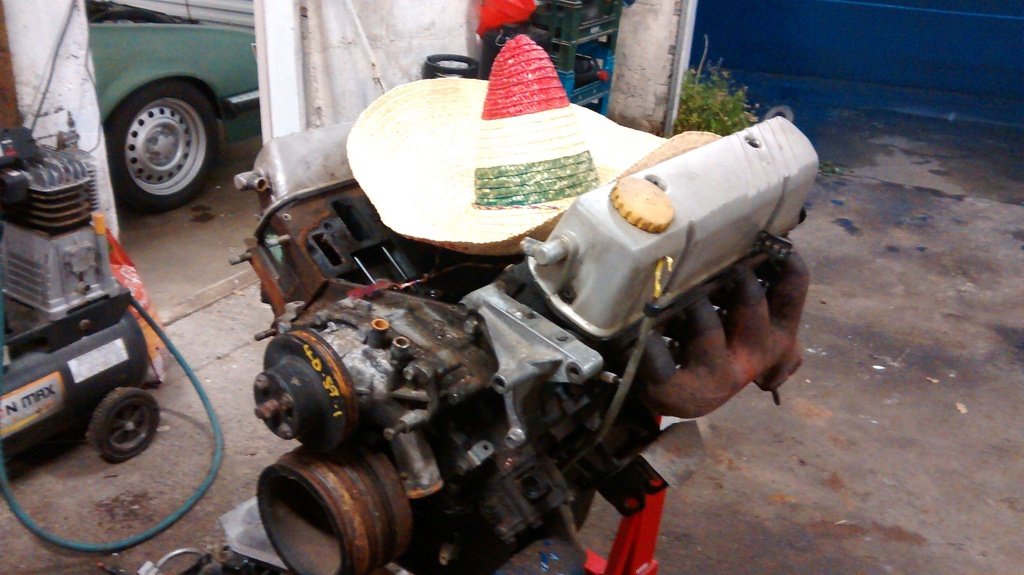

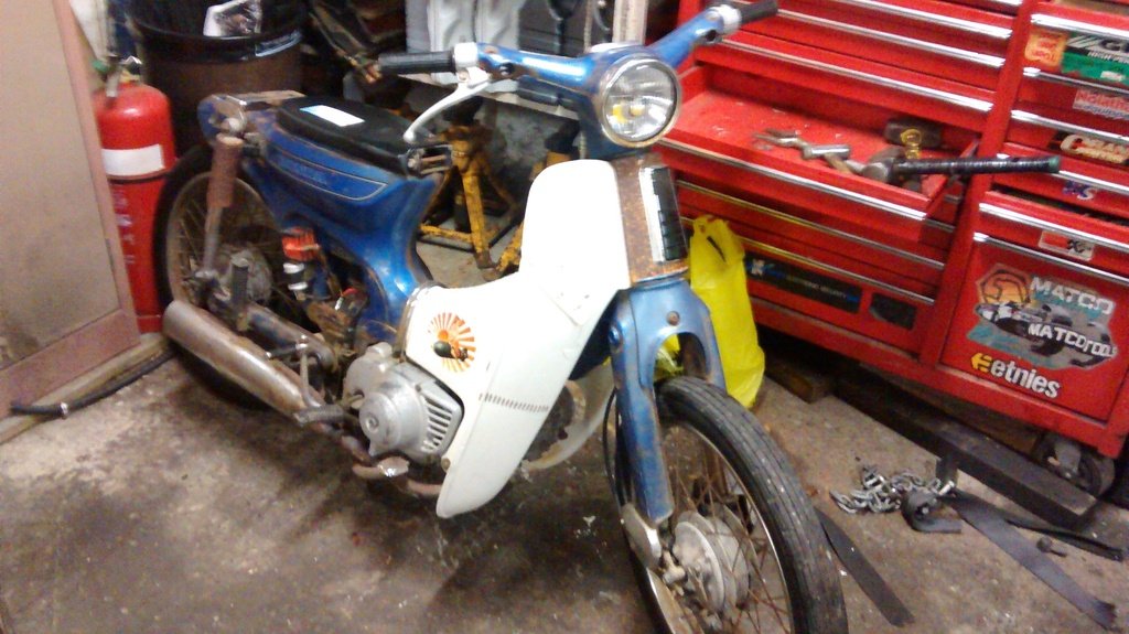

Tonight was a unexpectedly productive night now I look back on it. Was meant to just be meeting Joe and Seedy to unload my motor and chuck it on Beavers engine stand but a traffic accident on the motorway held them up. So I trudged on and cleared up a couple items I've been meaning to do for a few weeks but just haven't had time - even though I've had the bits on hand the whole time. First of all I fitted up a new spacer/adapter and throttle bracket to fix the twitchyness that I was experiencing - all to do with the angle of the throttle cable in relation to the pivot. (sorry for potato photos) I mounted the spring mount at the wrong end and upside down because it fouled the air filter in the correct place. Probably puts a bit too much strain on the spindle so may rethink this. (but probably will leave it cos I'm lazy) Then Joe and Seedy turned up and we unloaded my new motor. I wasn't going to do anything more than just jam it on the engine stand but Joe tricked me into taking off the wiring loom. ... and the inlet manifold so I could check if it had a roller cam - which it does. woooo. leaving me with this by the time I was done. I also scored myself a scooter tonight too.- 67 replies
