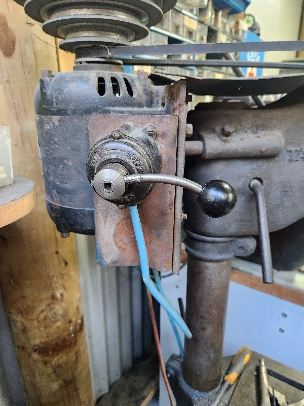

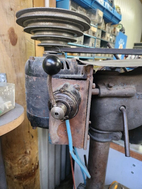

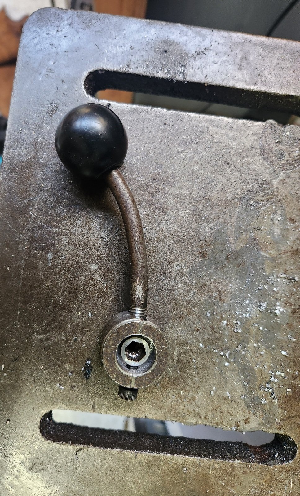

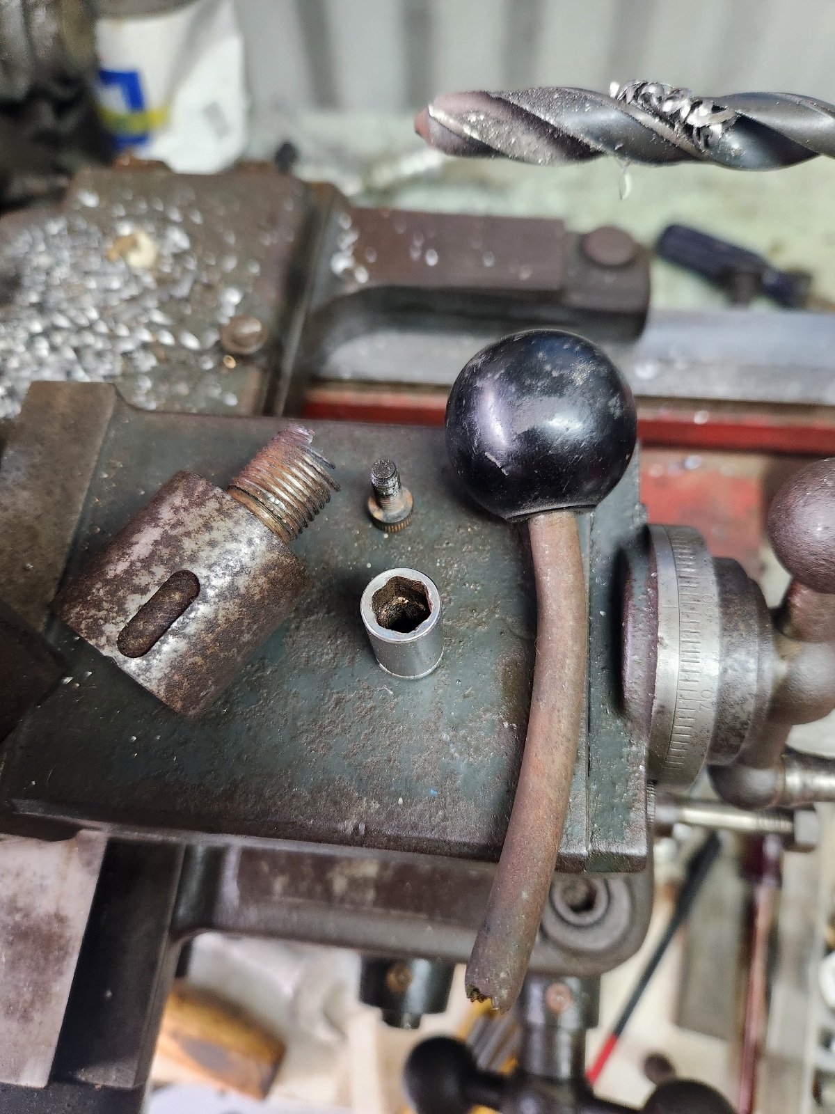

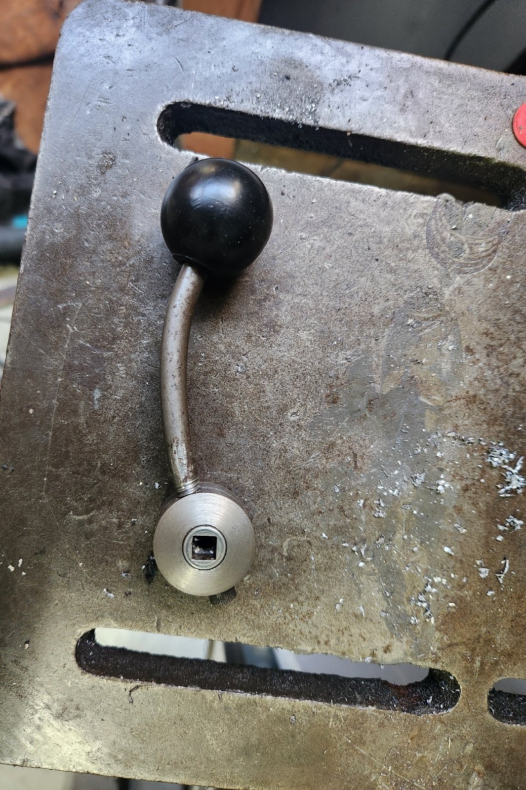

Old Tanner drill press hasnt had a propper on off switch the 6 years i have owned it. Where it is in the new shed is puts the unguarded belts exactly where the wall switch is. swept up some rubbish and picked out the good bits dunno what that bit of shaft was, but theres also an old 8mm socket and what i think is a broken myford handle/shaft 8mm because its a cast iron rotary type on off switch (But if you open it theres just a normal throw bakelite on off, which is funny) little ridge where the hex and body of the switch is, so made the handle fit over that, socket screw goes through the 8mm socket and holds onto one of the flats nice -
