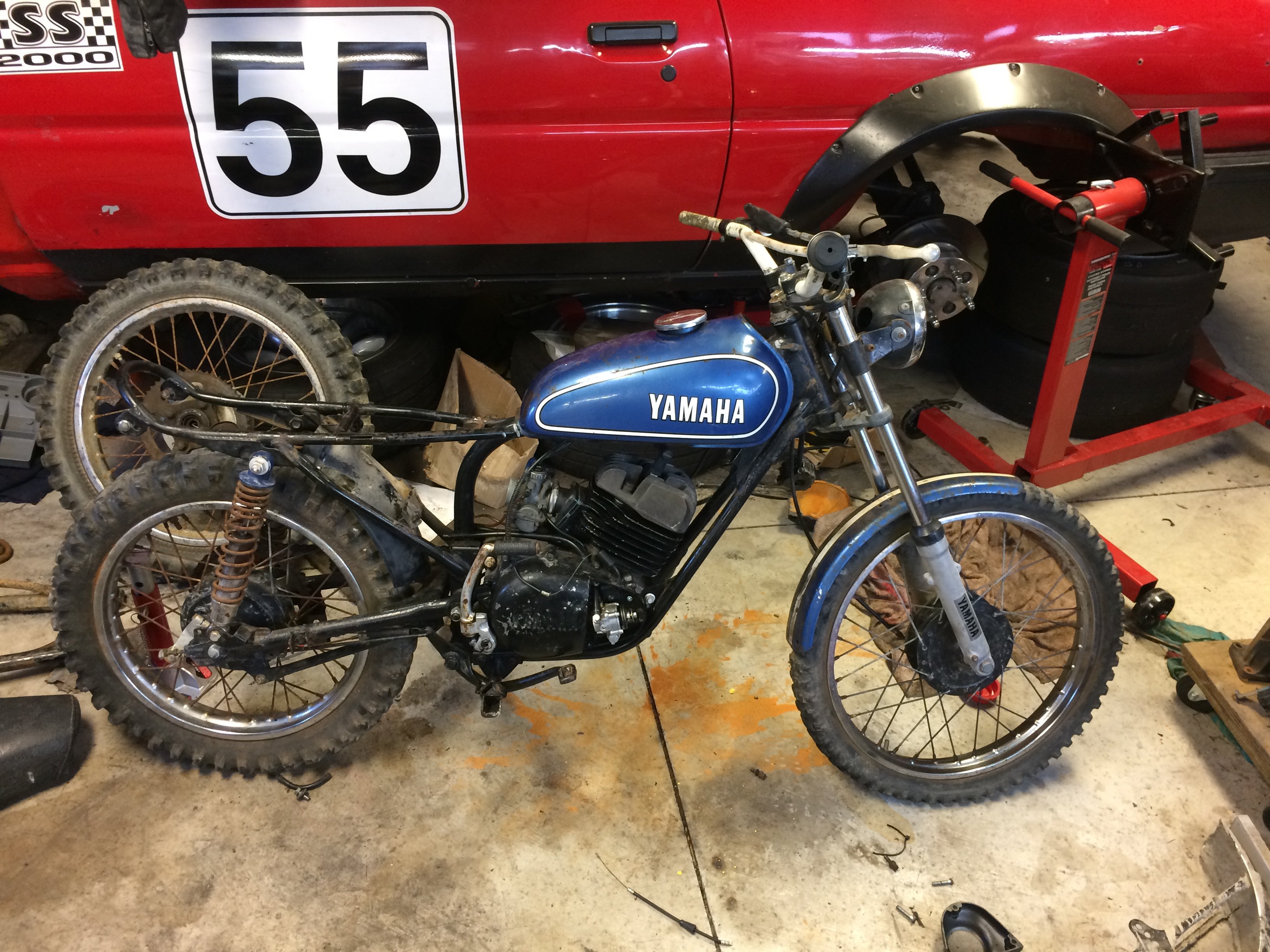

Haven’t made much progress with this lately, but have bought a couple of bits to help with inspiration. Picked up this spanny, most likely from a YZ125 apparently. Offered it up to the bike and it looks like it’ll work with a bit of fettling. Also found this tank and guard that are a bit more suited to the style I want: might need to shorten the tail of the bike a bit to get the proportions right as the tank is slightly shorter than the original, but I’m happy for now.
