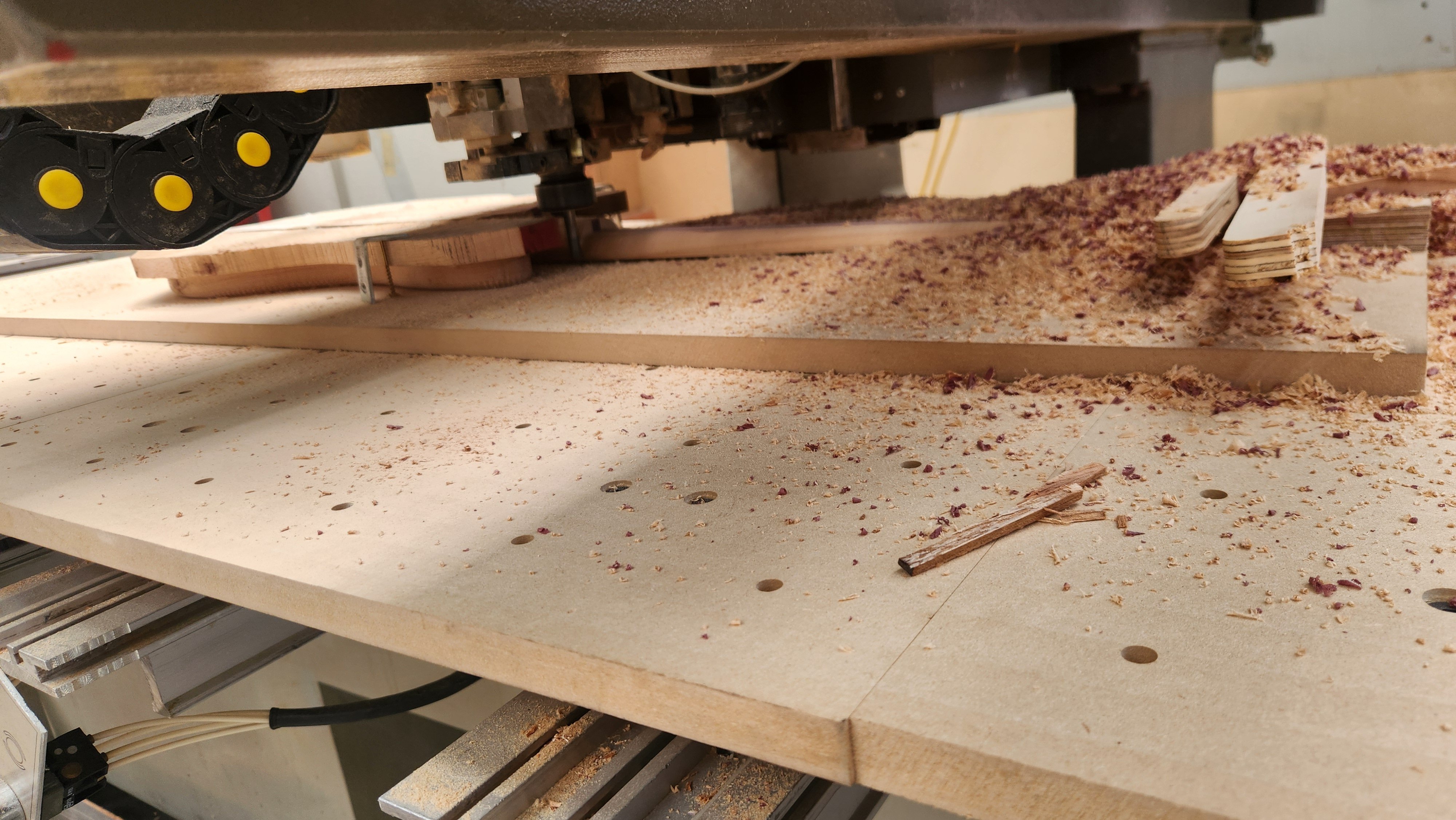

Popular Post BlownCorona Posted December 24, 2024 Author Popular Post Posted December 24, 2024 over the last couple of days @NickJ very generously operated his awesome and massive CNC router, aswell as handleing the programming for the cad model i put together for my Stingray. we first cut one out of MDF (which will now make cool shed art) and then set to attacking the hardwood. It looks incredible. i have no words to describe how happy i am with it, and without the help of others, this wouldn't be possible. 10 2 Quote

NickJ Posted December 24, 2024 Posted December 24, 2024 Was super fun to do, really sucks how work life kept kicking it down the order. Very glad we had the mdf one to check process on, that really took the stress off after all the effort that went into making the blank. This is by several orders of magnitude the coolest thing thats come off that machine, looking forward to the end result, no matter how long it takes to get there. 5 Quote
BlownCorona Posted December 24, 2024 Author Posted December 24, 2024 It actually won't take too long, the finish sanding is going alot quicker than I thought. The thought and effort that went into your jig paid dividends with only about a half mm offset between sides. With my automotive sanding block, taking the sides down flush isn't a big deal. I'm only sanding at 240 grit at the moment but already the grain and character of the various woods is coming out and holy hell it's going to look amazing when oiled. 8 Quote
