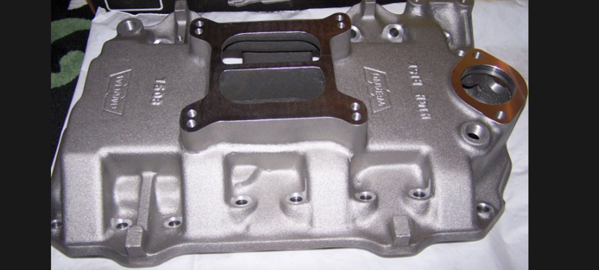

440bbm Posted October 28, 2024 Posted October 28, 2024 a nice dual plane manifold and 600 cfm quickfuel slayer carb be perfect for it! have u fucked with the ignition yet? cant remember, electronic pickup and blaster2 coil would be a sweet addition 2 Quote
doullama Posted October 30, 2024 Posted October 30, 2024 On 29/10/2024 at 10:00, 440bbm said: a nice dual plane manifold and 600 cfm quickfuel slayer carb be perfect for it! have u fucked with the ignition yet? cant remember, electronic pickup and blaster2 coil would be a sweet addition They're a tough engine to find aftermarket anything for, the only thing that interchanges from the 1967 on LA318 is the distributor. 2 barrel carter (200cfm!) was the povo spec so a factory 4 barrel manifold shouldn't be too hard to track down. There were twin 4 barrel manifolds too in the 50s but made of unobtanium. Nah not yet, I have a pertronix & coil on the shelf but I gave the dissy a birthday while waiting for it to arrive, running great so haven't felt the need to put them in yet. Quote
RUNAMUCK Posted October 30, 2024 Author Posted October 30, 2024 There was a factory dual quad manifold on the tard for months on end about 20 years ago. (Bit of a ling post, but there is at least one in NZ) Weiand also made a really really nice "high rise" 4bbl manifold too. Dad imported one in the mid 90s when he ran a poly engine in his VF hard top. I believe they're NLA. But if I find my old catalog, I could probably find the part number to aid in your search. I still remember the name of the guy we sold the engine to. (He had a few mopars) this manifold really brought the engine to life. I believe those manifolds are now quite sought after in the US too. Poly engines have a bit of a cult following. (But when engine doesn't have weirdos who love them?) 1 Quote
RUNAMUCK Posted October 30, 2024 Author Posted October 30, 2024 Google says it's a Weiand 7503. One of them will transform you car. 1 Quote
440bbm Posted October 30, 2024 Posted October 30, 2024 Give Gavin @ mopower performance a call and see if he has anything about for one. Don't know how much 318 stuff he has but used to be a super helpful guy over the phone. 1 Quote
440bbm Posted October 30, 2024 Posted October 30, 2024 20 minutes ago, RUNAMUCK said: Google says it's a Weiand 7503. One of them will transform you car. will that clear the hood though? 1 Quote
RUNAMUCK Posted October 30, 2024 Author Posted October 30, 2024 I would say yes. It fitted in a VF valiant. You've gotta have much more clearance being a C body. They're not a high rise like a tunnel ram. 1 Quote
