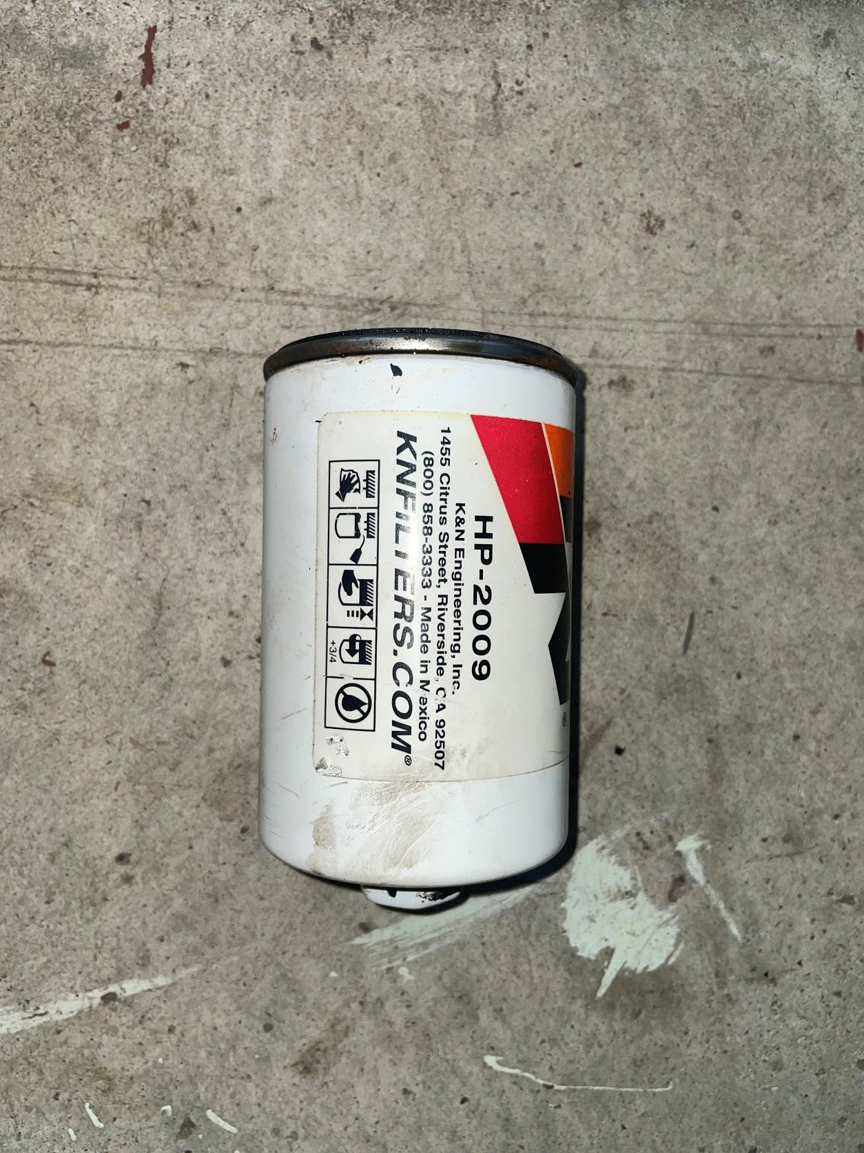

Tiger Tamer Posted January 27, 2023 Posted January 27, 2023 I thought I would give the Tiger an oil change since the oil is getting dirty and I always change the filter as well. It doesn't get used that often so it's been a couple of years since the last change. I drained the oil and removed the old filter and no oil came out, it was bone dry and as clean as new, so it has never had oil passing through it. For some reason the filter is being bypassed. It has good oil pressure, so I don't think it has caused any damage. I am getting a sickening feeling that there maybe something wrong with the pump as I suppose there is some sort of bypass in it. Any thoughts welcome. 1 1 Quote

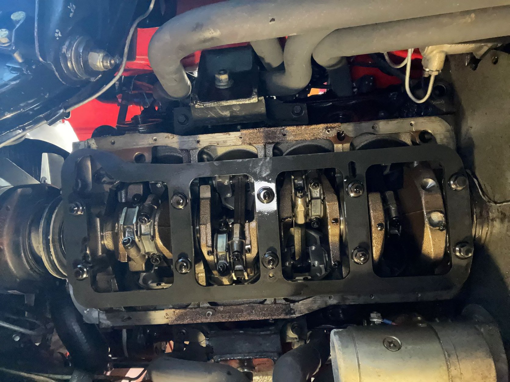

Tiger Tamer Posted January 28, 2023 Author Posted January 28, 2023 I dropped the sump and pulled the pump and the pressure relief valve seems to be fine. It's all very clean and the spring is fine so I think it's OK. Luckily it is a easy job to remove the sump as there is nothing in the way. I used a high torque starter which is smaller so I didn't have to remove it either. Which is all good because most things are a battle to work on with limited space. Maybe it was just a bum filter. I am sure Beer will help. 3 Quote
cletus Posted January 28, 2023 Posted January 28, 2023 https://www.boefab.com/blogs/tech/72880067-k-n-hp-2009-filter-comparison Interesting,i wonder if the fact they are a restriction means the pump couldnt overcome the valve/left a big bubble of air for the duration that filter has been fitted? Is this engine in a sunbeam alpine/tiger? 2 Quote
Tiger Tamer Posted January 28, 2023 Author Posted January 28, 2023 15 minutes ago, tortron said: Maybe a fake k&n? You think by buying a good brand you would be safe but they are probably just relabel of someone else's they work with. Quote

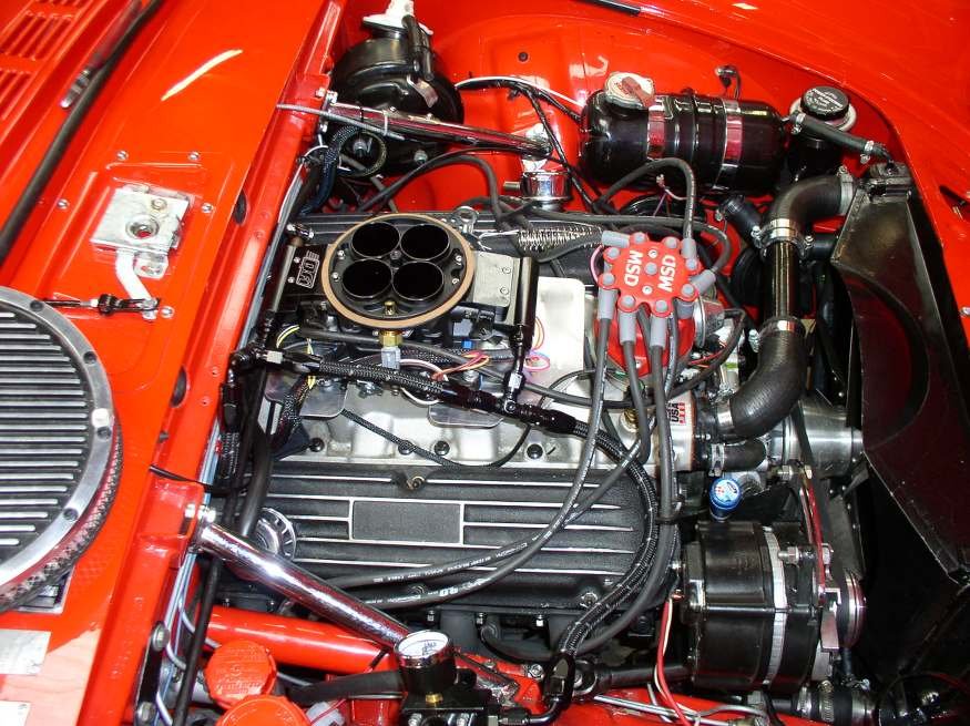

Popular Post Tiger Tamer Posted January 28, 2023 Author Popular Post Posted January 28, 2023 3 minutes ago, cletus said: https://www.boefab.com/blogs/tech/72880067-k-n-hp-2009-filter-comparison Interesting,i wonder if the fact they are a restriction means the pump couldnt overcome the valve/left a big bubble of air for the duration that filter has been fitted? Is this engine in a sunbeam alpine/tiger? Thats what I am thinking. Perhaps I could send it back to the manufacturer or supplier and see if i can get an answer. Yes the car is a Sunbeam Tiger. Originally it had a 260 but the original engine had been replaced with a earlier 260 out of a Fairlane and had low oil pressure. Being all SBF made it reasonably easy to fit the 5.0L. Gearbox is the original close ratio top loader. Diff original as well. 13 2 Quote

Tiger Tamer Posted January 28, 2023 Author Posted January 28, 2023 Thanks for the link Cletus, now I see the problem. Quote
Nominal Posted January 28, 2023 Posted January 28, 2023 TBH I wouldn't use a K&N oil filter on anything. /lingpost 3 Quote
Popular Post Tiger Tamer Posted January 29, 2023 Author Popular Post Posted January 29, 2023 I took the K&N back to Repco where I had bought it from over 2 years ago and they are going to contact K&N to see what they have to say or offer. They did have a NAPA gold filter the same dia etc which is what I need as a full size filter won't fit. They didn't charge me for the new filter even after all that time so thumbs up to Repco. I fitted the pump and picked up the sump only to see the pump drive rod still sitting in the sump , so removed the pump and refitted it with the shaft and fitted the sump. Filled it up with oil and took note of the level on the dipstick, fired it up and rechecked the level. It had dropped so I figured it had gone into the filter. Topped it up and took it for a short drive. Filter is nice and hot so it must be full of oil. 13 Quote
