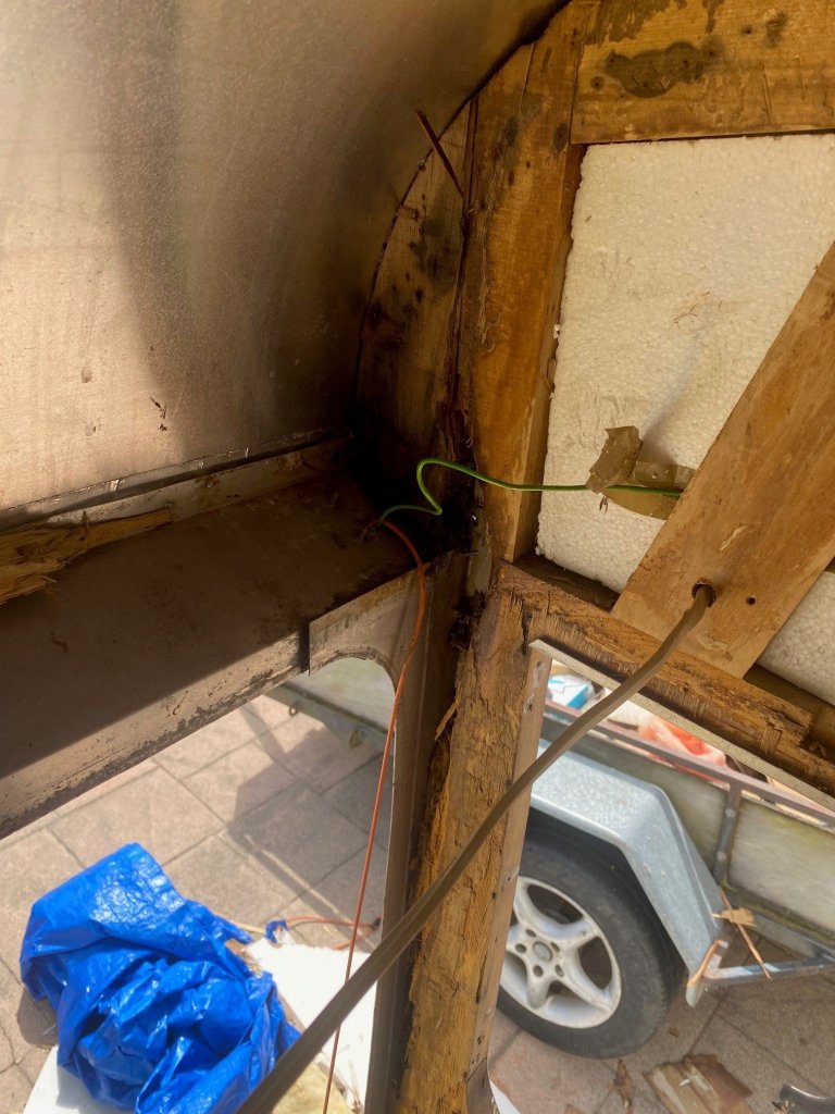

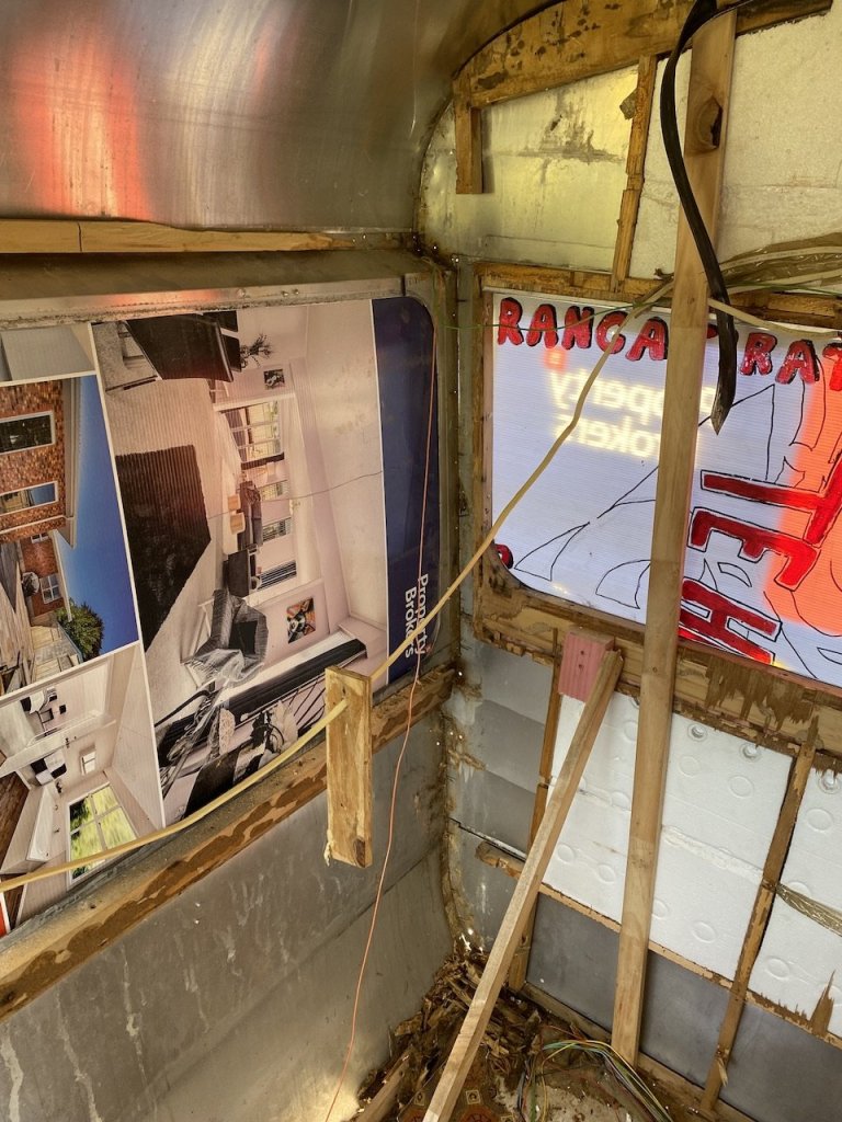

The whole right hand corner is completely rotten, both lower corners have detached, and the front panel has detached.
Genuinely, the bed frames were the ONLY thing holding the entire front of the caravan together. Once I lifted the beds out, I noticed that when I was walking around, the entire front wall of the caravan was moving side to side relative to the floor.
So I'm in for a major here... eek.

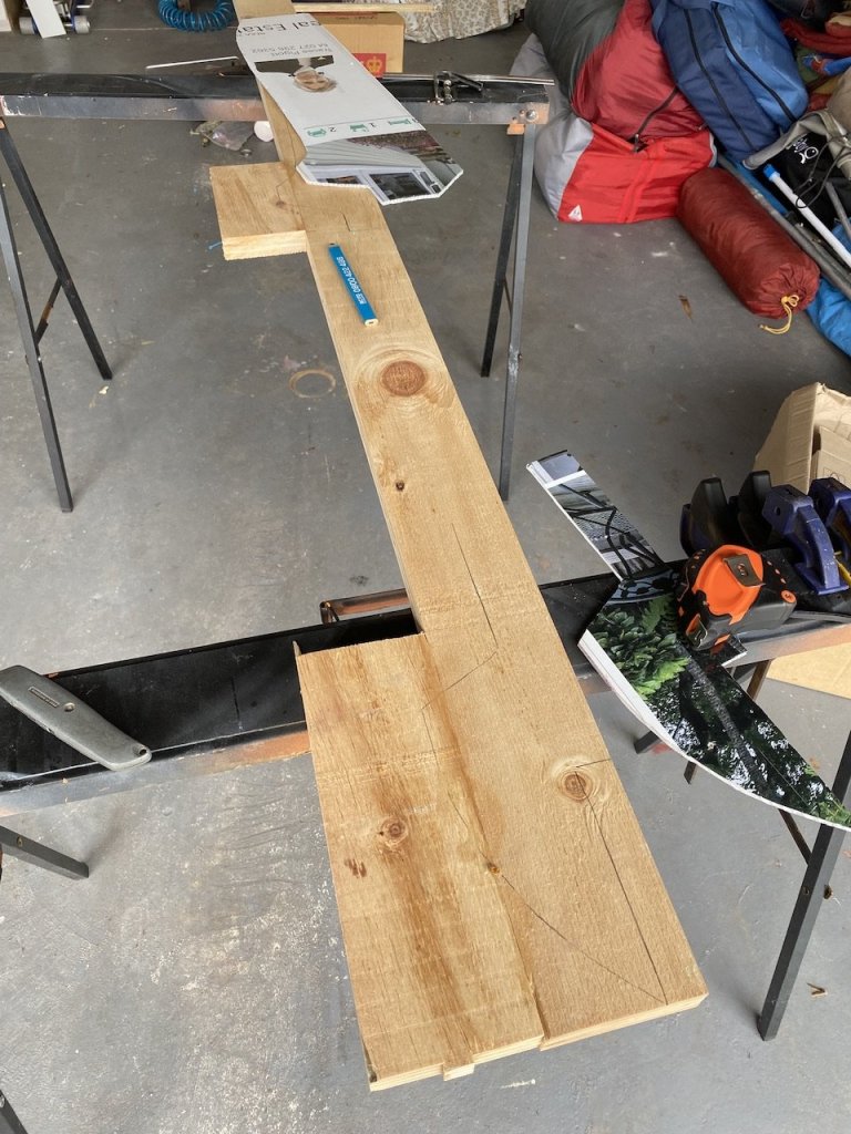

Any clever ideas for framing timber?
It needs to be un-treated to avoid reacting with the aluminium.
Its 30mm thick. I'm tossing up laminating some dressed pine to get to 30mm or cutting what I need out of 30mm UT ply.
Thoughts?
Thoughts?
Either ply, or shop around for some dressed macro?
what about that structural ply stuff, J ply.  its  stong asf and lighter than anything else you'll get which is handy. not sure if its available untreated..   or is this the stuff you are thinking of anyway
Just went to buy that sheet and he had boards of it 110x30x2.7m for $4 each. So I got 6 of those instead of spending a fortune on a sheet I can’t lift. Winning.

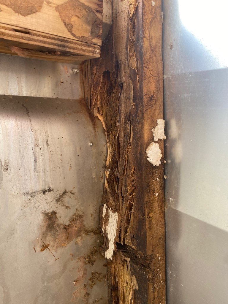

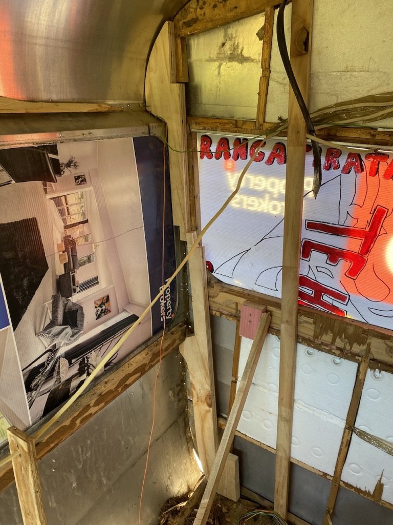

Today I managed to get the new corner post templated, laminated and cut out. Also managed to get the rotten old piece out.
Im glad it was so rotten, it would have been a real ball ache if half it was decent timber on account of all the little tack nails holding the aluminium in the corner.
Just need to massage the shape slightly to get the fit right and then glue/screw it in.
  • Like 7

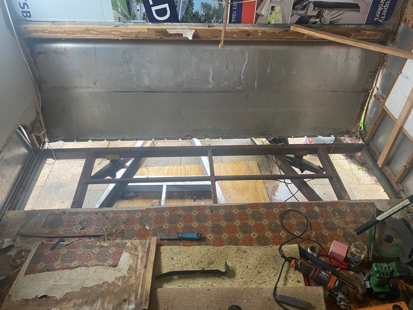

So today I got out there and cut out the floor.
Then I jacked it up high to get ready for replacing the drawbar. I jacked the front up with the jockey wheel and put axle stands under the front of the chassis. I already had some stands under the back, but thought I would jack it up a little higher in the bum. Stuck the Jack under it, and it flexed the whole bloody thing so much that one of the semi-detached front corners let go and the whole fucking then felt like it was going to collapse. This thing is so terrifying to work on, I have to think so hard at every step whether what I'm about to do will make it cave in.
In positive news, there is no rust in the chassis.
