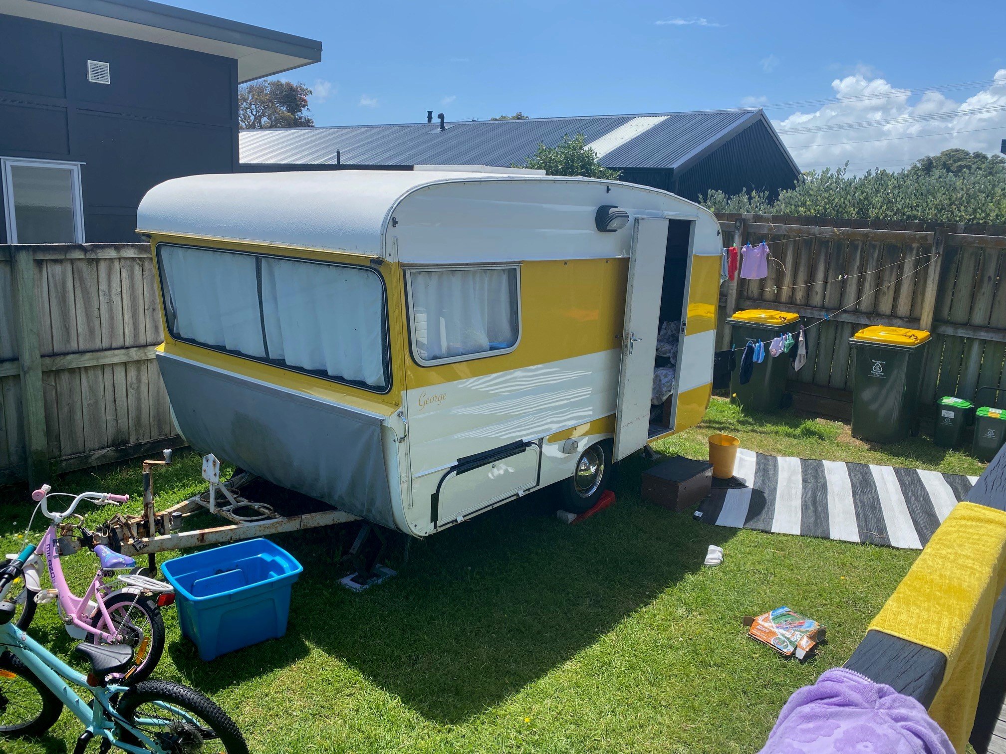

anglia4 Posted September 30, 2022 Author Posted September 30, 2022 There wasn't much needed to be done to get him ready for our first adventure. The little hatch in the side where the awning gets stowed fell to bits on the gloriously bumpy piece of tarmac labelled State Highway 3. That resulted in a garage sale of wheel chocks and shit down 800 odd meters of the highway out of Whanganui. Fun. So I rebuilt the hatch from a solid piece of Aluminium rather than sandwiched hardboard as the original was. No more drama there. I had to go around the bodywork and add a bunch of extra screws where the edges of the Aluminium were starting to lift. Beyond that, he passed his WOF and we were away. This was almost exactly a year ago, so we booked our first trip. We wanted to go somewhere within a ~3 hour radius from New Plymouth so we could pack up and come home if it wasn't going well. A spot at Raglan was secured for labour weekend 2021. https://www.rnz.co.nz/national/programmes/morningreport/audio/2018814892/covid-19-raglan-wakes-to-alert-level-3 Well fuck. So we started to phone camp sites going south and ended up scoring the last powered site available at Himatangi Beach just out of Foxton. Probably a cancellation from some poor bugger in the Waikato. 6 Quote

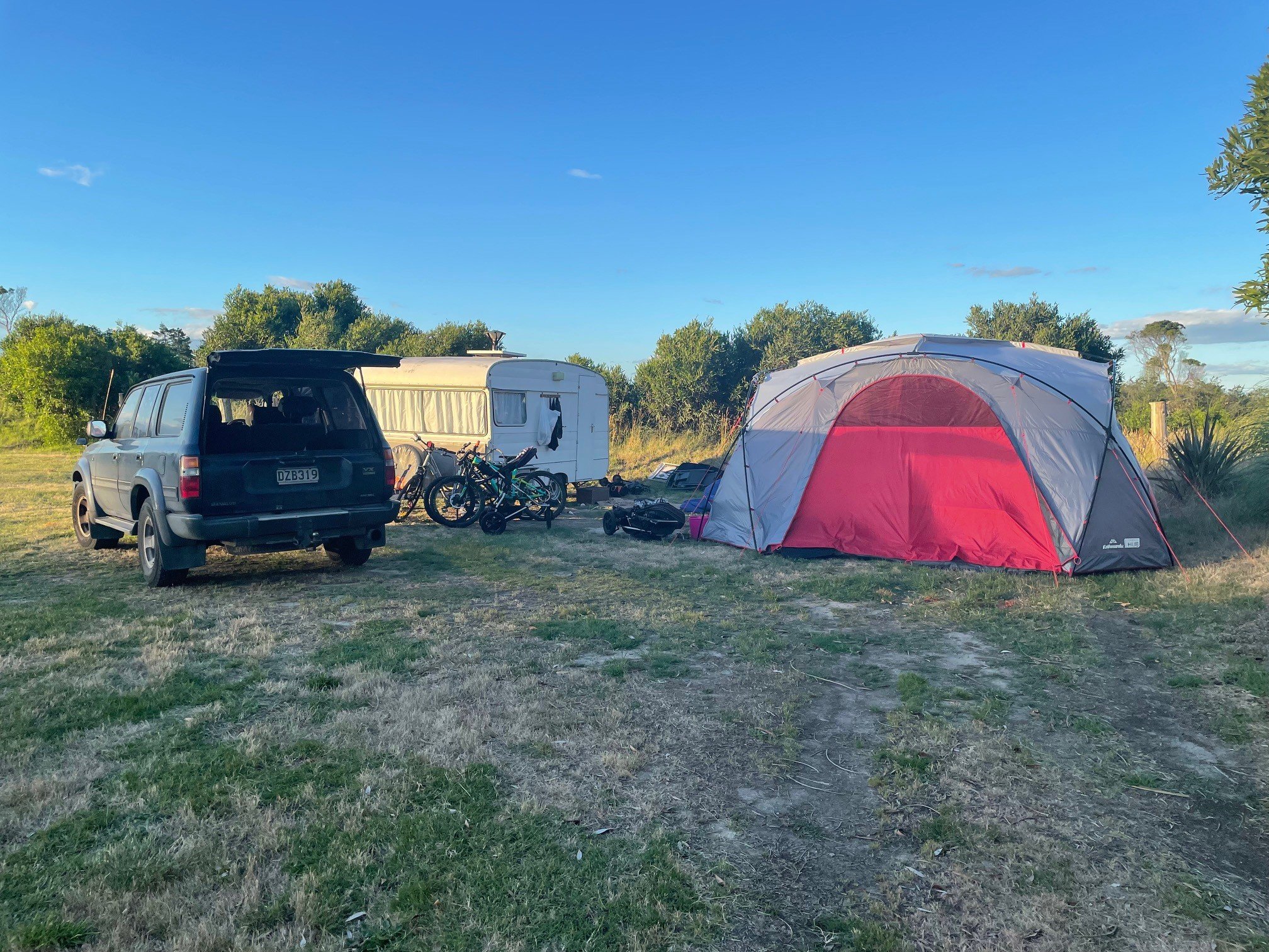

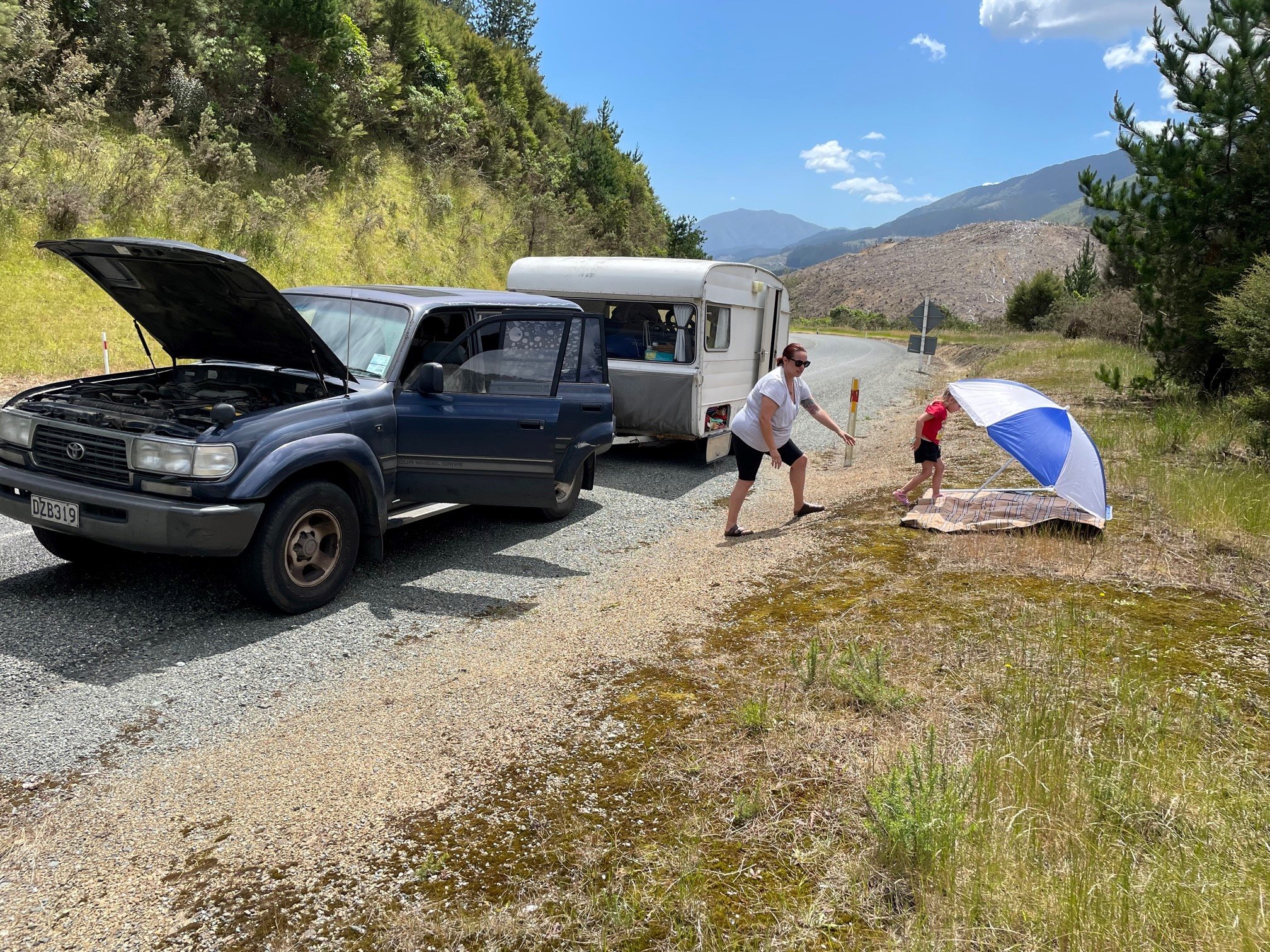

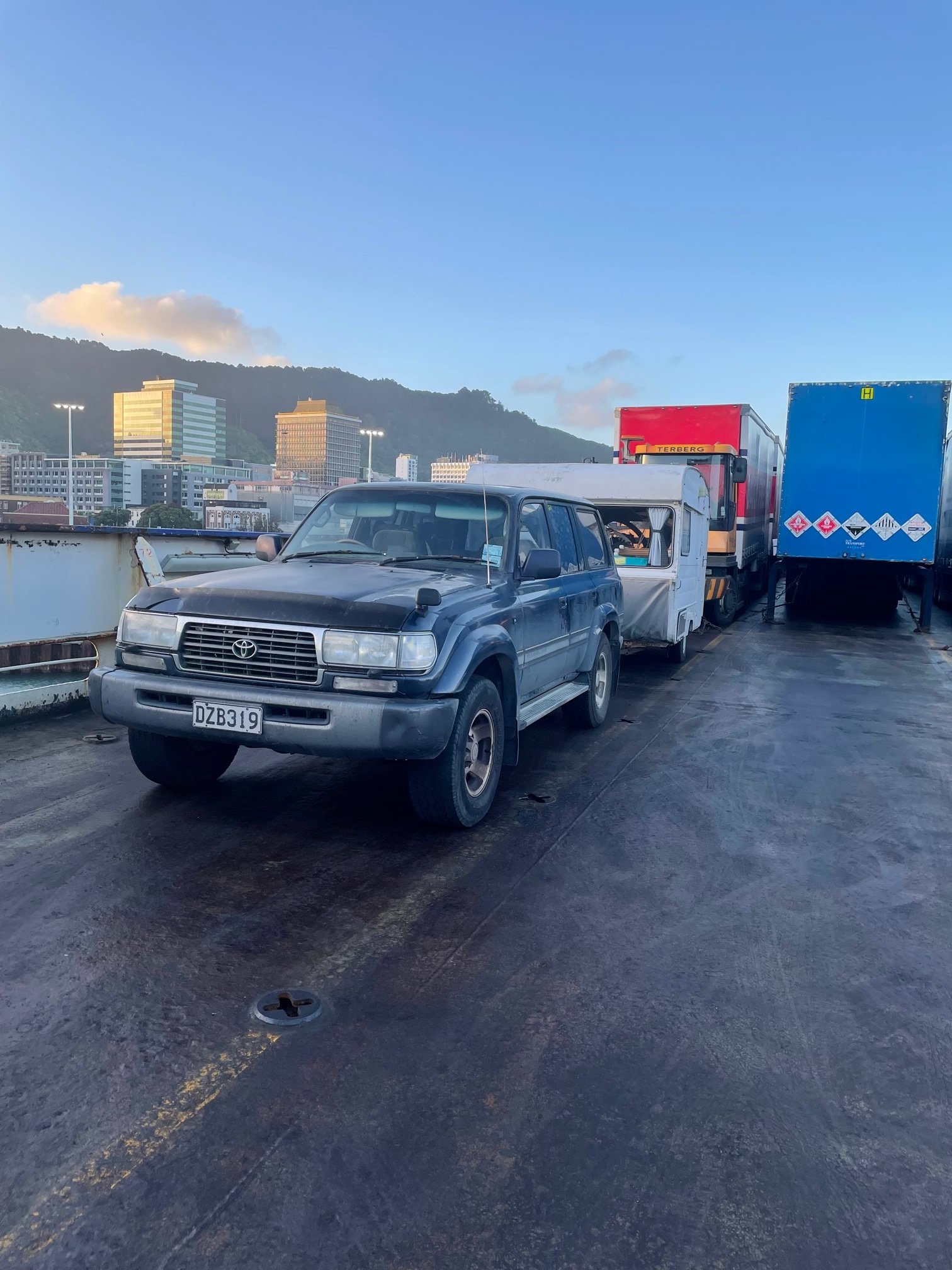

Popular Post anglia4 Posted September 30, 2022 Author Popular Post Posted September 30, 2022 The next big trip was to Nelson. We have family down there, so had booked in nearly 2 weeks at the Mapua Leisure Park. This was always going to be a BIG trip. All loaded up and ready to head to the ferry, the caravan had heaps of gear in it, I had made some roof rack mounts and got the bikes up on the roof of the jeep. We were off. We got to Hawera, just an hour into our journey to the ferry and decided to stop and grab a coffee from the service station. Pulled away, the jeep loaded up, started to move, and then the revs flared up with no drive. Not good. I rang my dad, who was very luckily on his way home from work nearby, in his VX Landcruiser. So we hitched George onto the Landcruiser, threw the bikes in the caravan, changed over the car seats etc. left dad on the side of the road with a dead Jeep and got on our way again. We rang the ferry to let them know we were now running late, they told us the ferry was also running late due to weather, but that if we didn't make it, we were unlikely to get another crossing for days as this was just before xmas. Stressful! By the time we got to the ferry, we were quite late, and the ferry had got back on schedule. We had been on the phone to them multiple times on the trip down, letting them know what our ETA was. They let us on-board, as they were expecting us, and then turned away the people who had pulled in behind us. It was the biggest feeling of relief I've ever had. God it towed awful behind the Landcruiser. I had to stop a couple of times to shift some weight forward, but never got it right. In the end we decided it was because the tow-bar was too high and that was unsettling it. Now the Landcruiser has always been the most reliable old workhorse, so we were fairly comfortable with it... But such was the luck we had on this trip, that the Landcruiser decided it wasn't quite up to it either... Looking on the brightside, it was a beautiful day for a roadside picnic on the Whangamoas while we waited for it to cool down. Eventually we made it to our camp site and again had an awesome holiday. We spread out into our gazebo a bit more for this trip just because of the duration. George is just the right size for us along with the gazebo for mum and dad to hang out in after the kids have gone to bed. The trip home was very gentle. We took the Whangamoas at about 20km/h with the heater on full, all the windows and the sun-roof open. 21km/h or turning the heater off would start the temp needle climbing again, but we made it. Dad has since overhauled the cooling system on the old truck and its back to pulling the big loads. Meanwhile the Jeep lived up to its name of Just Empty Every Pocket, and required a transmission rebuild from top to bottom. It was eye-wateringly expensive, but supposedly now it will be stronger than when it was new. I definitely find I don't like to give it the whole 500Nm when I'm towing any more. This whole thing is not something I want to re-live. 13 Quote

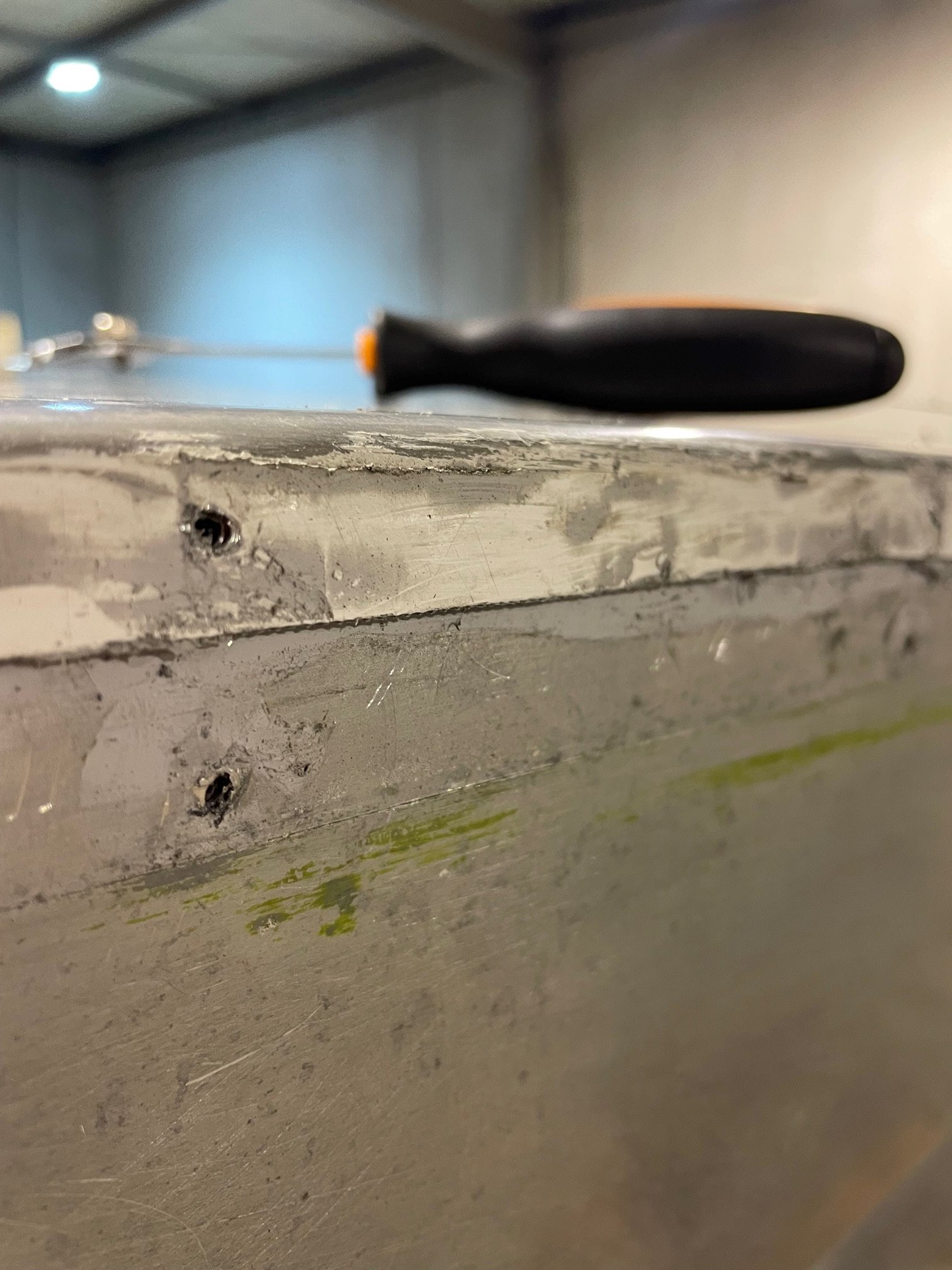

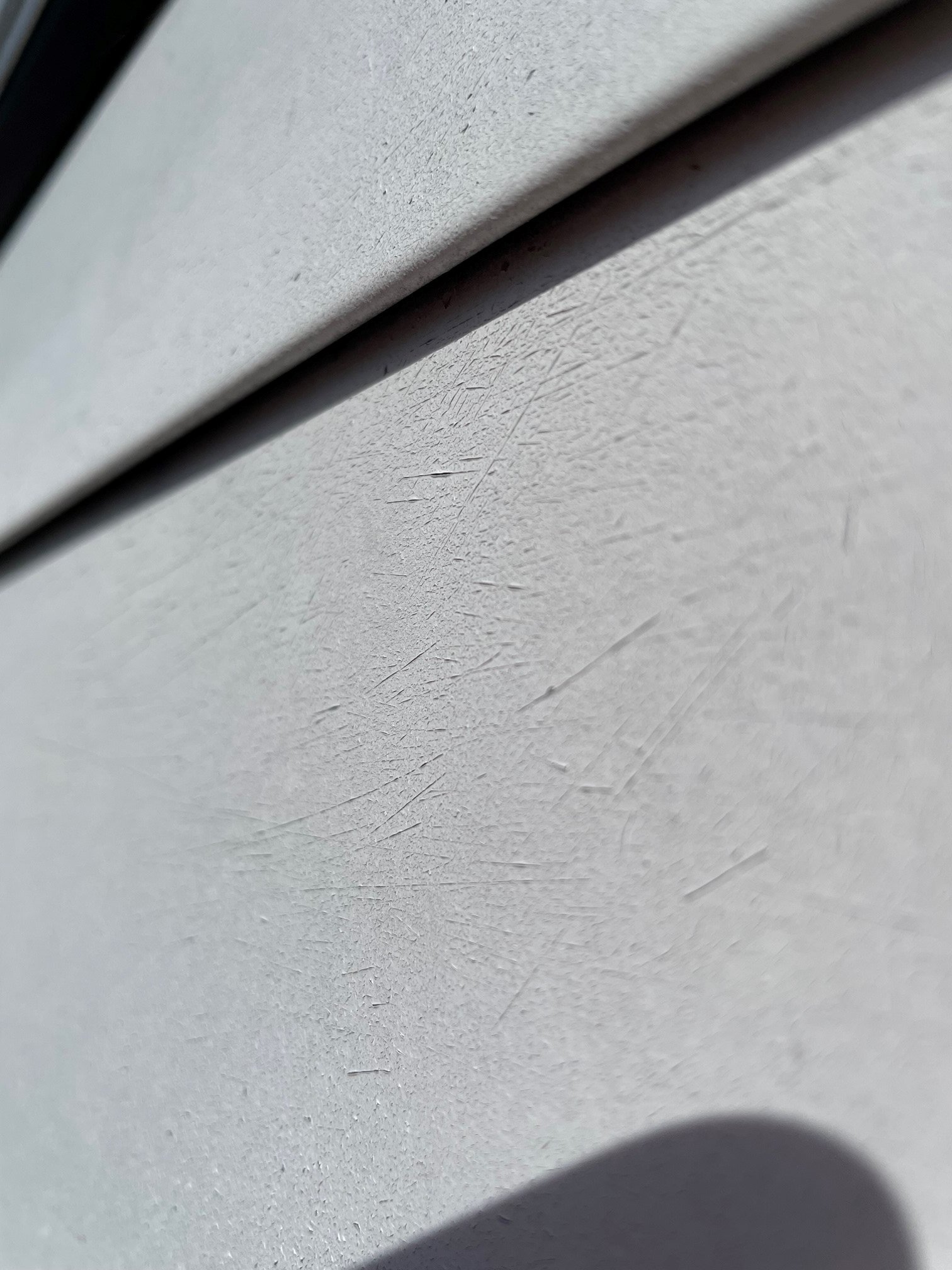

anglia4 Posted October 27, 2022 Author Posted October 27, 2022 George has sat pretty idle in the driveway since xmas time. He left the property for his EWOF which he passed with flying colours. Recently we decided to bite the bullet and make a start on the exterior. The paint was really badly crazed and cracked. I don't know what it was painted with, but it doesn't seem like it was the right stuff. Where I had needed to use some duct tape to hold the hatch door together had peeled the paint off. It was just rubbish. So I made a start. Out with an array of sanders and varying grits to see what worked best. The verdict was that none of them worked all that great, and it was going to take forever and leave me with carpul tunnel syndrome. So I got some chemical stripper and tried that. Much more effective. I started with Selleys Qwik Strip, but now am using Septone Paint Stripper, which seems to be working better. I don't recommend adjusting your safety glasses with this shit on your gloves. It starts burning your face very quickly... The photo below shows how much cleaner I could get the last part of this side for about 1/5th of the effort. 6 Quote

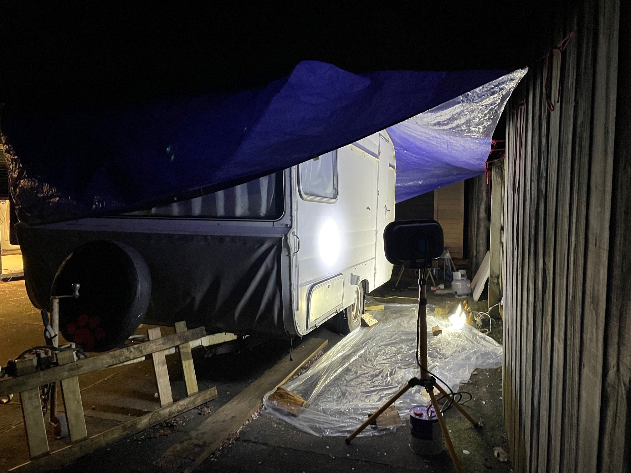

Popular Post anglia4 Posted October 27, 2022 Author Popular Post Posted October 27, 2022 Finding time to work on George is a bit of an effort with a young family. Most of my shed-able time is after the kids have gone to bed. Read: When its dark and damp outside. So I made a wee habitat from a tarp and my fence. This is also good for keeping the sun off as you can't strip the paint in the direct sunlight. The next issue was sunlight related. How was I going to strip the roof? I managed to commandeer a nearby workshop over labour weekend and got organised with some trestles. This kept me out of the sun and I made really good progress. Not too much more paint to get off now. Hoping to get onto the etch priming and water-proofing the roof in a week or two. 14 1 Quote

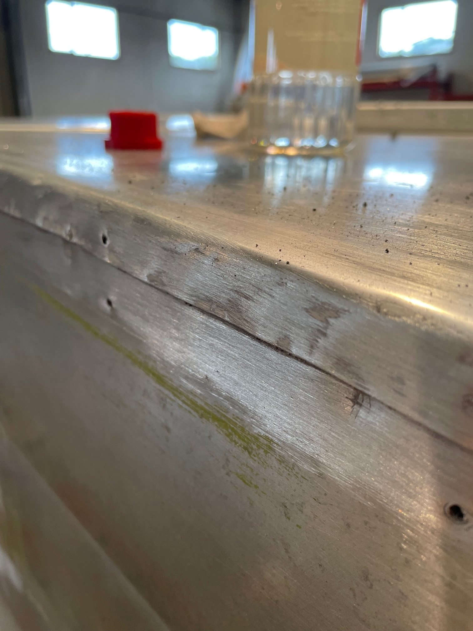

Popular Post anglia4 Posted November 1, 2022 Author Popular Post Posted November 1, 2022 Pretty much paint free now! I'm hoping to get into the etch and primer this weekend. I'm also really tempted to pull off the J-rails and Awning rails and redo the sealant behind them. It would suck to go to all this effort only to find I've created a leak somewhere with the paint stripper. But it does look like a shit of a job... 16 Quote

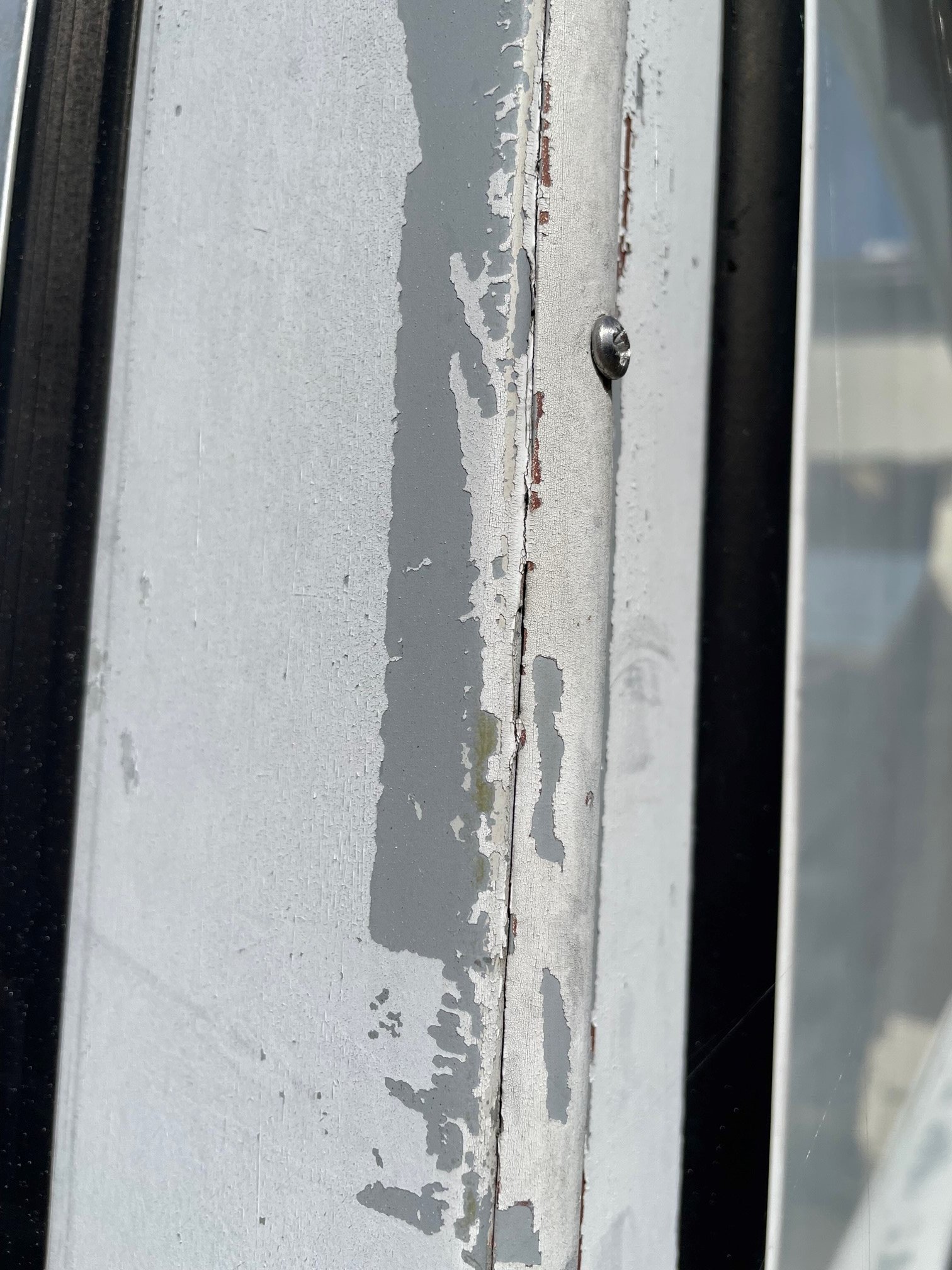

anglia4 Posted November 29, 2022 Author Posted November 29, 2022 Fuck its been a huge weekend with George. Having had paint stripper over the whole thing, I was a bit worried that it would have damaged the sealant around the J-Rails, particularly at the edge of the roof. Apparently this is a notorious area for causing leaks. So with little motivation for this job, the wife and I just got on with it. Pulled off the awning and J-rails, cleaned off all the old sealant. Reinstated with new sealant and new screws. 9 Quote

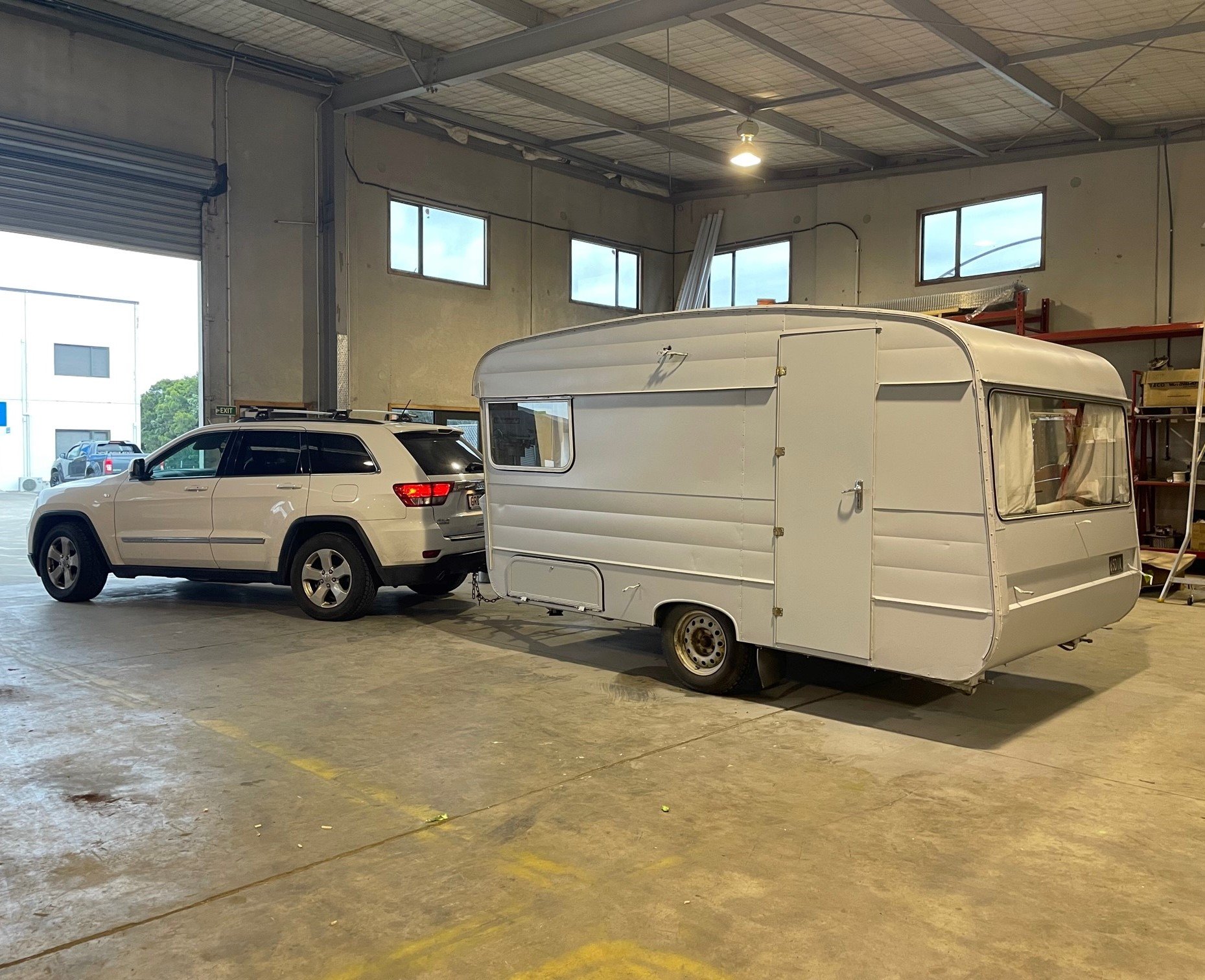

Popular Post anglia4 Posted November 29, 2022 Author Popular Post Posted November 29, 2022 I had hoped to get him into primer on Sunday, but by the time I'd finished the rails, then done all the masking and wax and grease remover, it was midnight on Sunday night. I've been borrowing some floor space in a local workshop, and was supposed to be out of the way before they opened again for the week I hid the caravan in the corner of the workshop under a cloak of un-invisibility (pictured below) to get through Mondays work day... Then come Monday after work I got stuck in. Etch primer: I suspect I laid the etch on a little thicker than its supposed to be. The paint salesman told me it goes on thin, just a dusting... After emptying the gun the first time and the realisation that "holy shit I'm gonna run out of paint fast at this rate" I dialed back the settings on the gun a bit. Followed by the primer. I finished up and got into bed at 1am, and then back at the workshop at 5am to un-mask and put it back together enough to take it outside and get it out of the way before everyone started work for the day. Now I've got an acre of sanding / filling / sanding / spot priming to do before he goes off to the painters. Pretty stoked to be at this milestone though. 14 Quote

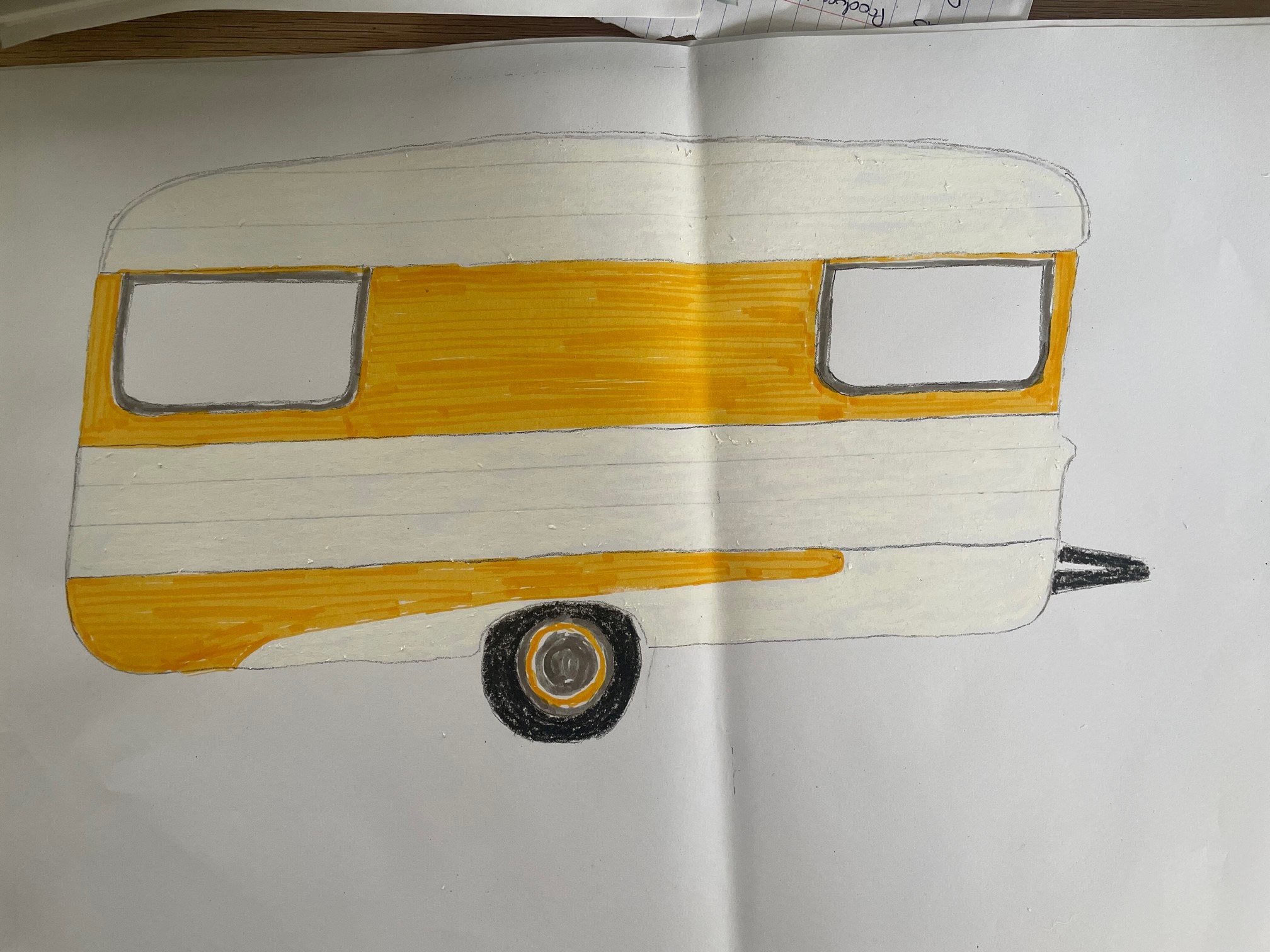

Popular Post anglia4 Posted December 7, 2022 Author Popular Post Posted December 7, 2022 Fuck that was a massive amount of sanding! George was delivered to the painters this morning. Very exciting times. I was thinking this morning, that its been a decade since I finished building my CB650, and this is the first project I've managed to get to this kind of point since then. I also took a few minutes the other night to test fit the new wheels I got for him, they fit and look great so now I can arrange some new commercial tires for them and get onto painting the rim centers. The instructions for the painter: FIZZING 21 Quote

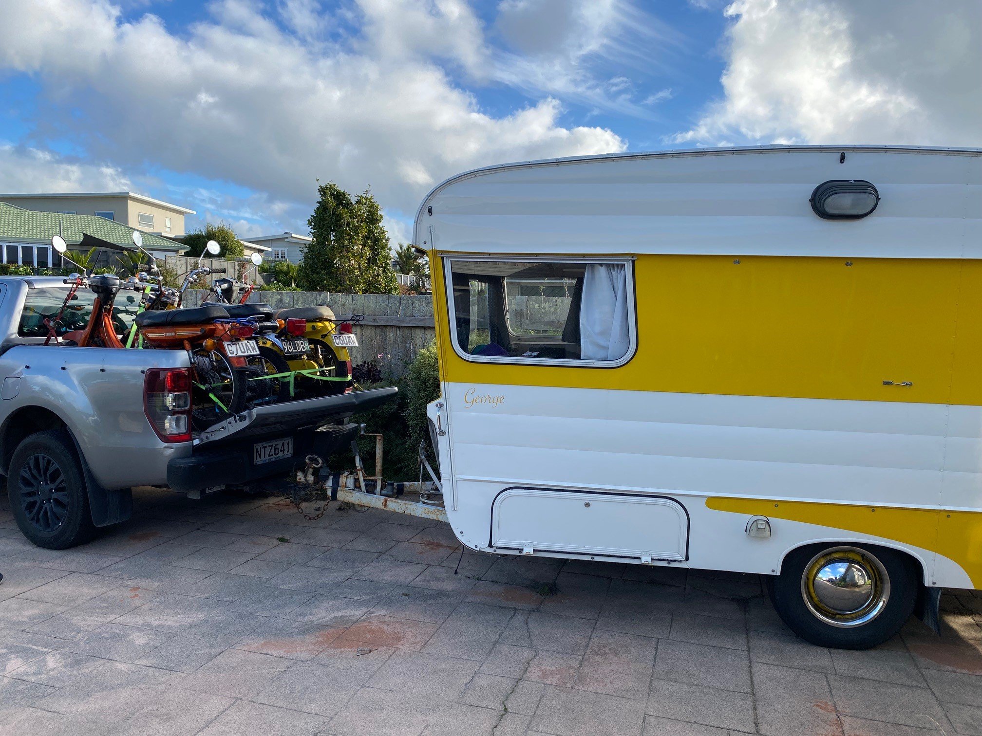

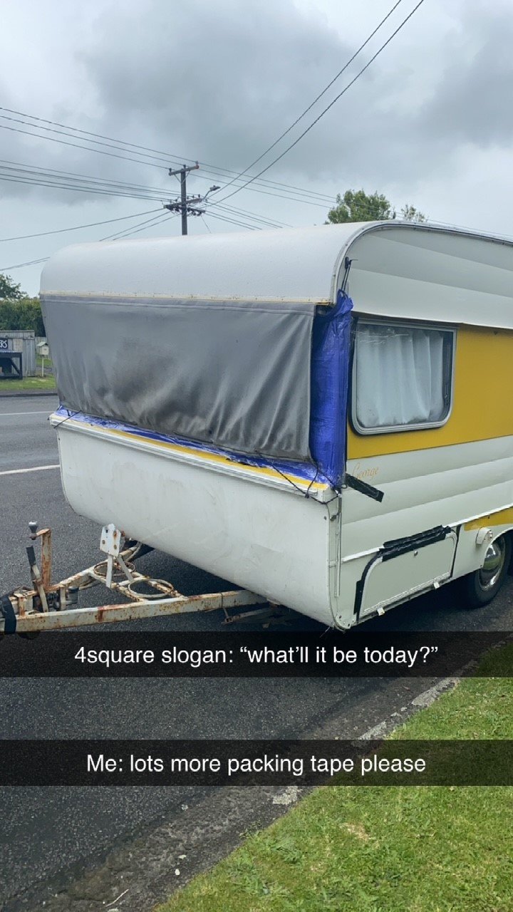

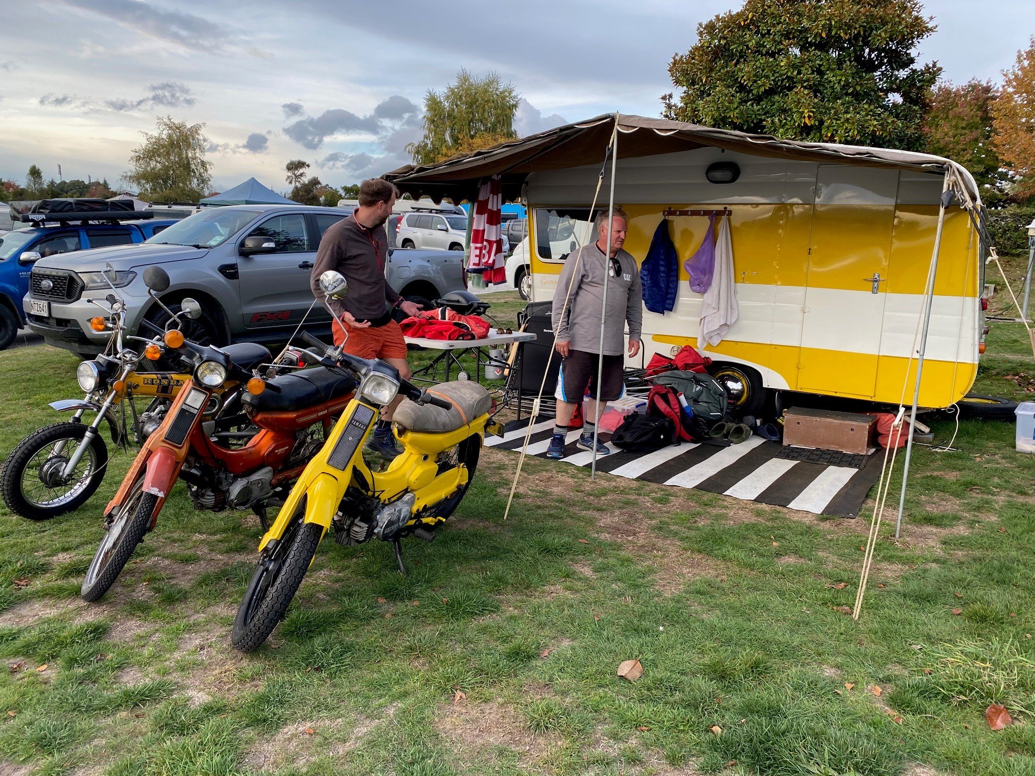

anglia4 Posted January 6 Author Posted January 6 So, after all that last summer we used George a couple of times throughout the year with the duct tape still in place to make sure the window stayed put. Most notable trip was to Taupo for the supercars with the small bikes and @alfalfa. Then spent some money and got a new windscreen made up and installed with a better sized rubber "so the window won't fall out again"... For our summer break this year we decided just to hang around Taranaki and setup the caravan at my parents batch in Opunake. On the drive to Opunake we kept having the awning hatch pop open, which was a bit weird, so out with more duct tape to stop that happening. Then on the drive home, the bloody window popped out again... I had a thorough look over it with the glazier, and we couldn't find any obvious reason for it popping out, so we started to talk about gluing in a new window. I decided to have a bit of a probe around the framing as there were a couple of bits that looked a slightly doughy... Teeny bit of off-colour in the corner of the cabinet: So decided "fuck it, its renovation time". And started stripping the lining off 7 Quote
