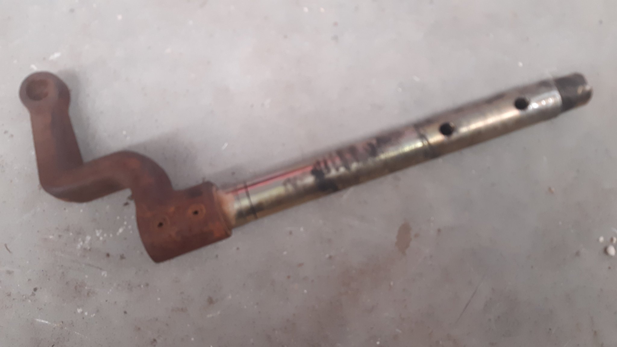

fuzzy-hair-man Posted December 28, 2022 Posted December 28, 2022 On 28/10/2022 at 16:25, Adoom said: Do you recall if the roll pin holes in the shaft for the top lever and the lower fork line up, or are they at a different angle? I know it might be a bit late but here's a photo of the pin alignment, as suspected they are pretty much inline. I fitted the heavy duty 0.75" master cylinder, the clutch works better but is very sensitive, so too much travel at the slave I think. I'm going to try the standard 0.7" master I think. Quote
Adoom Posted December 28, 2022 Author Posted December 28, 2022 8 minutes ago, fuzzy-hair-man said: I know it might be a bit late but here's a photo of the pin alignment, as suspected they are pretty much inline. I fitted the heavy duty 0.75" master cylinder, the clutch works better but is very sensitive, so too much travel at the slave I think. I'm going to try the standard 0.7" master I think. Nice! Thanks for that. I've been busy with the front panel and getting the underside prepped for epoxy primer. Quote

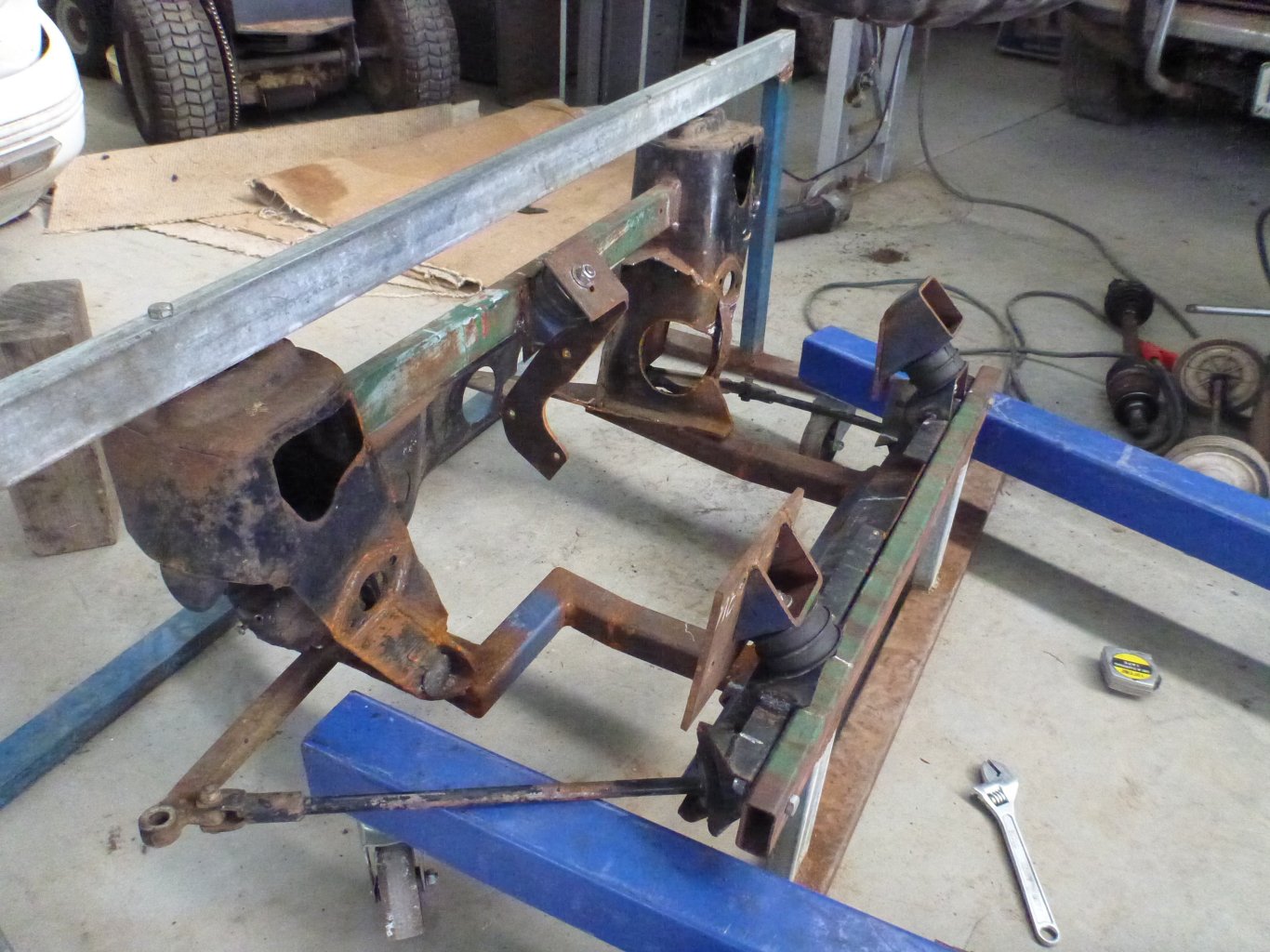

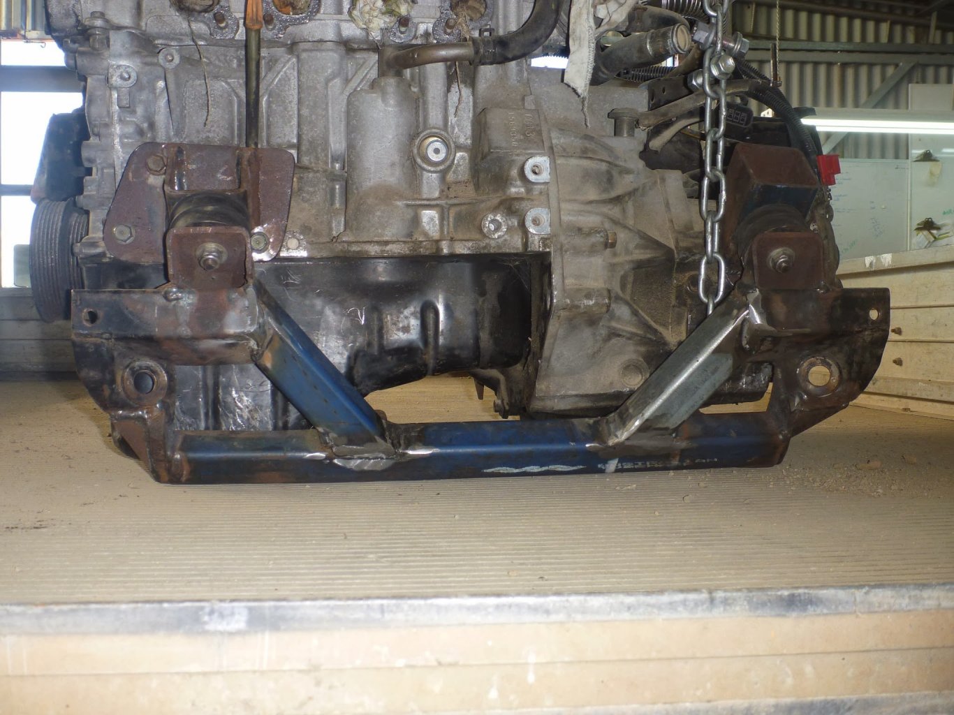

fuzzy-hair-man Posted January 5, 2024 Posted January 5, 2024 I was looking at your subframe work, I reckon it'd be a close thing but you might get the frame in. When I did mine the rail on the sump end goes in between the sump and the gearbox and shares space with the exhaust, means that its not much lower than standard. Trouble is the rail uses the space where standard micra extractors go so the exhaust needs to be custom. 2 Quote
fuzzy-hair-man Posted November 8, 2024 Posted November 8, 2024 With clearance to the tie rods the sump is pretty easily modified, either with a BFH (as I did in my 1st version) or cutting out a section and welding in a new bit, filling the sump up with petrol or similar on top of paper towel to test for leaks. Welding the sump wasn't as bad as I feared so could be an option. Quote
