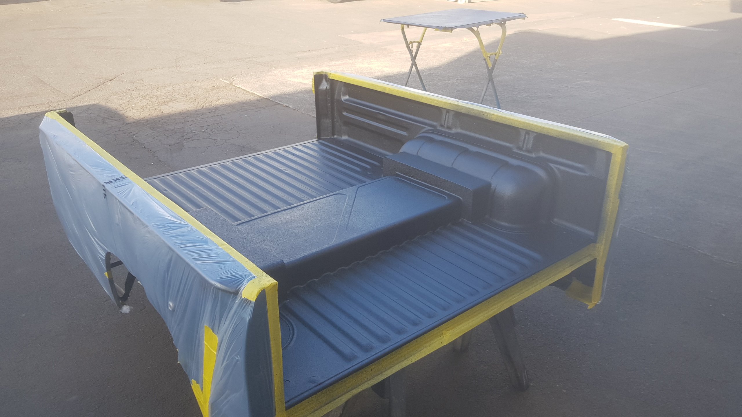

RXFORD Posted March 12, 2022 Author Posted March 12, 2022 Got the underside prepped and cleaned, then primed, seam-sealed and sprayed some underbody sealer same as the underside of cab got. 7 Quote
Popular Post RXFORD Posted March 12, 2022 Author Popular Post Posted March 12, 2022 Topside got the same treatment, but in the harder wearing hippo-liner again. 11 Quote

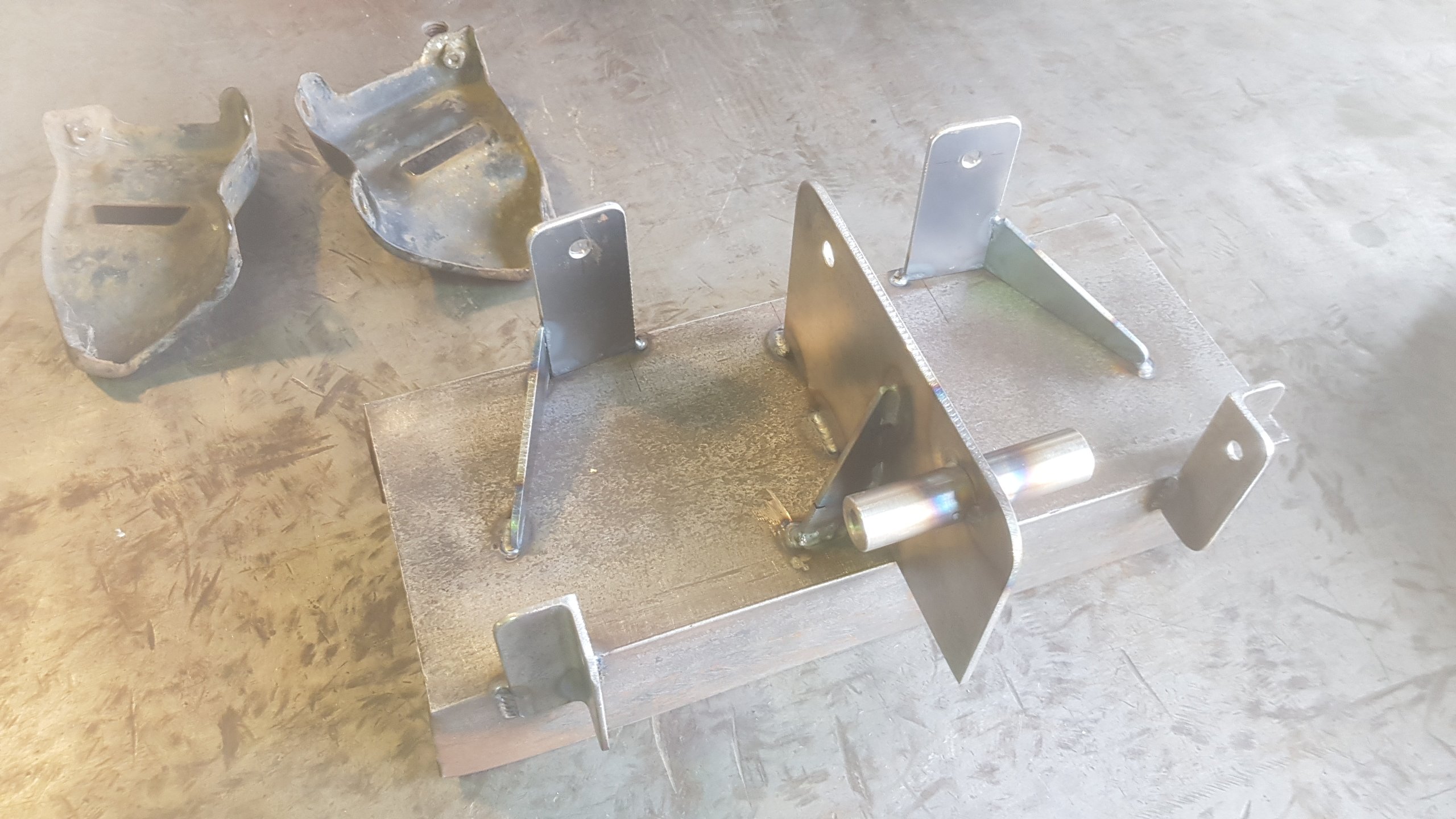

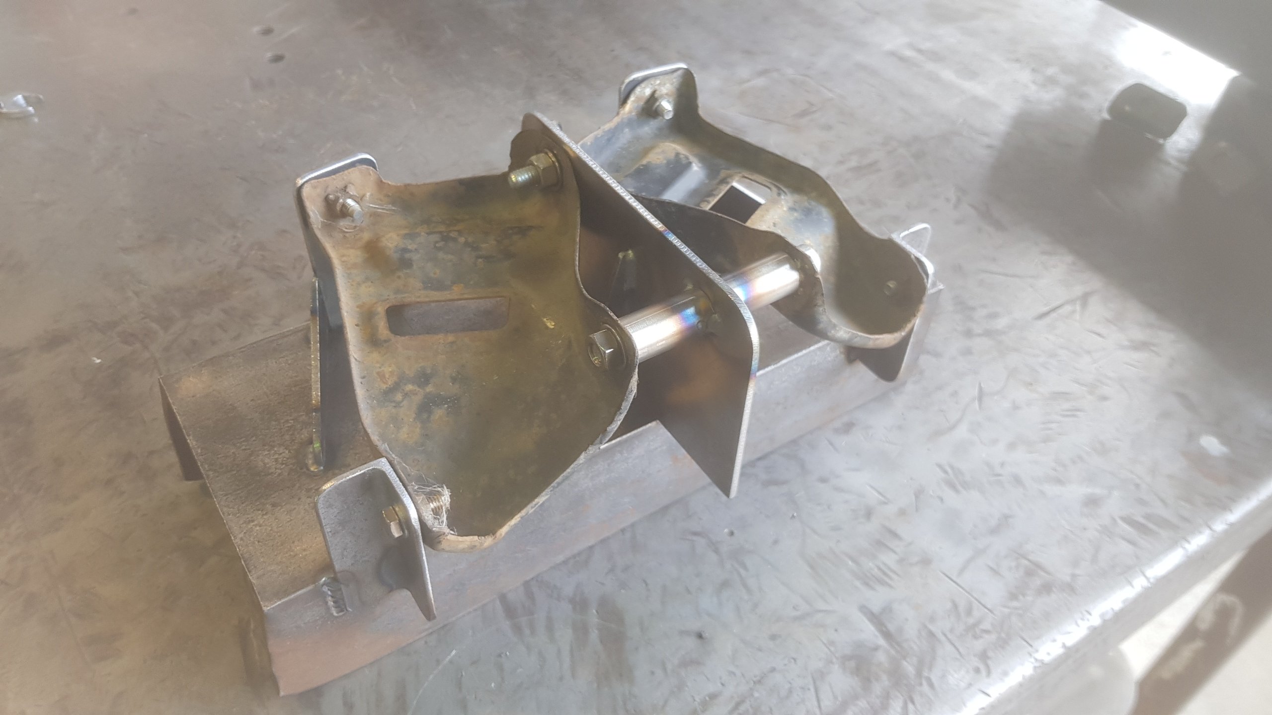

Popular Post RXFORD Posted March 13, 2022 Author Popular Post Posted March 13, 2022 Jay from Nelson was a good sort, and let me borrow his T2 bumper mounts. They are really hard to find, and I have been asking around since I got the thing last year. He actually unbolted them off his car for me so I could measure and Jig them. I made a jig on Friday evening, and drew them in cad. Should have so a pair back from laser cutters end of this coming week hopefully. Pretty hard thing to accurately measure, so will probably have to adjust the drawing a bit/tweak them but will be nice to get the bumper mounted finally. And also helps out other people with the same problem as I will be able to make sets for them aswell. 19 Quote

RXFORD Posted March 23, 2022 Author Posted March 23, 2022 Got lasercutting back, and fizzed up a pair. Minor amount of tweaking but all-in-all, not a bad initial measure. Bit ridiculous how much time I have in these but gotta do what ya gotta do sometimes... 6 Quote
Popular Post RXFORD Posted March 23, 2022 Author Popular Post Posted March 23, 2022 Just like a brought one. I'l get them powdercoated next time I have a run of things to do then I can finally mount the bumper. 19 Quote

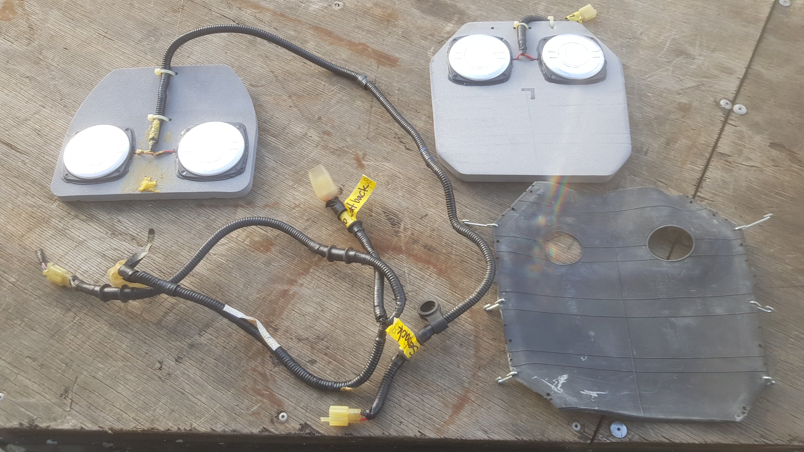

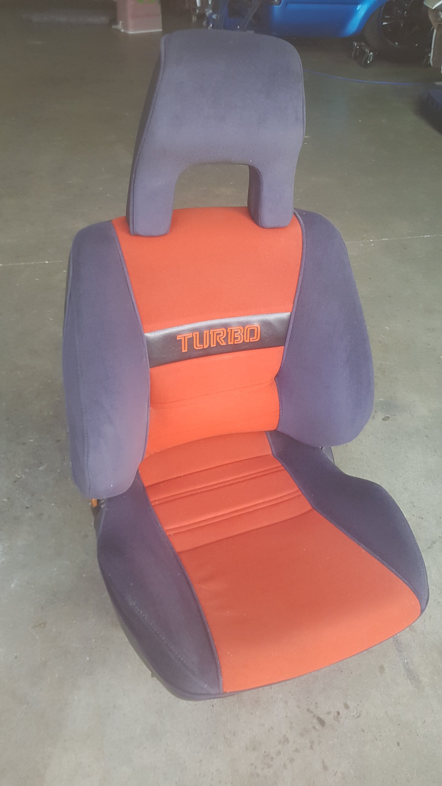

RXFORD Posted June 19, 2022 Author Posted June 19, 2022 Been a while since an update. Back tracking about 8-9 months ago I brought a City T1 seat from Japan. It was through Moonlight just before he did his last shipment and unfortunatly I just missed that last container. It was no big deal as I wasn't in a rush, so it ended up getting put aside at Stacked waiting for the first shipment from Empire Imports. Fast forward to about a month ago. It finally lands, and is ready for pickup. International shipping is fucked as of late. Anyway, it wasn't the seat I wanted, I actually went halves in all the costs with a guy who wanted it for his T1 resto, but it was the small woofers in the back and base that are pretty hard to find. These came as an optional Pioneer audio 'BodySonic' package. Basically a mono woofer that makes no sound but just gives a vibration with the music. I allready have the BodySonic control unit so now I just have to find another seats worth of woofers to retrofit into my Tallboy City project one day. 8 Quote
RXFORD Posted June 19, 2022 Author Posted June 19, 2022 Those are the bits I wanted from it... Rare find. And can see the BodySonic control amp that came with another YAJ score mid last year. Also got the correct optional head-deck made by Pioneer for the Citys with that score. 8 Quote

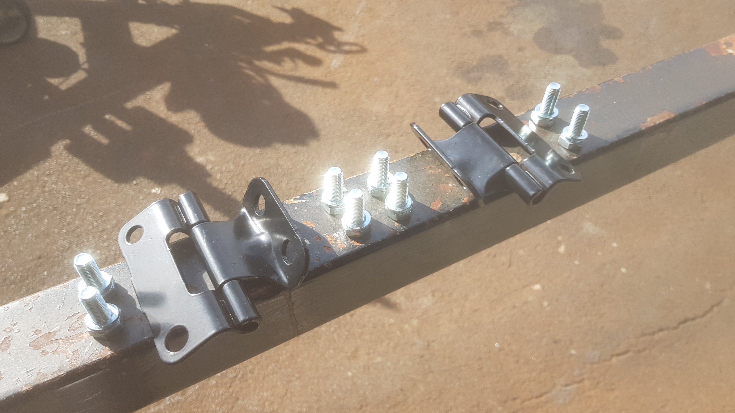

RXFORD Posted June 19, 2022 Author Posted June 19, 2022 Got the tailgate hinges powdercoated, and the latches re-passivated with new fasteners to suit. A buddy colourmatched the tailgate a while back, and I got a new handle too as the old one was broken. 5 Quote
