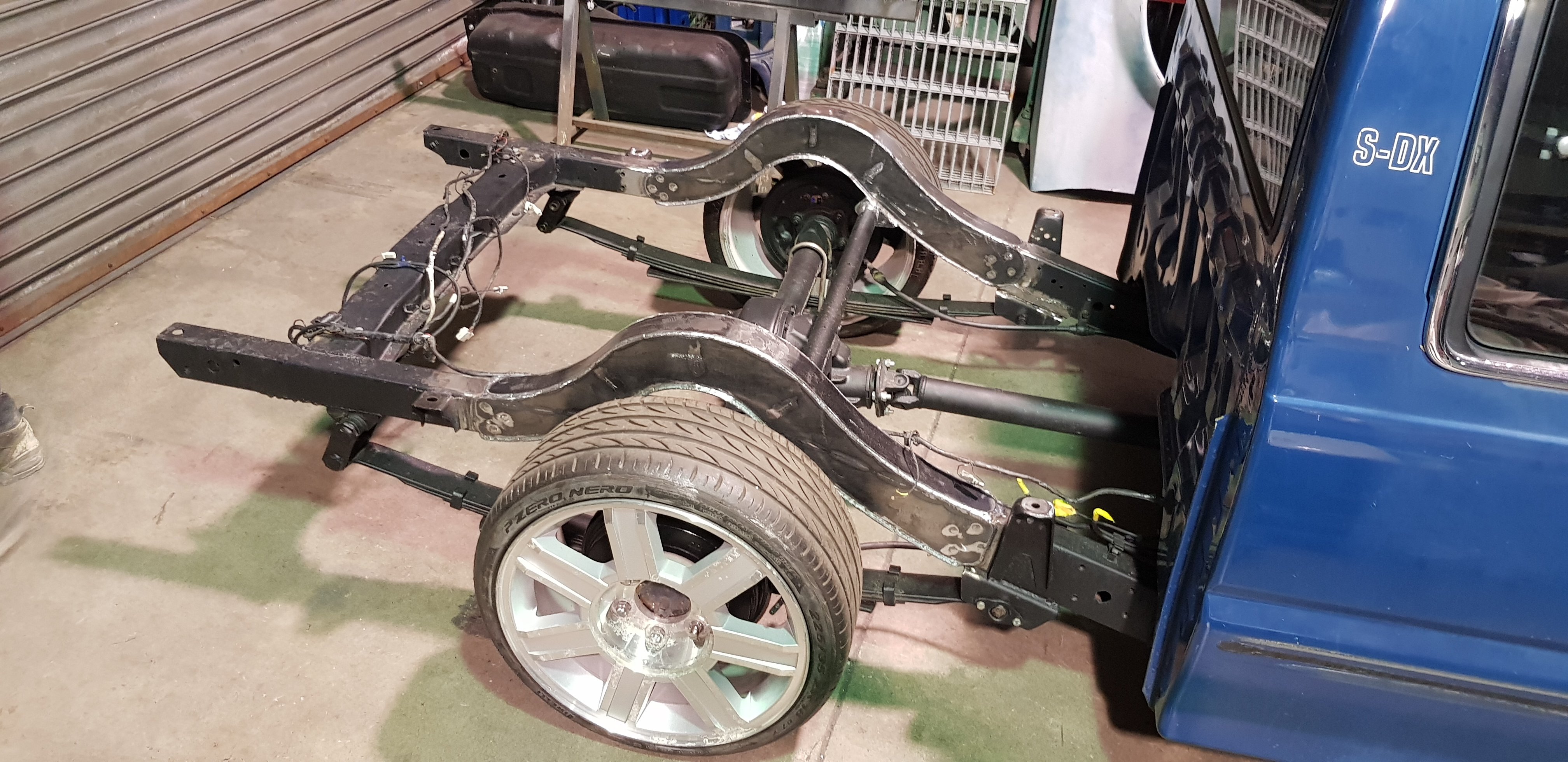

RXFORD Posted August 20, 2021 Author Posted August 20, 2021 Fast forward to now... A couple weeks ago I ordered some precut universal c-notch side plates off Airride Nz and rolled up the top/bottom capping to suit. On Sat 7th Aug I decided to bring it inside for the week as I had some space til another job showed up later in the week. Spent Sat/Sun getting it setup, rear end stripped and the rails prepped. Spent a few hours after work each night getting the notch plates in, the capping on and it all welded up. Had a few interuptions so didn't get it done by Thursday night like I had planned, and had already picked up job that was booked, so panicked a little, but @cletus bailed me out and gave me storage for the night. Hit it hard on Friday 13th and got the rails finished and the gas tank mount back in. Also managed to redrill the front spring hangers 2" higher then threw the springs back in and pushed it back outside. 9 Quote

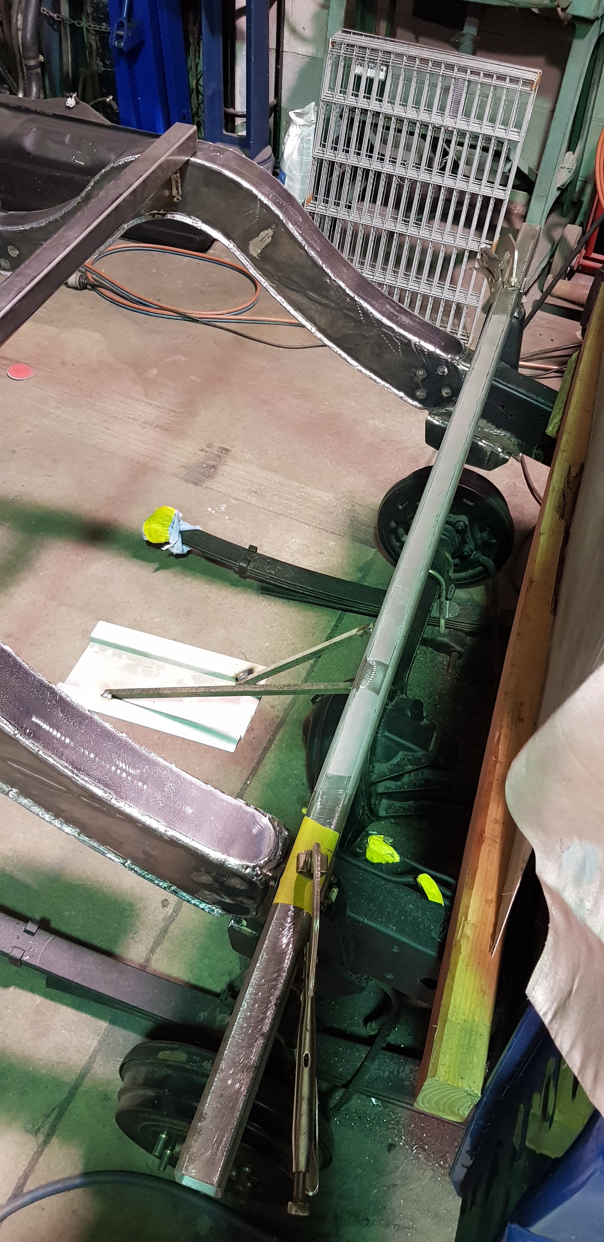

RXFORD Posted August 20, 2021 Author Posted August 20, 2021 Made a quick little jig to locate the rear gas tank mount before I cut it out to do new rails. Made life easy reinstalling. 7 Quote
Popular Post RXFORD Posted August 20, 2021 Author Popular Post Posted August 20, 2021 Still need to do upper shock mounts and rivnuts for wiring to p-clamp to but will set the rear height first. 11 Quote
