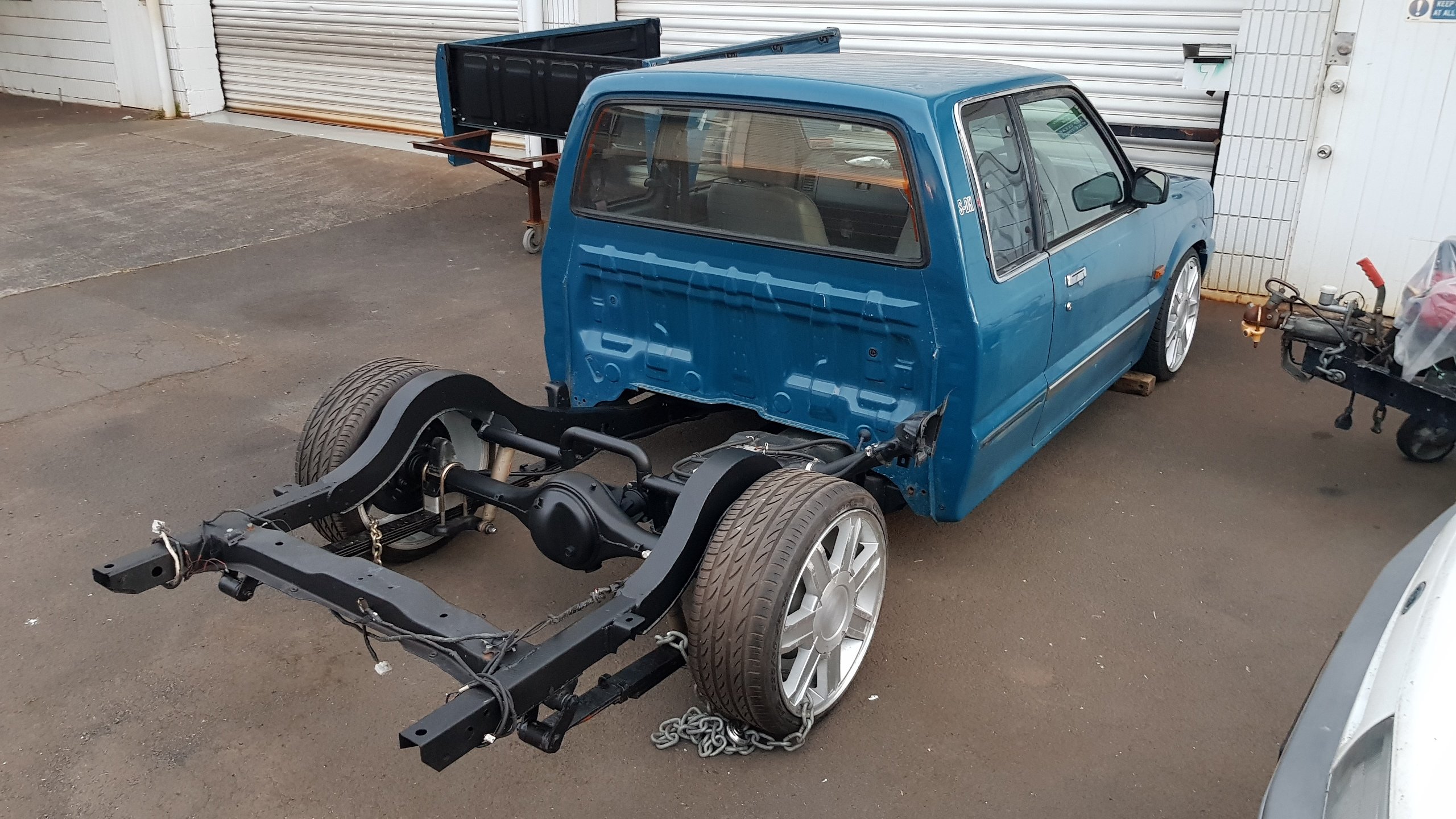

RXFORD Posted October 17, 2021 Author Posted October 17, 2021 Fastforward to this weekend. Lay under it out in the sun for a while on Sat thinking about the notch in tank x-member for diffhead and figuring out shock setup. Ripped the tray off and got stuck in. Got the tank x-member notch done and gusseted before days end Sat. 7 1 Quote
RXFORD Posted October 17, 2021 Author Posted October 17, 2021 Cut the spring perches off today so I could set the pinion angle. Needed to compensate for tray/tailgate and gas tank weight, so stacked some shit on it... 2 1 Quote
RXFORD Posted October 17, 2021 Author Posted October 17, 2021 Loaded the front up a little too to compensate for it settling etc. Set the pinion and fizzed the perches back on after a bunch of measuring. 5 Quote
Popular Post RXFORD Posted October 17, 2021 Author Popular Post Posted October 17, 2021 Thought I may as well get the shock mounts done before pack up time too. Flipped one of the stock upper shock mounts and used that on drivers side, then used some lasered brackets I had left over from another job on passengers. Shocks sit nice and more upright than stock so should ride a bit better. Can almost see the light at the end of the tunnel now. 18 Quote

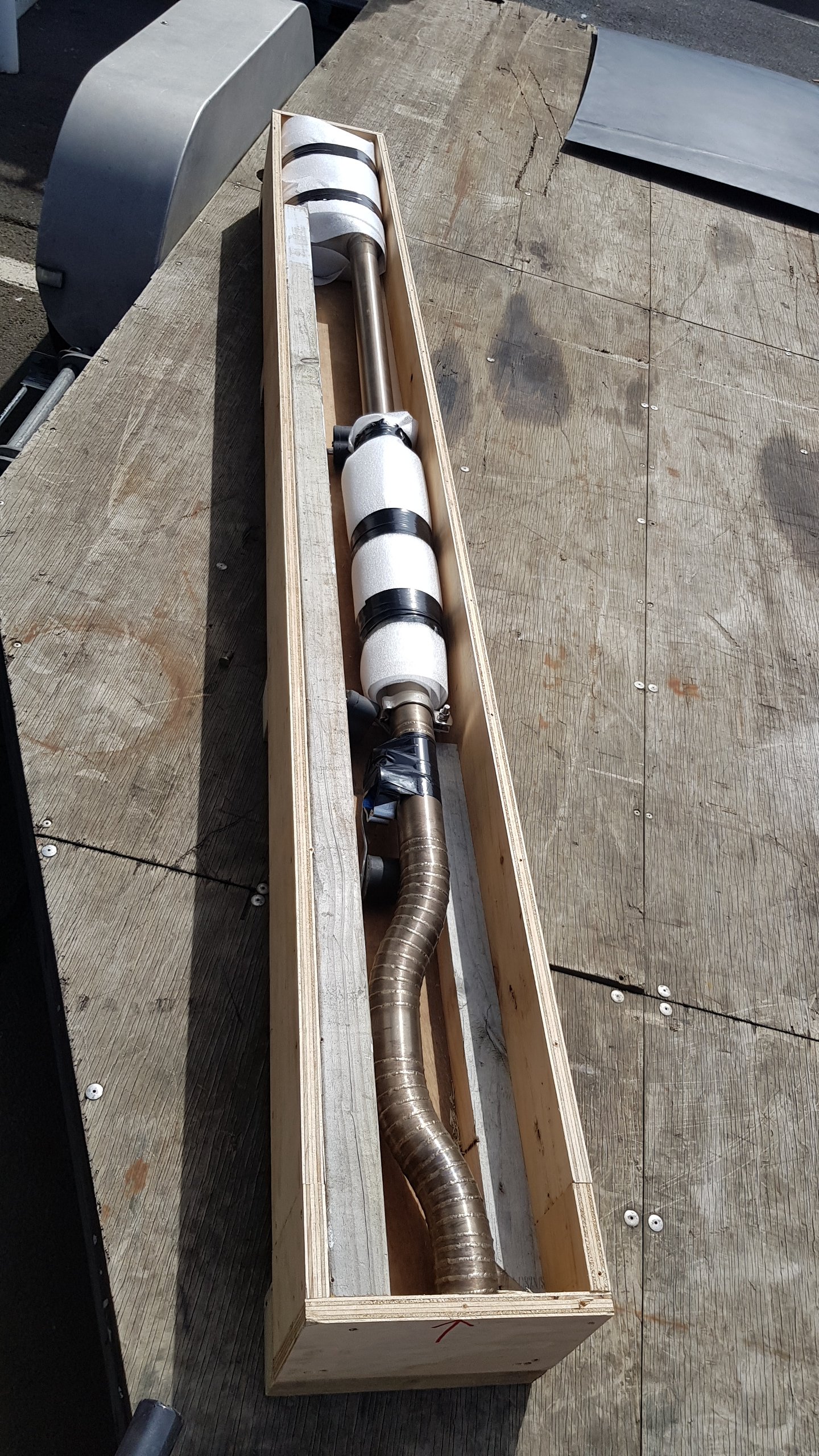

RXFORD Posted November 24, 2021 Author Posted November 24, 2021 Bit more progress on the B2000 over the past few weeks. I had a bunch of stainless tube and bends lying around, but havn't had the hoist free or the time to make a system, so when I spotted this setup that a guy was selling I thought I'd better jump on it. He was parting out his bagged truck for some reason which never actually made in on the road. He had the system made to tuck up above the chassis rails but still fit the stock chassis mounting points. Has an AdrenelinR muffler and reasonator fitted so wouldn't have been a cheap setup to get made. Can't complain for $425 shipped from Timaru to Akl... He even made this sweet crate to send it up in. My shifter bush kit finally showed up from Aussie, so I swapped out all the worn shit and fitted a new non-split boot then got it installed. Tight boxes are gooooood. 9 Quote

RXFORD Posted November 24, 2021 Author Posted November 24, 2021 Still have a few brackets to weld on, but needed to get some paint on the rear end. It was a nice day Saturday just been, so got it stripped and prepped. 6 Quote
RXFORD Posted November 24, 2021 Author Posted November 24, 2021 Smashed some epoxy down and probably covered my shitbox daily laser in overspray 7 Quote
Popular Post RXFORD Posted November 24, 2021 Author Popular Post Posted November 24, 2021 And laid down some black. Gave all the bushes, which I replaced earlier in the year, a clean and fitted with fresh grease. Also spent some time cleaning up the threads on the shackles and lower shock mounts plus the fasteners to suit. Some of them were pretty manky. Got it all back togethor and threw the has tank back in too. Good way to finish up a nice evening. Excuse the wheel nuts on the shock mounts, I had no m12x1.5 nylocs at the time. 24 Quote
