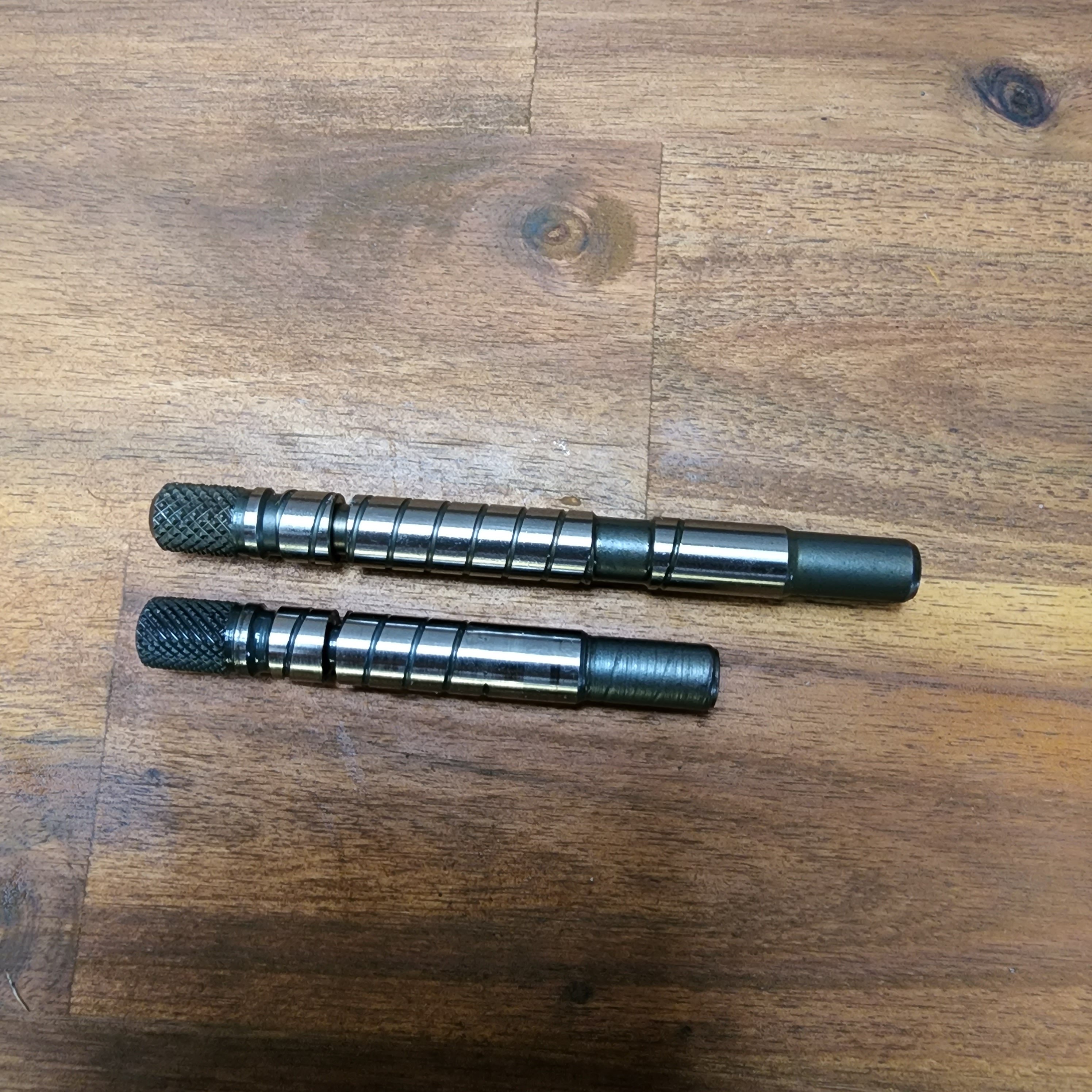

Jeffs_Emporium Posted June 9, 2022 Author Posted June 9, 2022 Dropped the ts-x22 off at axent audio in New lynn to be repaired. Not sure when I'll see them again. The speedometer driven gear showed up today which was actually 23/5 not 21/5 as previously posted. photo angle shows them as different size but they arent. 1 Quote
Jeffs_Emporium Posted June 9, 2022 Author Posted June 9, 2022 However the shaft length on the 23/5 is 25mm longer. I was about to go wild on the grinder trimming in and cutting new slot for cable to fit into when I vaguely remembered you can somehow change the head. Used a hammer and punch in vice on the 19/5 gear and it popped out revealing a knurled end on shaft to hold gear. 3 Quote

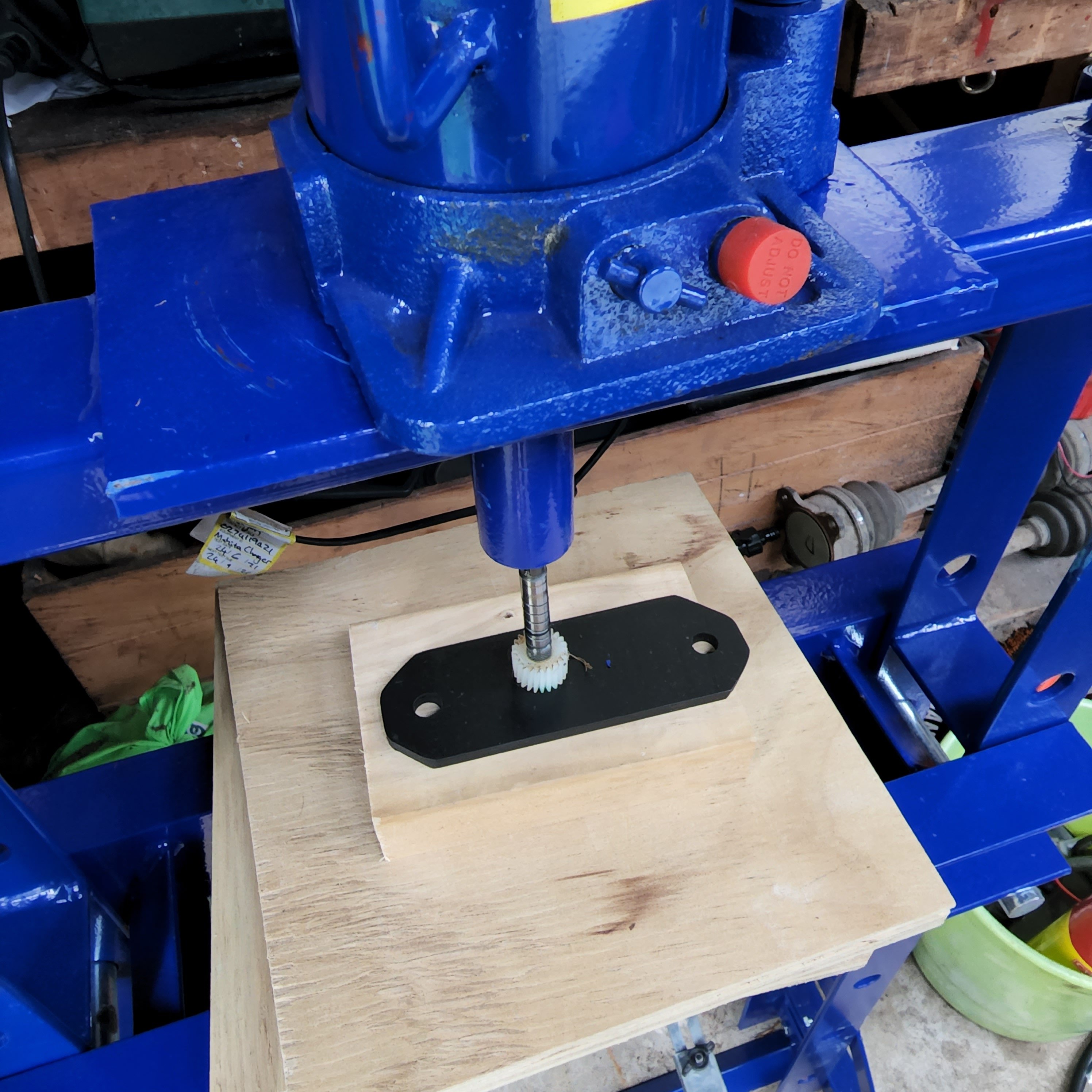

Popular Post Jeffs_Emporium Posted June 9, 2022 Author Popular Post Posted June 9, 2022 Used my 12T press to install the new gear on old shaft Popped it back in and went for a quick hoon up to 50km/h using GPS app on phone and it is spot on 50km/h on the dash. Pretty chuffed with that for the correct speedo but more importantly the correct reading on odometer as this has just clicked over 170,000kms which is a rare find for a 80s vehicle these days! 17 2 Quote
