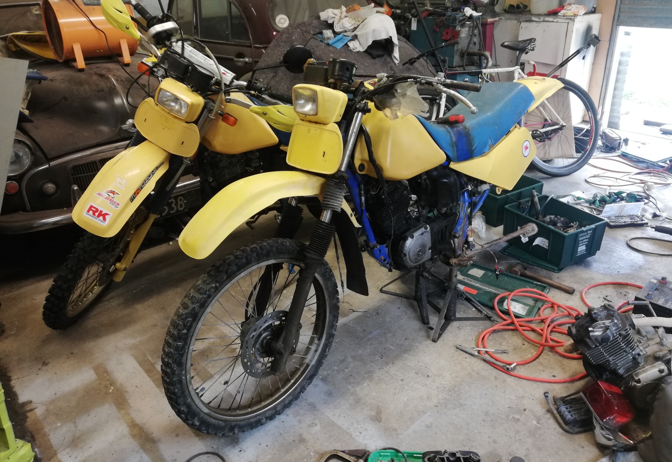

Two of the exact same bike. Max barry

Been putting the 87 together today. Putting parts on it as i find them in the boxes. Pretty happy to find most of it. Things its missing
front caliper, hose, and master cylinder - if im buying one i might see if i can get a better set up from something else for the same or less price
Rear brake shoes, rod, return springs, lever - got the pedal and shoes coming, rest is available
side plastic mounting bolts
speedo cable
Got heaps of bearing kits and seals so i pretty much have everyhting to make that an actual decent bike

Swapped the other swing arm in one that was in there had been freshly rebuilt which made it easy, and it's got new grooved brake shoes. So I think all the chassis has had new bearings and seals.
Now I can run a chain guard (and the 87 gets a rebuilt swing arm too)
Cut down the farm spec chain guard to roughly what a current road spec one looks like. It's missing the last half inch but I cut it off square and think it's ok.
Ready for rerego now
