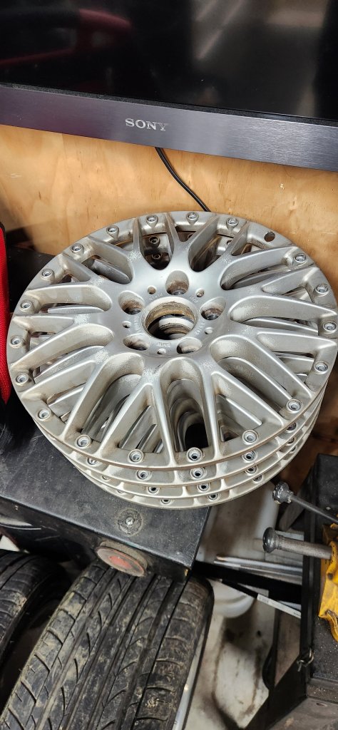

So  stoked with how the paint came out,  my painter has done a wicked job ,  it was gonna be white over silver until i found the bmw brown,  wanted to look like it could have been factory  just a little bit flashier,  fits with  the 80s theme with the brown interior, looking at wheel  options just incase the new brakes dont fit under the c4 wheels couple of contenders are OM-1 3 piece simmons, BBS LM or possibly  bmw style 42 but would need custom  lips/barrels
Wheel options sound so good. Simmons would look so good but I'm sure they aren't cheap. Lots of good-quality knock off BBS LMs around had some on my BA falcon that were great.
Problem is the knockoffs all have dud offsets usually  around +43- +50 to suit the gen 3/4 commodores, BBS can be worse in the low 20s for bmw which  wont clear the guards, to  get fitment i want/need  worked on 18x8.5 +31 for the front & 18x9.5 +38 there is an option to  custom order 1 piece om-1 simmons in offsets to suit,not to badly priced, would do gunmetal  centers not gold
style 42 look cool but pricey  to  buy and then need lips & barrels standard they  are +21 ish  offset in an 18 do  makes for odd sized lips

So since iv committed to the bmw style 42s iv gotta sort out narrowing the diff 25ish mm each side, now work out a suitable dark silver  to paint the centers with... any suggestions to some factory paint codes that would go well with my colour scheme, one possibility is the gunmetal of @Rhyscars lexus might be a bit dark tho, thinking maybe something similar to the mx grey with a bright flake in it
