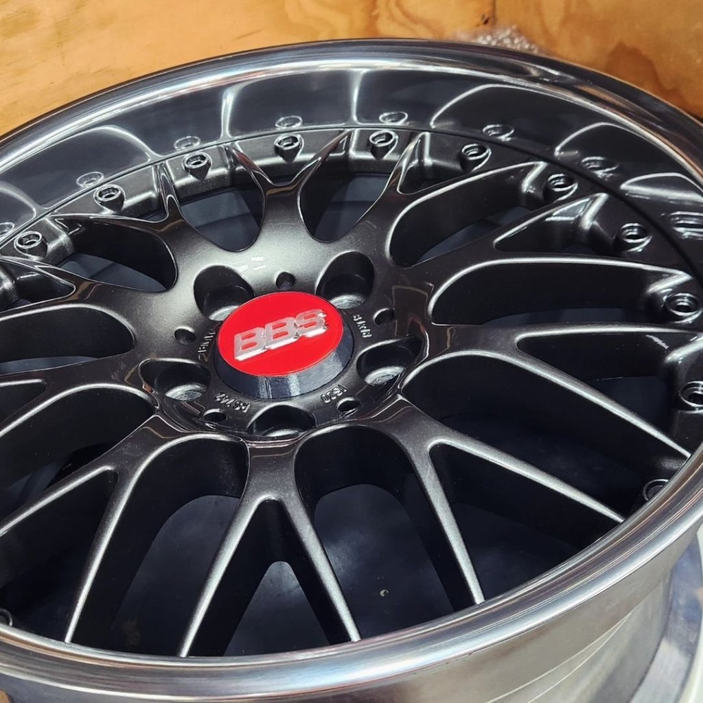

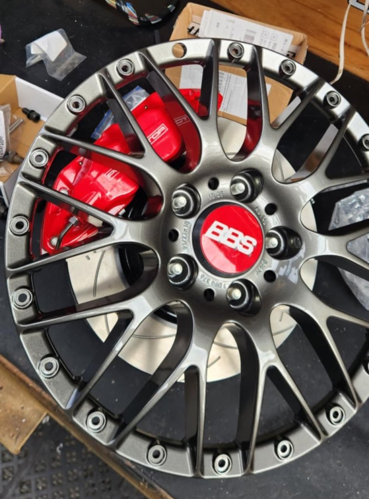

Wheels have been making progress, painters has sorted the centers in a custom mix gunmetal with silver on the inner barrels, & RKM sorted polishing the outer lips looking sharp now, just gotta finish polishing bolts to assemble them

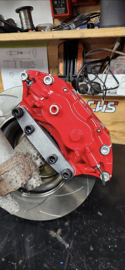

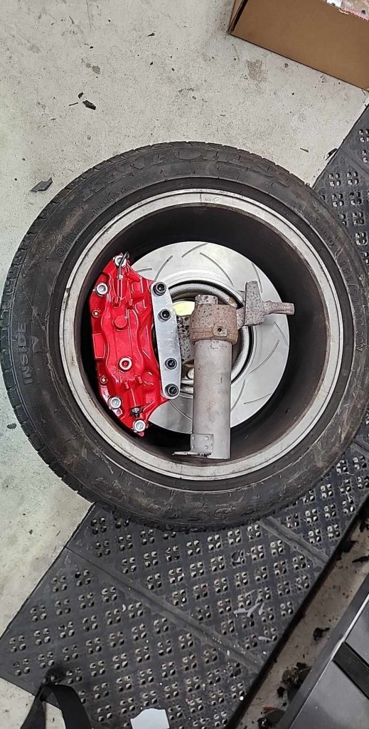

spent quite some time on this hence the several 3d print versions 1st, the rotor im using is a 320X32 vz thunder so same size & swept area as the factory evo rotor just a different hat offset height which suits commodore hub & gives good wheel clearance too , pad pretty much runs very near to the edge of the disc and almost to the inside diameter flat area so using maximum surface area possible

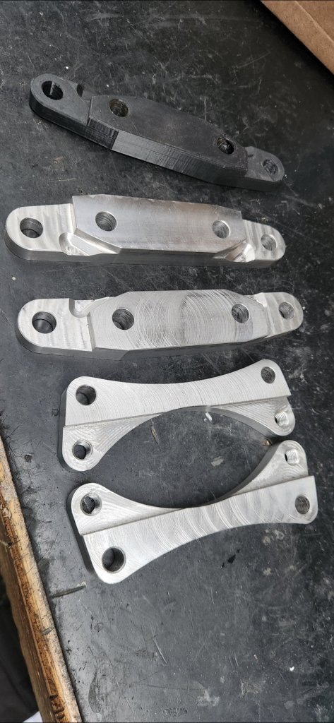

progress on the brake adaptors, a few chunks of 4140 now match my 3d printed models and fit spot on thanks to Moose design for sorting the machining, there's even hope to keep the corvette wheels it's super tight but they do clear in the 16"wheels
