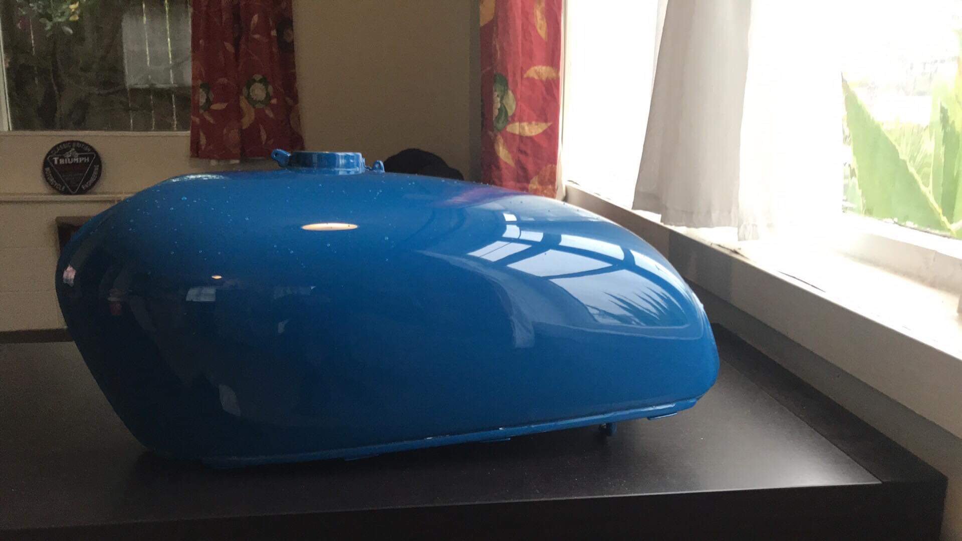

Abarth Posted May 12, 2019 Author Posted May 12, 2019 While a bunch of parts are inbound from the US, U.K. and China we decided to get busy on the jobs that can be done locally. Currently all the hubs and engine parts are with the vapour blaster after stripping it all down. Got the tank back from the painter, stoked with how it turned out, tried to keep as close to the original colour as possible but with high gloss. Gonna look mint with the new chrome strips and chrome fuel cap fitted. Also going to add the Honda wings logo to the sides. Quick compare to the old paint, about a million times glossier than before and maybe a shade lighter because of it but stoked with how it turned out! 3 Quote

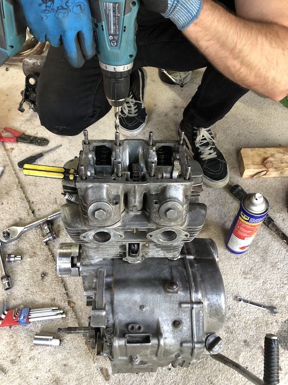

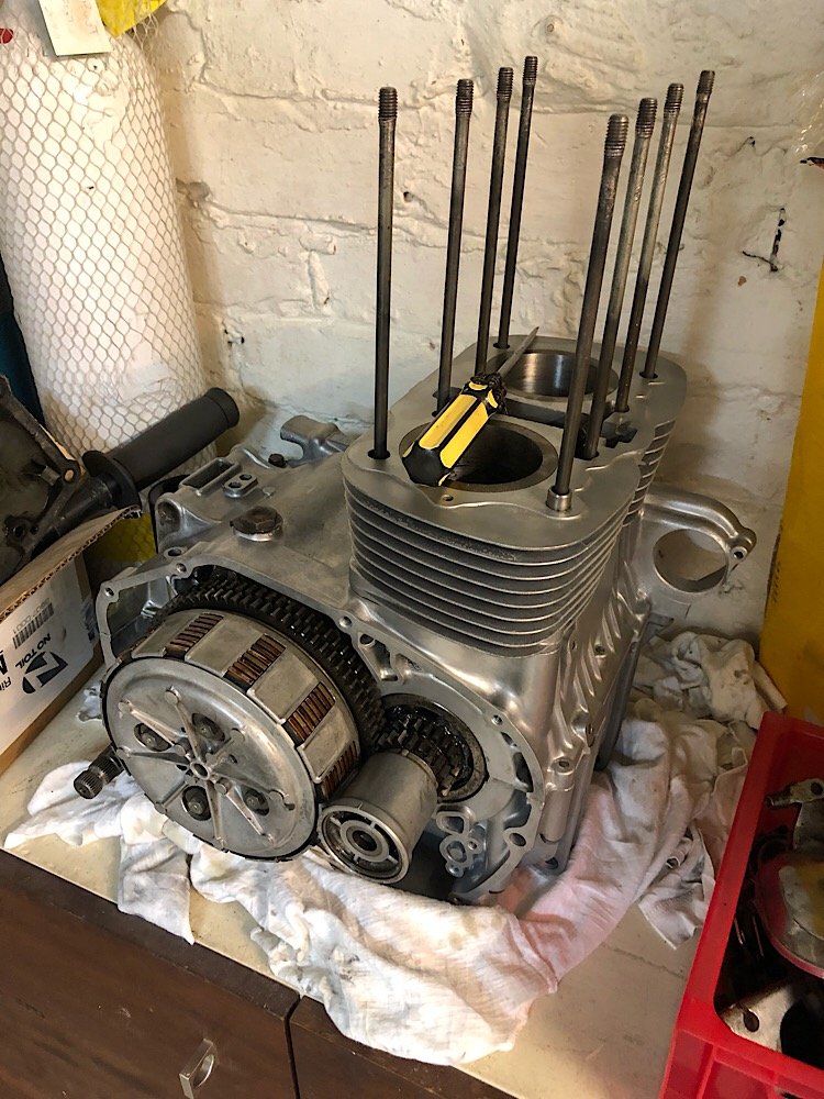

Popular Post Abarth Posted May 31, 2019 Author Popular Post Posted May 31, 2019 Work continues.... Got the motor back and it’s looking mint! Thanks @Mr Vapour!! Chopped the rear end to fit the rear hoop, just need to smooth off round where the steel pressed frame meets the tube steel. An order from 4 into 1 arrived which meant we could crack on with the carbs. Wicked rebuild kit which literally had everything, even included larger jets for the trumpets. Also made a start on the motor, had the bros round help lap the valves and reassemble the head. The lower casing had a oil pan fitted in the bottom which weirdly had two screws and three rivets holding it in. Had to drill out the rivets to remove it and clean the sump properly. Then drilled the holes and tapped a thread in each to add proper screws in. 9 2 Quote

Abarth Posted June 15, 2019 Author Posted June 15, 2019 Threw in all new wheel bearings into the hubs. Converted the steering bearings to tapered bearing with a kit from 4 into 1. Then made a start on assembling the motor. Reassemble the gearbox first, cleaned everything and check it ran through the gears before closing the cases with Yamabond. We’ve noticed that one of the pistons has stuck rings, looks like it got hot at some point. Which is probably the reason it got parked up in the first place. Will have to order new rings and pistons. It was already on 0.5 so will probably go 0.75 oversized this time. Looks like the oil pump plunger has a lot of scoring on it, so will be rebuilding it to make sure oil pressure is good. Thinking that we will give the freshly vapour blasted alloy a coat of 2k matt clear keep it fresh. 6 Quote

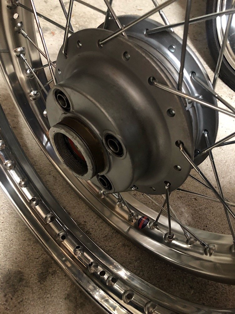

Abarth Posted July 6, 2019 Author Posted July 6, 2019 Rim’s arrived from Birmingham, England this week. Stainless steel WM2 and WM3, one size wider than factory. Got stuck into lacing them up to the hubs, stoked with how they turned out. Cycle Treads did the final truing and torquing of the spokes. Going to run a 3 inch wide tyre on the front and a 4 on the back. Gave all the vapour blasted parts a couple coats of VHT satin clear to keep them looking crisp. Also added all new wheel bearing to the hubs, stripped the front forks and cleaned them up. Added genuine Honda fork seals and fresh oil ready to go. Motor is still waiting for the pistons which is on the way and the frame is down at the engineers getting the hoop welded in fully. 8 Quote

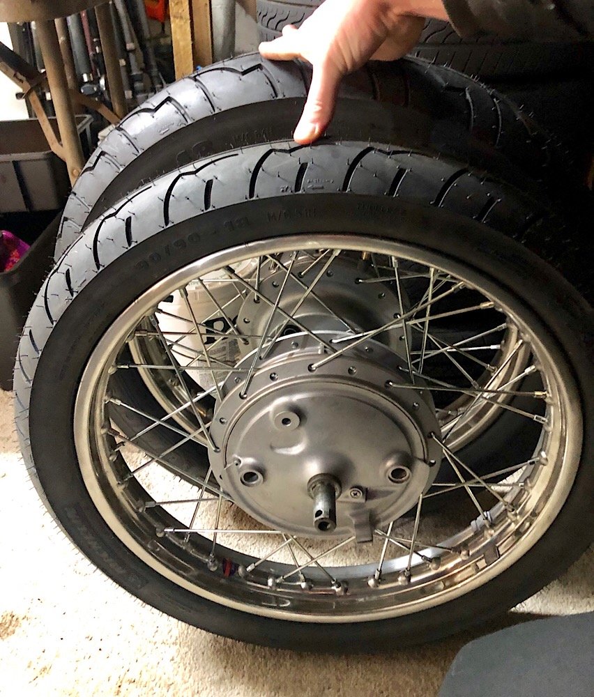

Abarth Posted July 12, 2019 Author Posted July 12, 2019 Got the tyres fitted to the rims. Went with Michelin Pilot Activ, 90/90r18 on the front and a big ol 4.00 on the back. Remember the 90/90r18 is pretty much the factory rear size which is now on the front. Looks tiny compared to the 4.00. The 4.00 has a 102mm tyre wall height while the factory 81mm. May swap out the rear for a Michelin Sirac as they have a 110/80r18 rear size which may suit the frame clearances better. Plus they have a sweet semi trail blocky tread pattern. With the 90 on the front it’s a squeeze to fit them under the factory guard but it’ll go. Got chopping with a drop saw, almost felt guilty as it was a mint guard. Will re weld on the ends to keep the nice factory curves. and lower the mounting brackets so it’s more flush with the tyre. 3 Quote
