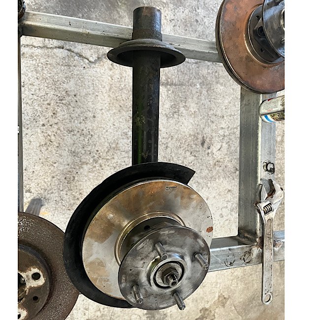

shizzl Posted August 8, 2022 Author Posted August 8, 2022 Finished bolting in the fishnet recaros this morning while waiting on materials to arrive. also picked up some wedge lock washers for the brake discs. I don’t know why, but the hunter brake hoses fit the escort calipers, even though the internet says Theyr different threads. So what if Theyr cross threaded right 8 Quote
Popular Post shizzl Posted August 8, 2022 Author Popular Post Posted August 8, 2022 Brakes are on!!!!! hoses and lines connected. have ordered some pads from palmside for “fast road car/high performance “. once they arrive I can fit them and bleed it all up. Check for leaks, apply electrical tape and cable ties, walk away. also altered the gear stick angle for a more rearward position. Easier to reach 1st now. post cert I will get new carpets fitted. next on the list to do: shifter hole cover and boot, adjust rear brake shoes, bolt check. Wait for engine to be built. Add in the extra resonator I have. Modify the centre console for the new shifter hole shitchea!!! 15 Quote

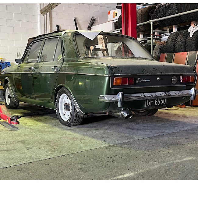

Popular Post shizzl Posted August 25, 2022 Author Popular Post Posted August 25, 2022 A bit more skiving off was done today. moved everything around in the workshop. GTX is now on the hoist and back up and running. Started refitting carpets into the hunter, then the console. mocked up how I need to make a new centre plate for the console. then turned a golf ball into a gear knob haha. just having carpets and a console makes it look so much tidier. then I remembered I had a pair of used mk2 escort arches floating around. Taped them on for effect. actyal think they look alright. the moulding on the front piece fits perfect to the moulding on the hunter. the back section just ends abruptly. but it sits flat and really well. 15 Quote
