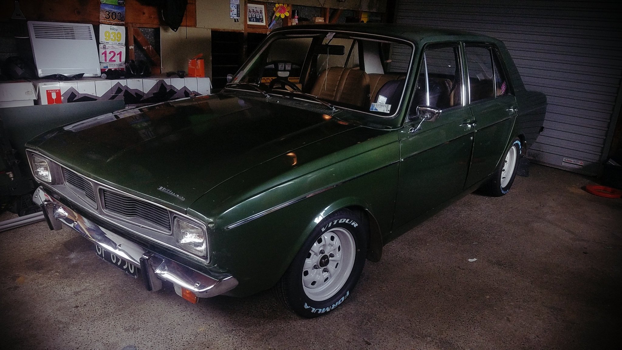

Popular Post shizzl Posted January 25, 2019 Author Popular Post Report Share Posted January 25, 2019 Ordered 2" blocks, got 1.5"blocks... ffs Chucked 2 spare wheels in the boot.. 13 Quote Link to comment Share on other sites More sharing options...

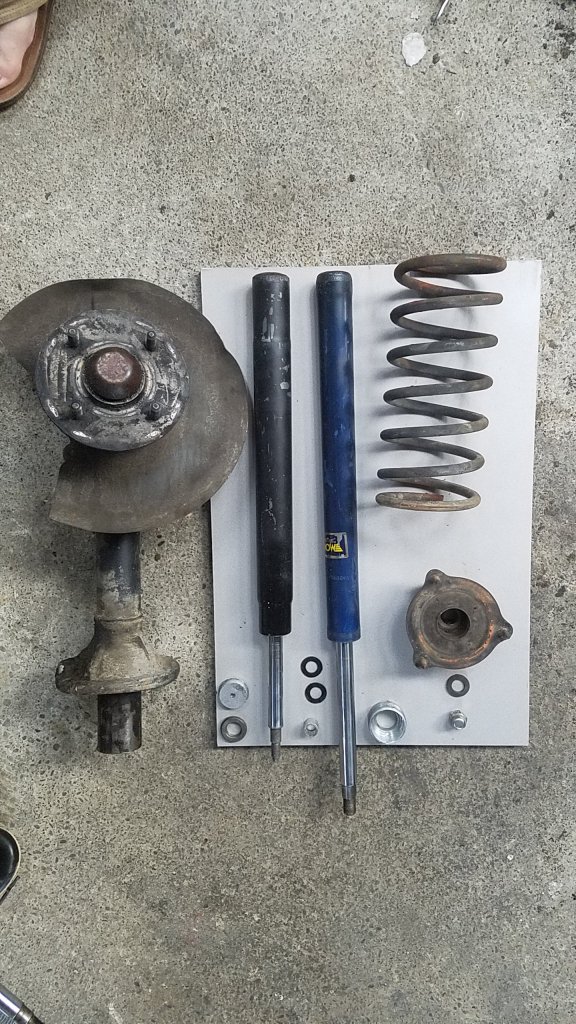

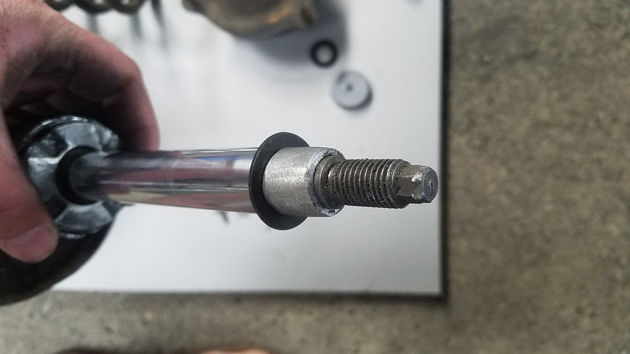

shizzl Posted May 24, 2019 Author Report Share Posted May 24, 2019 So today I finally finished the shock insert conversion using an E30 insert. The only mod needed was to add a 6mm spacer in the base of the shock tube, and fit a 19x2.5mm tube to the shoulder of the spear. I added a washer at the base of the top hat bearing shoulder, slid the 19x2.5 tube over the shoulder ( this is a bush for a tight fit for the top hat bearing). Then the top hat, washer and top nut as usual.. ( I used a wheel nut for now to test to make sure it all worked, will replace with nylocs now). The spring is a standard MK1 escort coils on narrow/cone perch hunter shocks. My other set are wide/flat perch shocks, for those I will use a MK2 coil. E30 318 insert is black, hunter is blue. Test drive felt good, coils are fairly soft though, could always fit lowered MK1 coils and will be more than captive. Next job is to find some M16 ford calipers and fit those as these calipers have always dragged, plus it will allow for a vented disc conversion later on with a caliper spacer kit. I also used my newly acquired carb sync and balanced the carbs. One piston is being a dick and not centering the needle perfectly, but the sync is good, throttle response is good, but is still rich on idle as they are not the correct needle I need.. I have 6J needles where I need 6R needles and blue springs. Now that it's back together I can start cleaning up the spare motor, post matching the bike carb manifold plate, make the manifold, get the head tested and maybe new valve seats and guides etc. Clean and inspect the block, hone and paint etc. Then send the cam away for a rearing before engine assembly. 4 Quote Link to comment Share on other sites More sharing options...

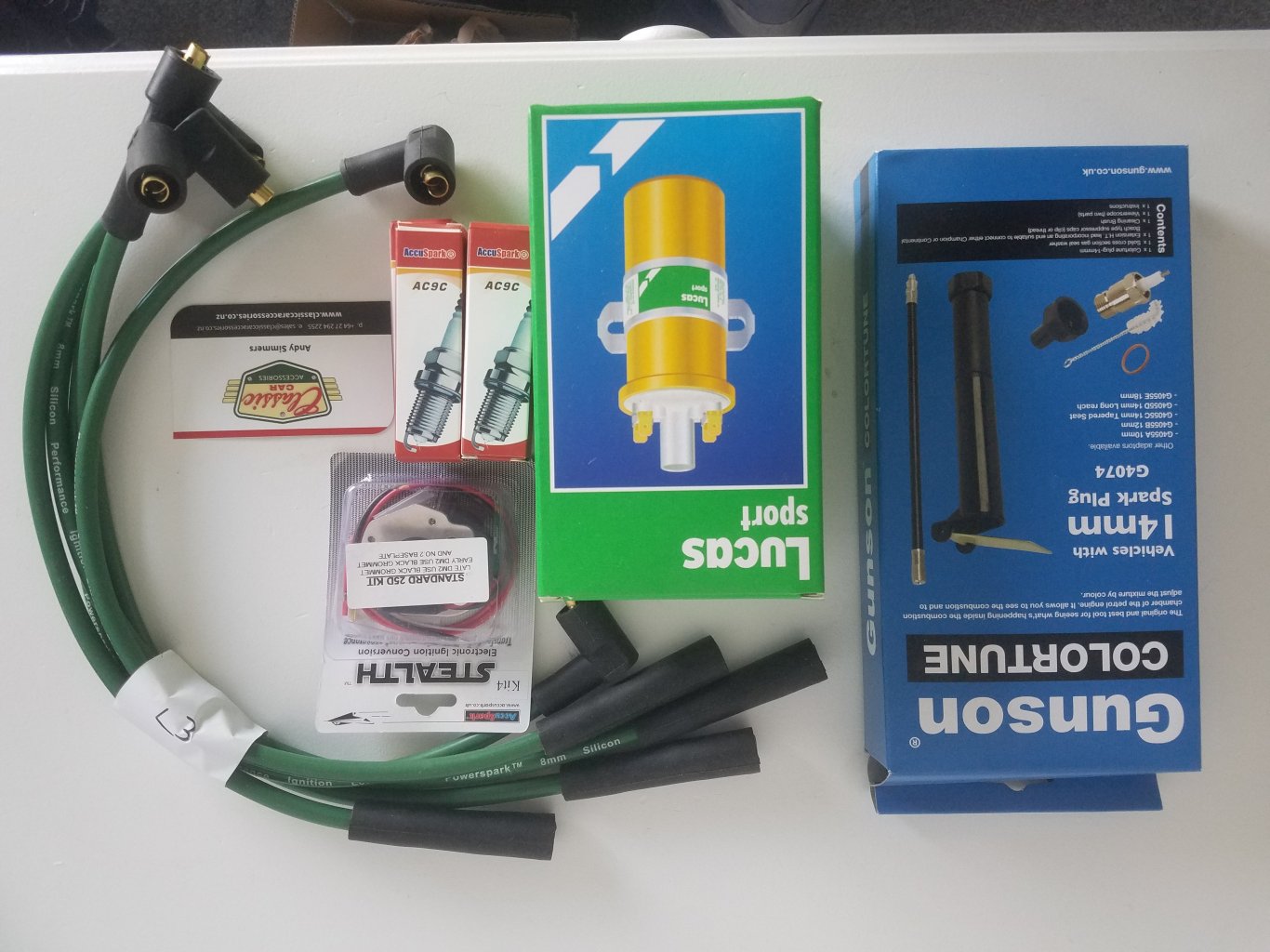

shizzl Posted August 21, 2019 Author Report Share Posted August 21, 2019 Getting more bang for my buck All parts from classic car parts in wanaka except the colortune. 7 Quote Link to comment Share on other sites More sharing options...

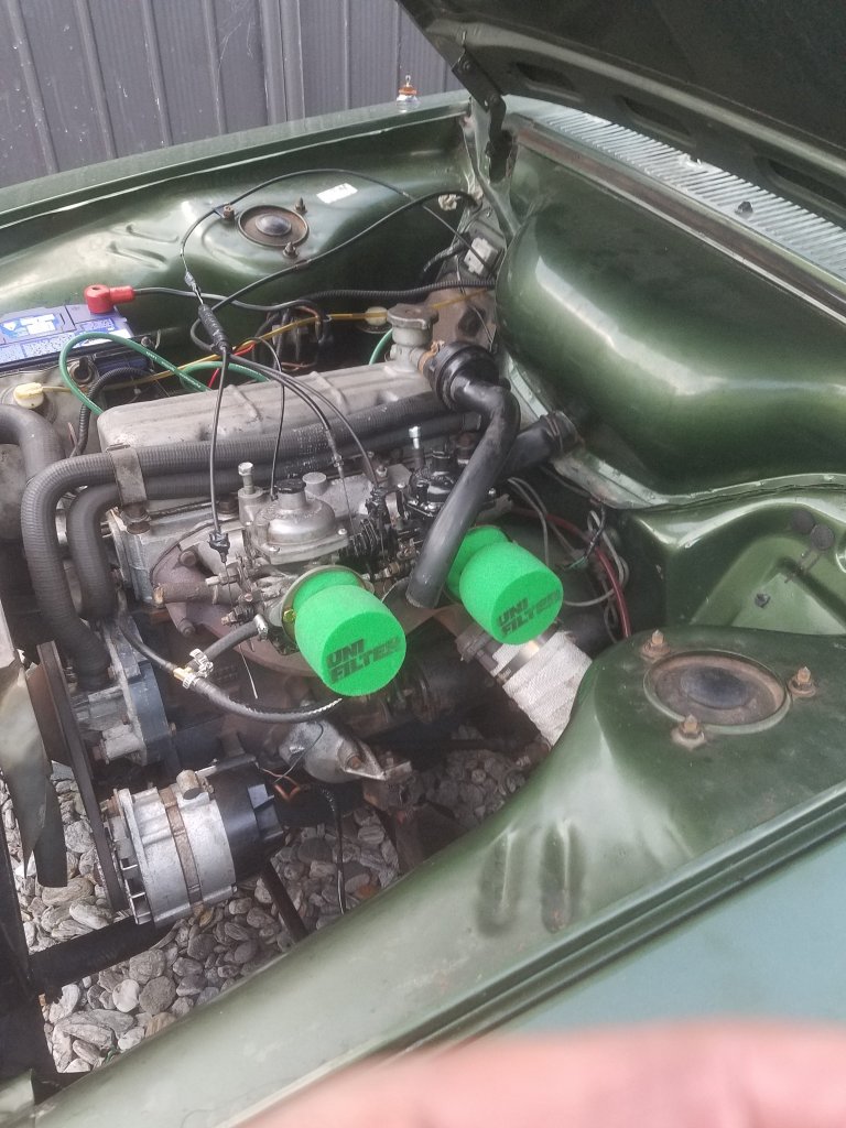

shizzl Posted August 27, 2019 Author Report Share Posted August 27, 2019 Finally finished off the twin carb set up. I made/modified the twin choke cable. Picked up a gyro splitter from a bike shop, pulled it apart and e,tended the tube for more throw, replaced the cables and outers and attached it to the stock cable and carbs... I do have a second w clip now to hold the cables to the carbs if the tape fails.. Then the second airbox finally turned up so I pulled the factory trumpet/ram tube out and mounted it to the carb with shorter bolts, fitted the unfilter socks and boom.. complete. I do want to order a different profile needle for the carbs. But that's all for now.. Just gonna send it 8 Quote Link to comment Share on other sites More sharing options...

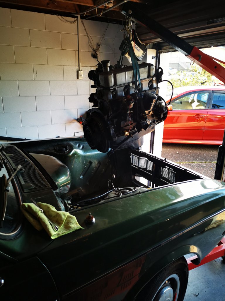

Popular Post shizzl Posted August 2, 2020 Author Popular Post Report Share Posted August 2, 2020 It's happening. Engine will need to be stripped and rebuilt.. Its a 12a bridgeport. S1 5 speed for more than 100kph of fun. Would love to do a diff swap to something stronger but that's way too much $$ right now. Also plan to upgrade to escort calipers with the spacer kit and capri vented discs 8 2 Quote Link to comment Share on other sites More sharing options...

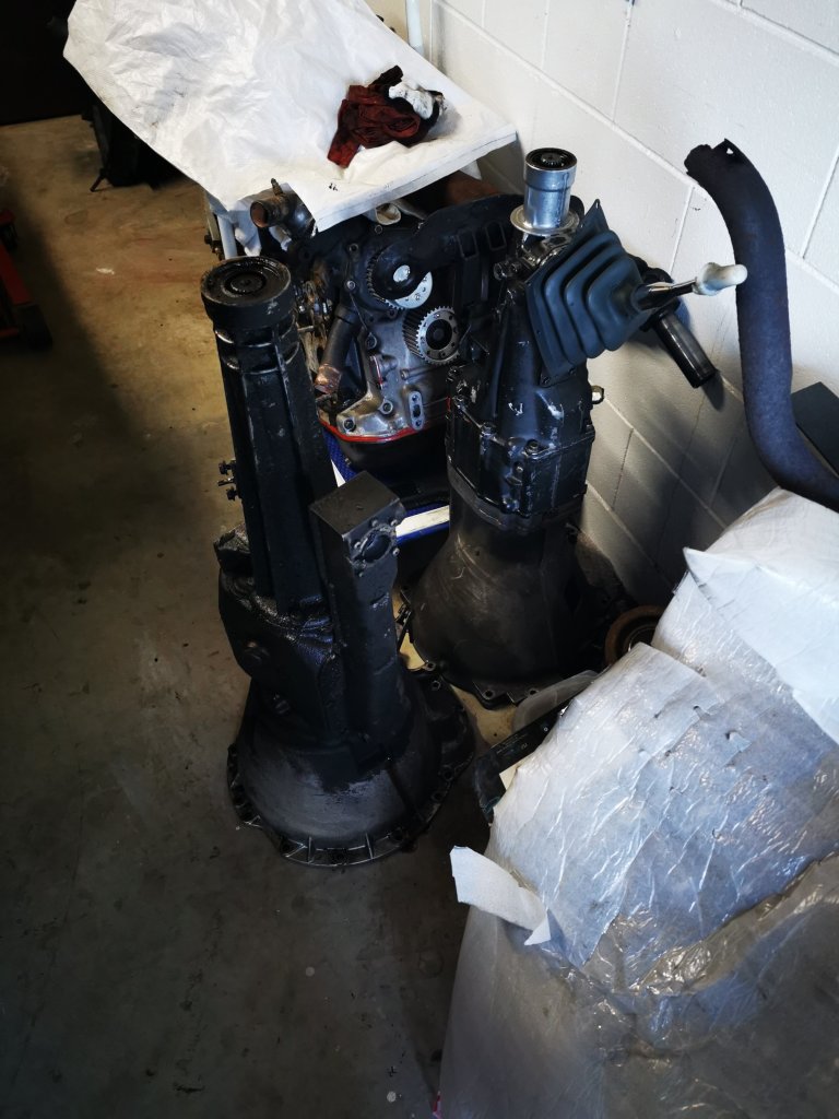

Popular Post shizzl Posted September 11, 2020 Author Popular Post Report Share Posted September 11, 2020 The hunter box is longer than the rx7 box. Shifter and box mounts are in very similar positions. Hunter box is taller due to the shifter rail.. Looking good for throwing in the hole 17 Quote Link to comment Share on other sites More sharing options...
