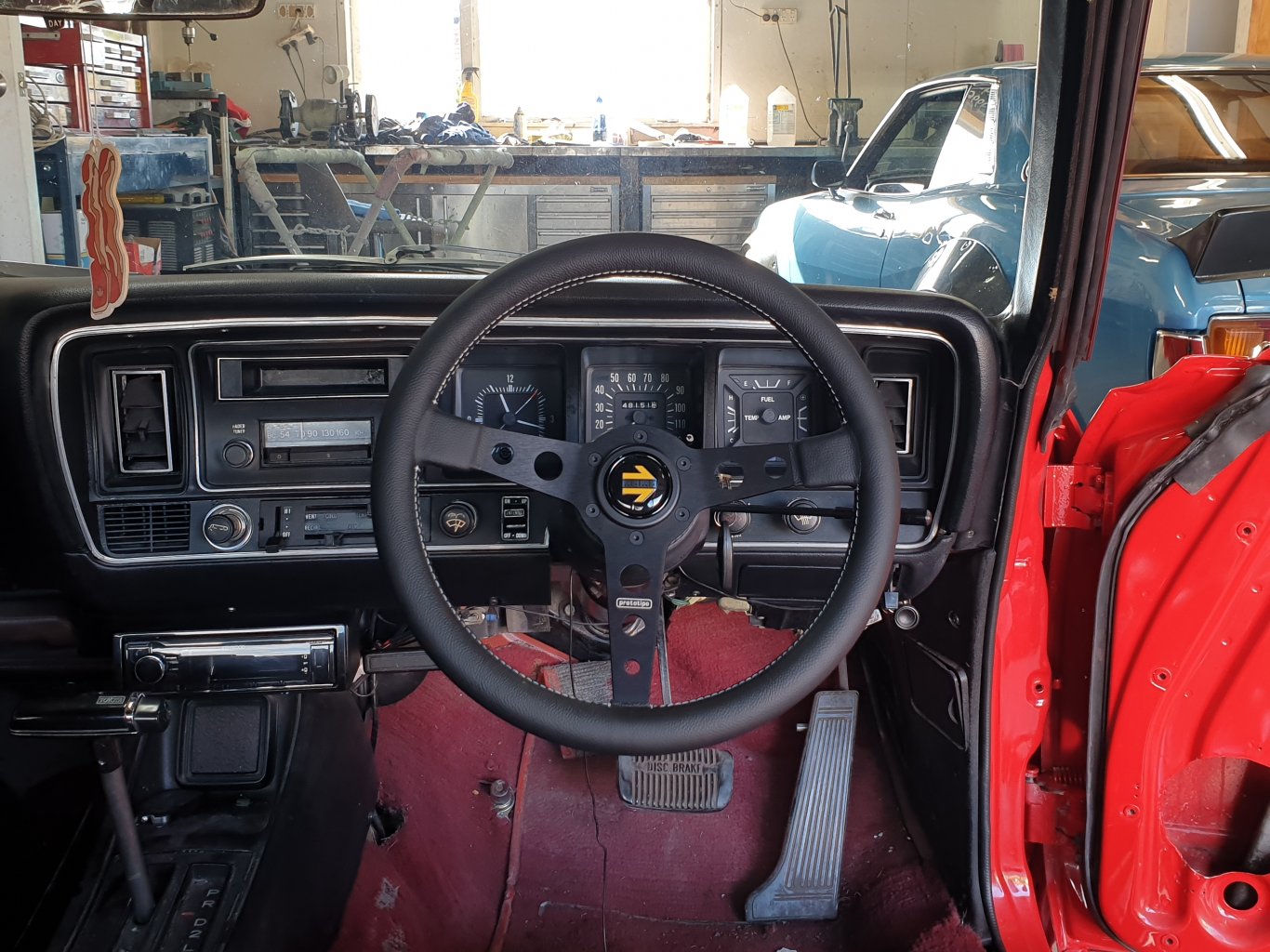

sheepers Posted March 27, 2021 Author Posted March 27, 2021 Bought a momo steering wheel for it. I am actually in love with it. Also I'm posting this from my spa pool. Quote

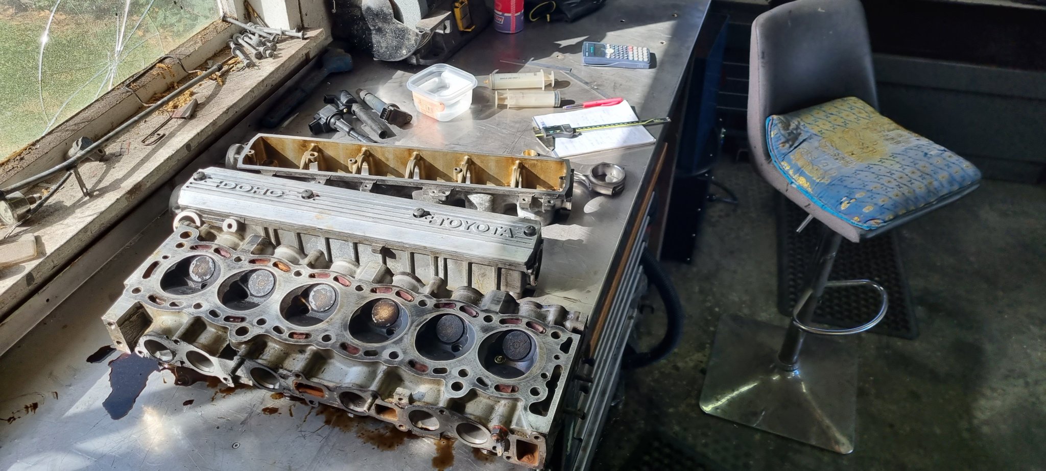

sheepers Posted February 4, 2022 Author Posted February 4, 2022 So. Having already built a 5MG in the late 90s I already know how fucking garbage they are. What the hell am I doing? The engine gearbox combo in this car is pretty rubbish. A stock 4M coupled with a slush box is pretty awful at the best of times. However this trans has really tall gearing which is great for crusing on the motorway but it's literally dangerously slow when you're trying to pull out of a side road or something. I was thinking about engines for this car and hadn't really come up with anything that I liked, then Brendan told me about a bunch of 7M turbo motor stuff he was getting rid of. Around about the same time I went down to Yowzer's place to get something and we got yarning about a 5MG that he was going to chuck out. So Brendan dumped his 7M garbage in my shed and I bought the 5MG head off Yowzer. My plan is to build what is effectively a 6M. 3 litre bottom with a 5M head. I'm going with bigger cams, bigger valves and high compression. It'll have ITBs and a cool looking exhaust. Don't get me wrong, I am well aware that this turd won't make any power but I've resigned myself to the fact that if I can't make it go fast at least I'll make it look cool. So, I have cobbled together a bunch of new parts for this thing. Major thing in missing is high compression pistons. Can't find anything as yet. I do have a new set of stock pistons which would run about 9.5 to 1 but I want to go much higher than that. So yea, this will happen over the next few months, or however long it takes. Oh, also the car will be manual with this engine. Quote

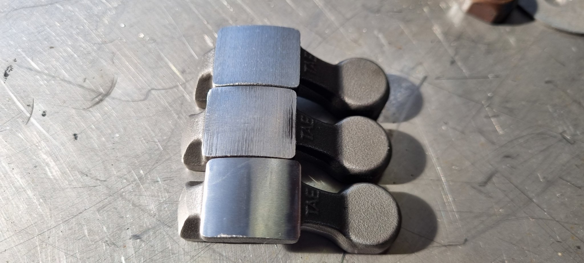

sheepers Posted February 8, 2022 Author Posted February 8, 2022 So the journey begins. I've started amassing the parts I can buy for this turd because why not. The only problem so far seems to be a complete lack of quality parts available. The only things I've been able to buy for it are pretty average TBH. I got a set of pistons for it made by ITM. They're all the same size except for the ones that aren't. ITM made lifters, surface finish is rubbish And will need polishing thus reducing the OD and allowing a drop in oil pressure in the lifter. Rockers, again, only made by one company. They're rubbish. I have to hand stone polish the cam follower face because the surface finish is so bad. In the picture the top one is as they were delivered, middle is mid polishing and bottom has all the score marks polished out Quote
sheepers Posted February 10, 2022 Author Posted February 10, 2022 Richie found me some genuine rockers on Amayama so i bought them. anyone what a set of new hand polished ITM rockers...... Quote
