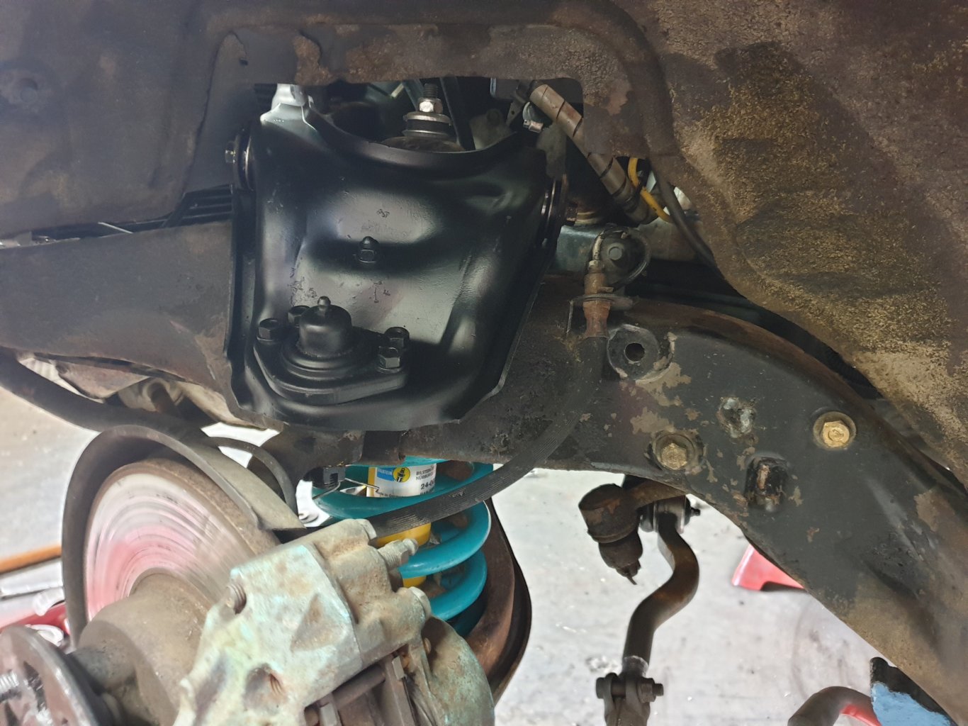

I found the details on the shocks and springs I used in this.
Front springs are Dobi front XG ute -XE V8 C19-006.   These springs can be "tuned" to height because they have two redundant coils that can be removed without changing the angle of the tail.
Front shocks are bilstein front HQ Holden 24-002899.
Rear springs are Dobi Toyota tarago 83-90 C59-045. These were reset lower by about 80mm.
Rear shocks were custom made.

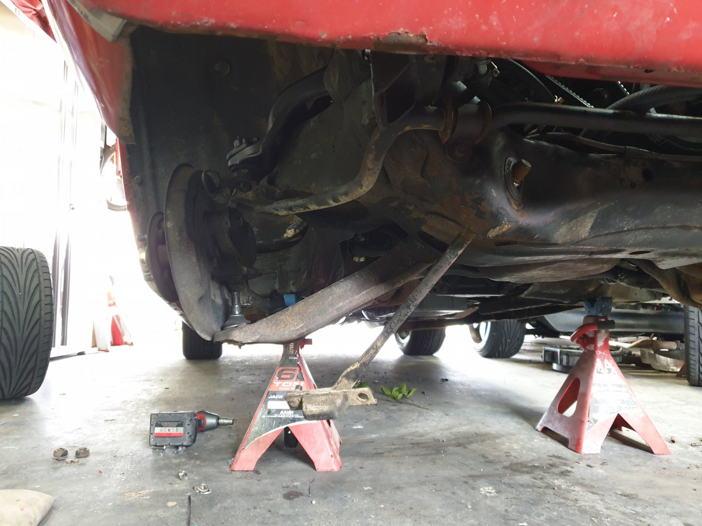

i didnt like the colour of this bolt.
i decided it was the wrong shade of red and you know when somethings gets in your head and you cant let it go? well the colour of this bolt got to me.
so i decided to take it out and repaint it.
49848082603_cb2e2bd4c8_b.jpg2020-05-03_04-47-41 by sheepers, on Flickr
