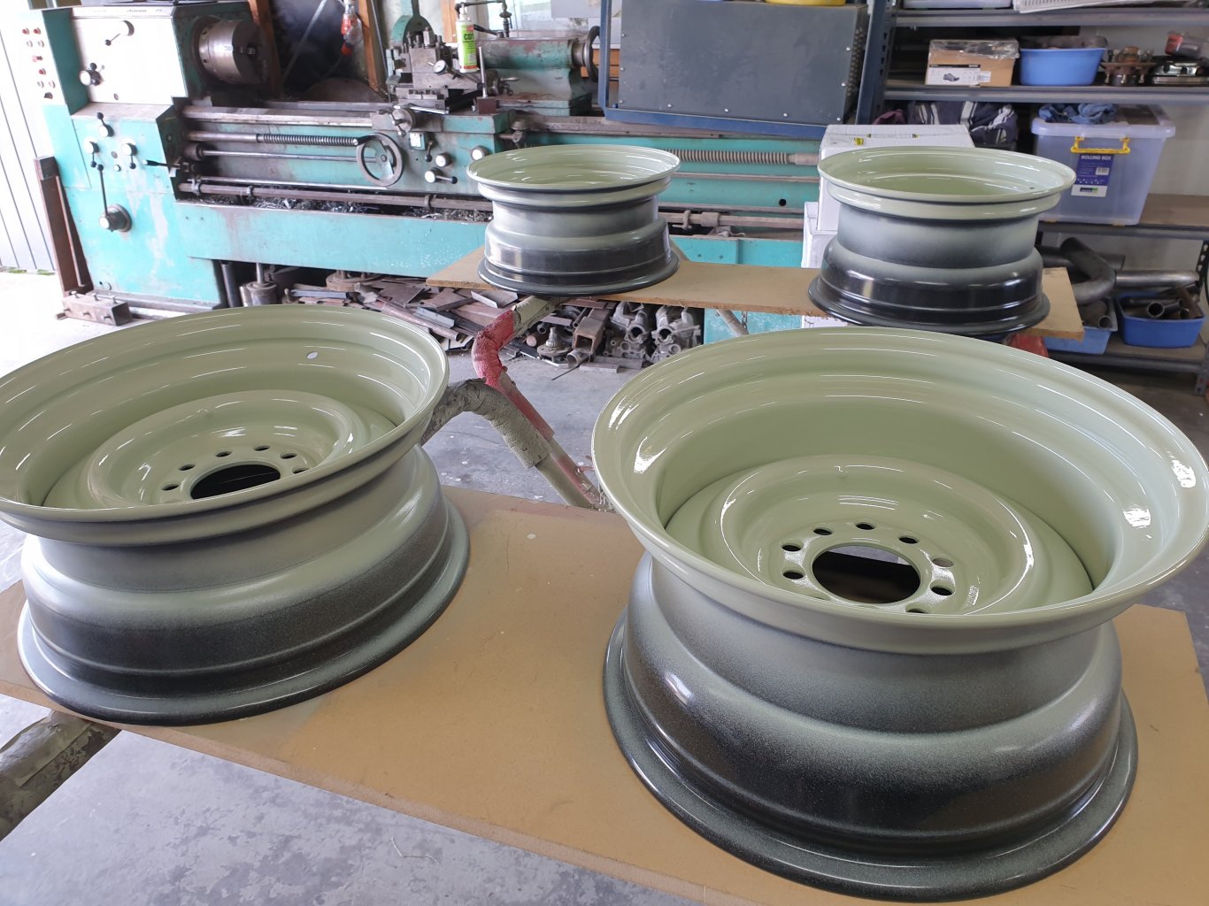

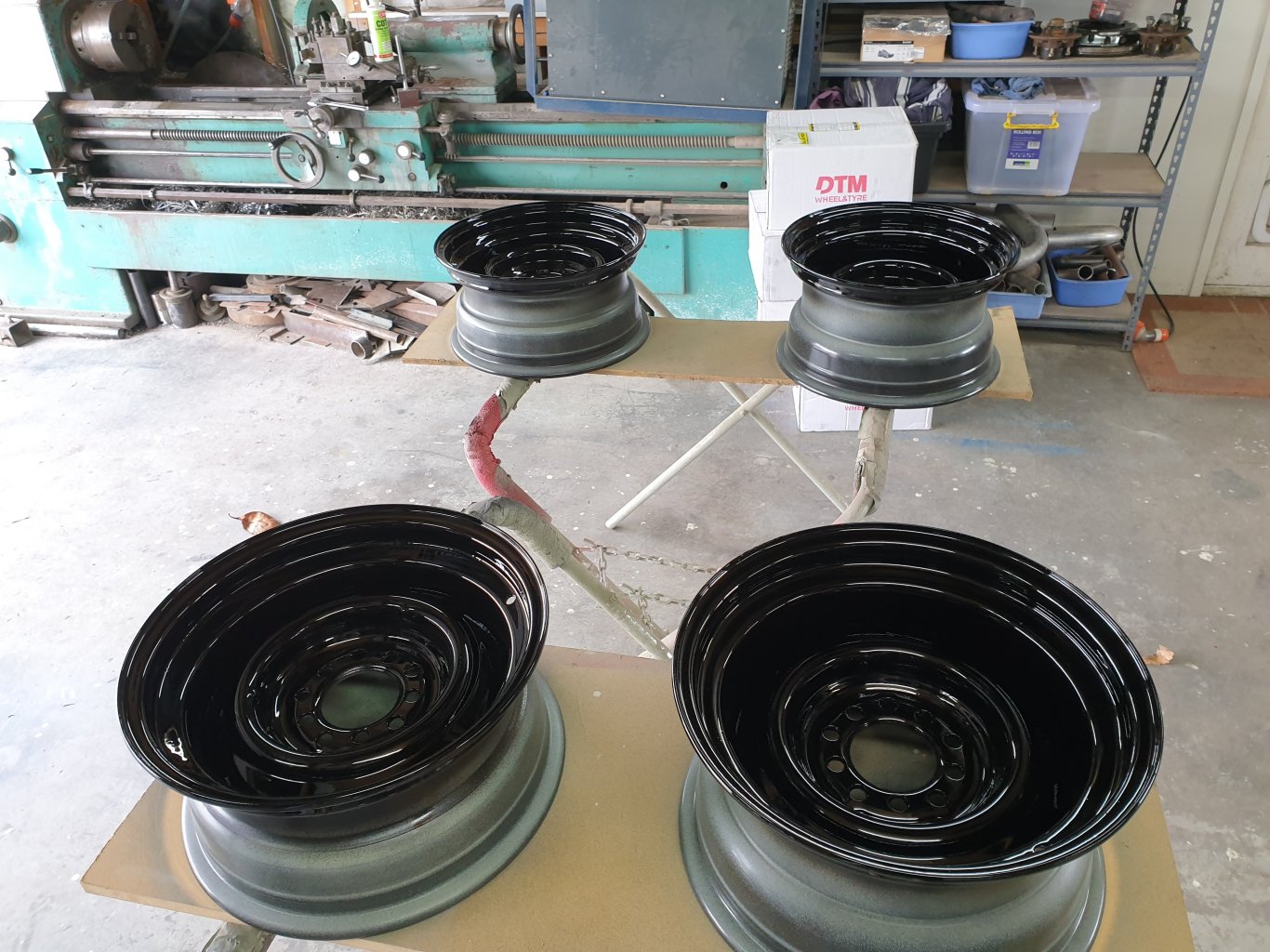

Popular Post sheepers Posted September 27, 2020 Author Popular Post Posted September 27, 2020 Wheels. They came powder coated black but I wanted a full glossy look to them so I painted them. 22 Quote
