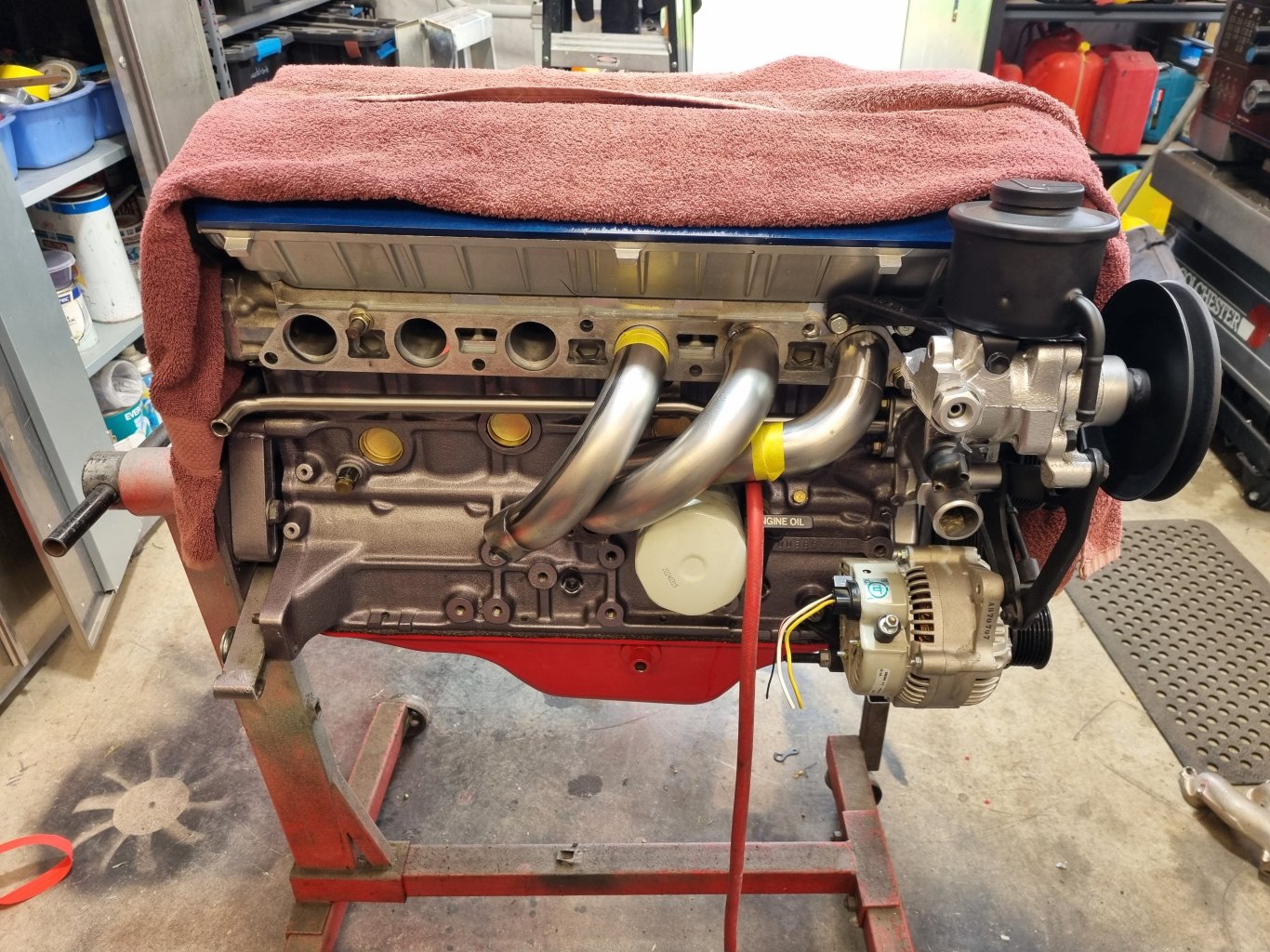

Popular Post sheepers Posted December 30, 2024 Author Popular Post Posted December 30, 2024 Righto. Did not go well. After two days I still have nothing really to show. I think I'll have to make the headders in the car because I can't guesstimate where everything is and navigate a path that works. There is just no room to spare and it's not worth making it only to have to make it again. I may even drop down a pipe size too because I'm going to have trouble getting any crush on the gasket, as well as the holes in the head are a good 4-5mm smaller than the pipe I'm currently using. I'll think about it. But yea she ain't gonna happen with the current state of affairs. 16 1 1 Quote
Popular Post sheepers Posted January 9 Author Popular Post Posted January 9 And then I had a life size jig to make pipes with. 41mm primaries and 63mm secondaries. Will attempt to run a 75mm pipe all the way to the back but we'll see if I can pull that off or not. Some idiot made the ground really close to the floor so room is a bit sparce. 28 Quote
