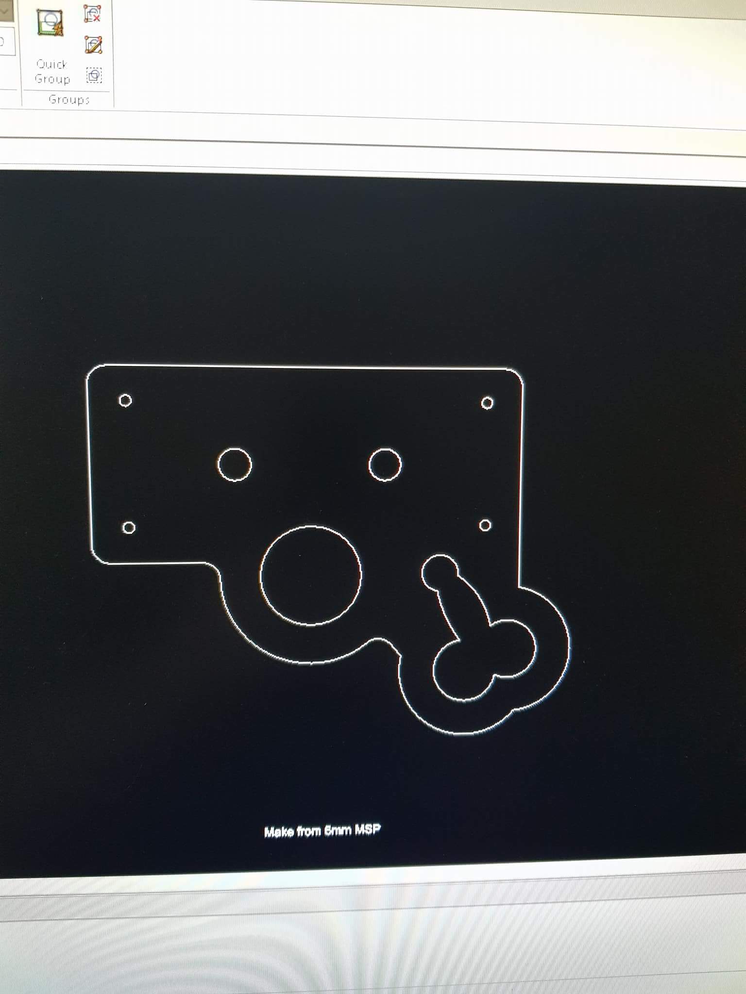

Shakotom Posted January 3, 2018 Posted January 3, 2018 @flyingbrick wanna make 2 sets of the handlebar base plates? 1 Quote
64valiant Posted January 3, 2018 Author Posted January 3, 2018 1 hour ago, Shakotom said: @flyingbrick wanna make 2 sets of the handlebar base plates? Would you like me to order you some bars while I'm at it and some holders. Quote
Popular Post flyingbrick Posted January 3, 2018 Popular Post Posted January 3, 2018 1 hour ago, Shakotom said: @flyingbrick wanna make 2 sets of the handlebar base plates? 10 5 Quote
flyingbrick Posted January 3, 2018 Posted January 3, 2018 @Shakotom might be best to get greg to order you the same risers and stuff so that the plate fits them nicely. Greg has mentioned putting on a bottle opener.. great idea! Ill add that tomorrow 1 Quote
flyingbrick Posted January 3, 2018 Posted January 3, 2018 Added a bottle opener and bought the bars back a bit. Will make a card template to check the opener has clearance to work as intended . 7 Quote

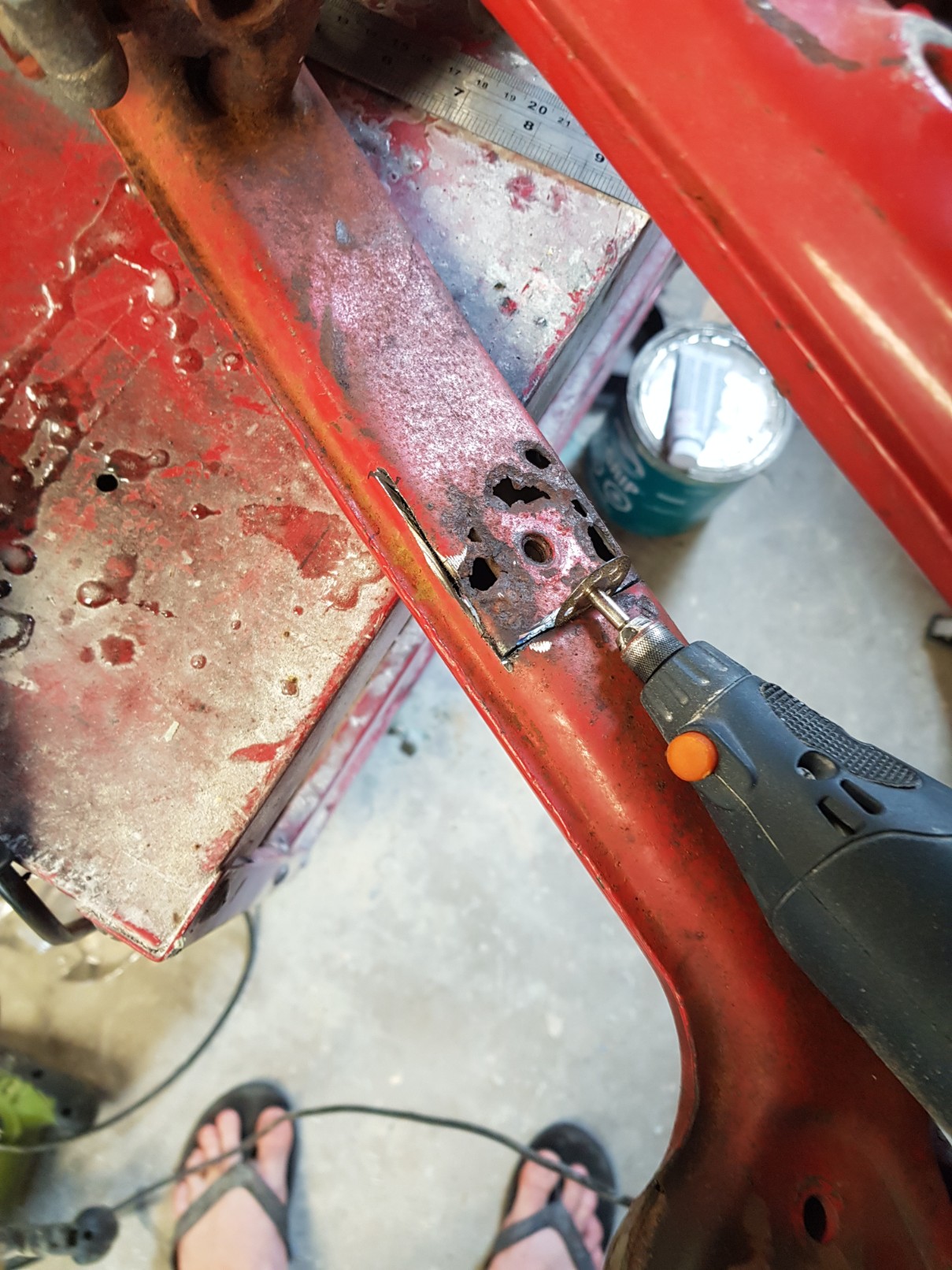

flyingbrick Posted January 3, 2018 Posted January 3, 2018 Greg's forks have two apparant problems - rust and a lack of symetry. I will repair the rust first and then align the lower bolt holes with a long pin to make sure it's an correct before/after straightening. And working on the first patch piece. Nice thick 1.2mm steel 2 Quote

flyingbrick Posted January 6, 2018 Posted January 6, 2018 I spent a few hours out on this today. First I made that first piece fit. I cut out this So that I could fit this. new steel wasn't quite large enough to replace all the shit (bit by my thumb on the seam) but will deal with that later. I zapped that in and moved to the other side, I cut this out, And then realized that now was a good time to straighten the bend at the bottom. I don't have many good pics but the outside face had been in a pretty good impact and was concave rather than flat and this impact had tweaked the whole end in. (this should be parallel to the end and the seam straight) So both sides (now not attached to one another) were straightened and everything was measured over and over using bits of wood and verniers (to check overall widths) And that's as far as I've managed to get. 7 Quote
