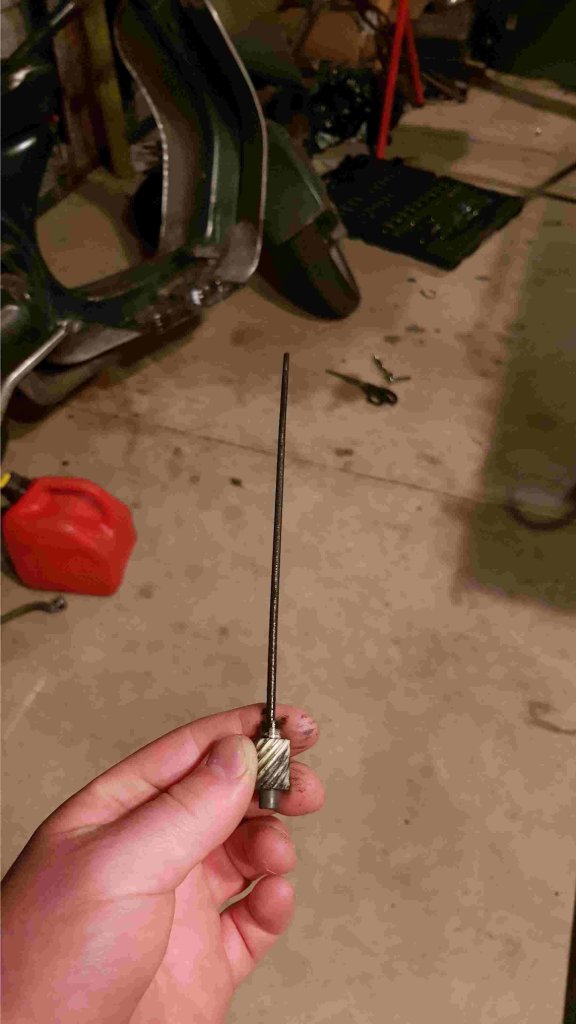

64valiant Posted October 22, 2018 Author Posted October 22, 2018 Erm found out why my speedo stopped working. It seems to have snapped in the kink down by the wheel which wasn't so helpful. But hopefully have a new gear set for it and a new cable this week. The hole fuel pissing down the back wheel I'll have a closer look and see where its leaking from in the light. It's coming from some where in the carb set up. Enough to make a little Leake but not enough for it to piss everywhere like my needle is stuck open. Or is it..... Quote

64valiant Posted October 25, 2018 Author Posted October 25, 2018 Yea we even added all of the grease. Turns out you googled it and looks like my worm gear is fucked. New one on the way. Quote

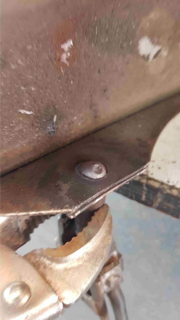

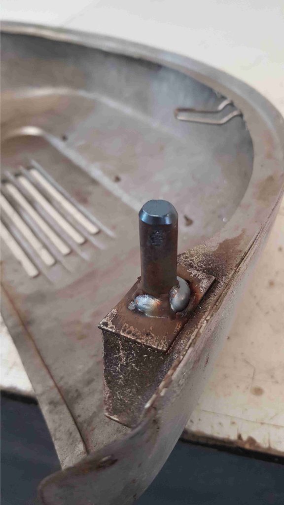

64valiant Posted October 29, 2018 Author Posted October 29, 2018 I checked my assorted bolts and cut one down to make the pin for the engine cover. Dont think this one is going to fall off now with my erratic riding and driving if it's on the back of a ute/car for some unknown reason. Had to get the radiator fixed in the Subaru and had to get to an appointment so quickly fixed it and on my way again. I drilled through the panel and plug welded it as previously it didn't have much holding it in. I used a 5mm drill bit to begin with drilling it out and that was the size of the weld/join that was holding the old knob on. Ended up stepping it up to a 7mm size hole to get right in there. Might buy a push bike speedo this week and see if I can get that thing working. 2 Quote
