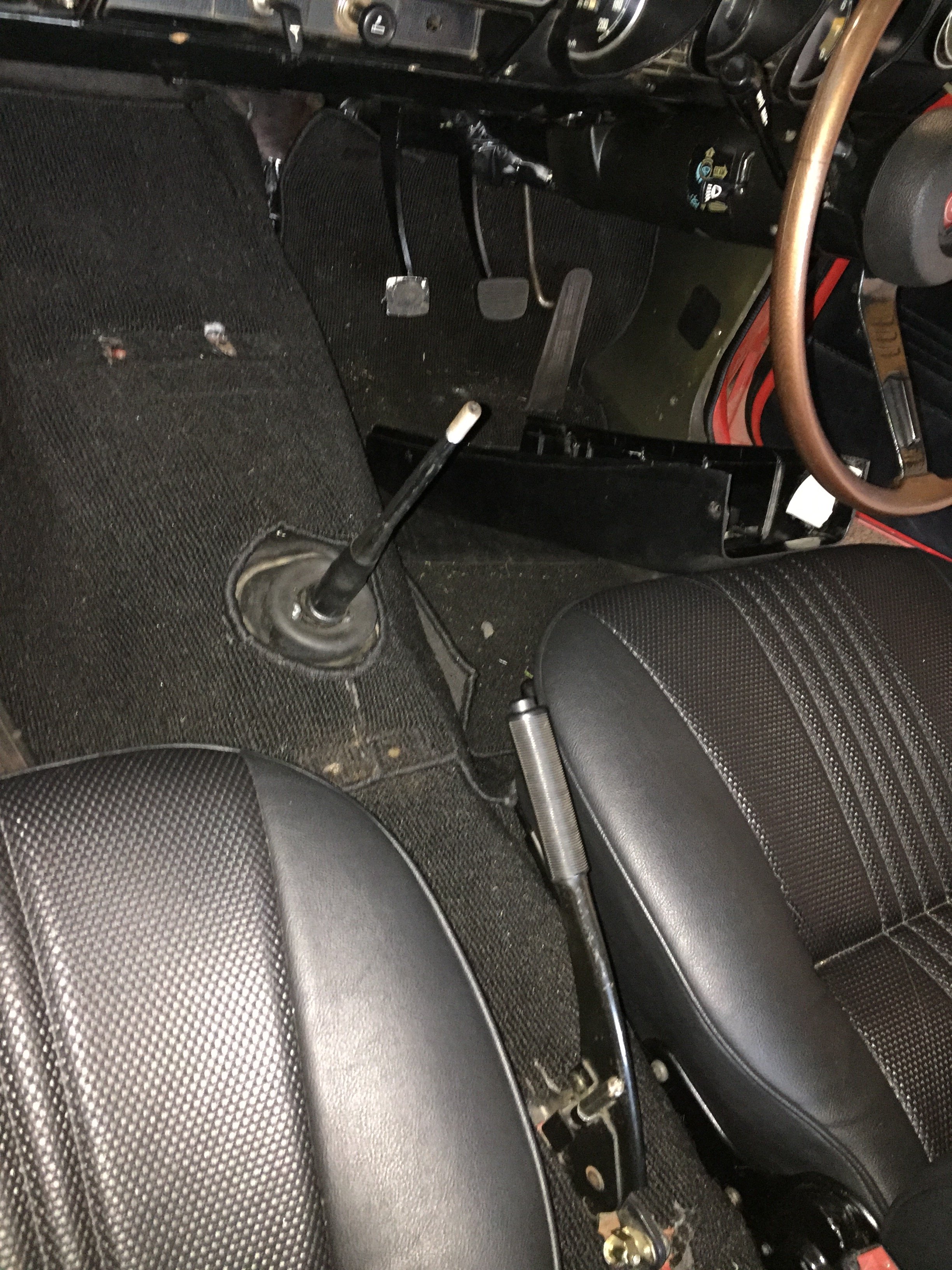

rivalrx Posted July 2, 2019 Author Posted July 2, 2019 So here is one hell of an update for y’all.... Clint came over for the final cert check this morning and it passed! I’m now awaiting the cert plate (up to 10 working days) then it’s back to compliance for the plates. Hope to be legal for the Burger King meet on the 13th. beer o’clock oh - small update...cut up the original gear stick and welded it to the rude short shift stick. It now shifts a lot smoother. I will cut and rethread it by like 5cm to be at the perfect length. 5 Quote
