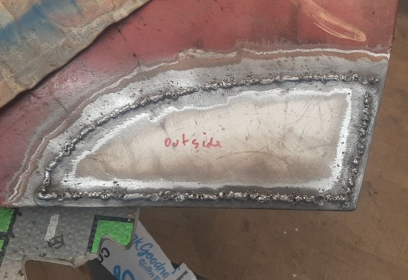

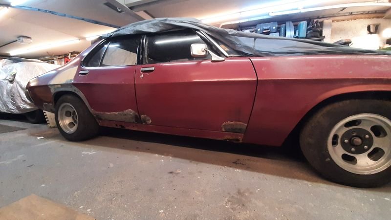

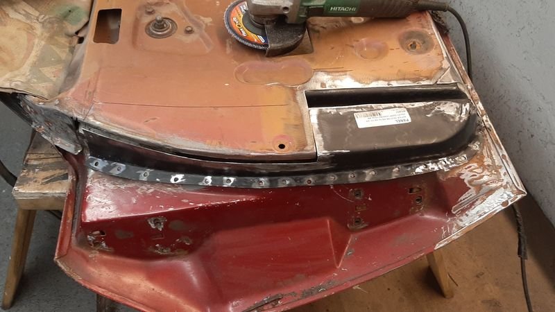

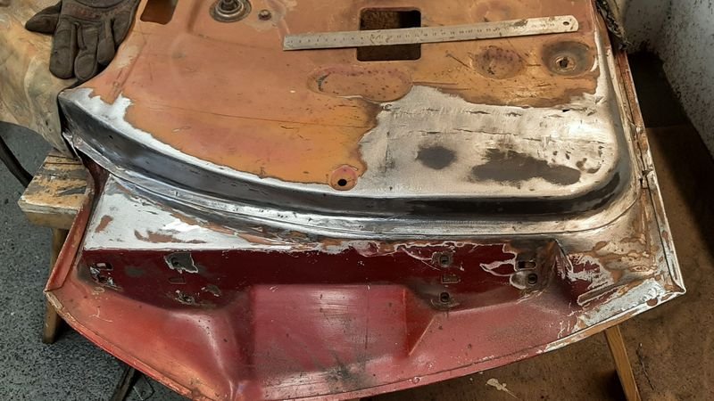

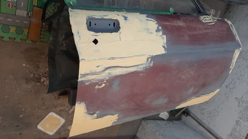

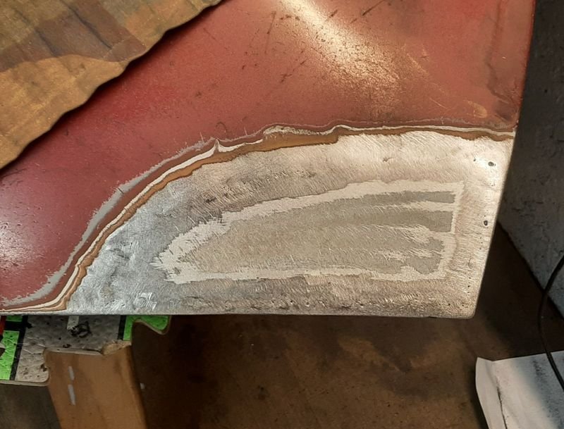

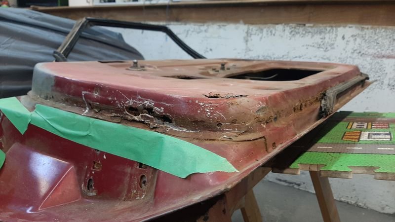

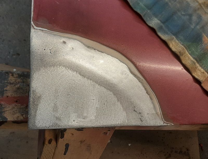

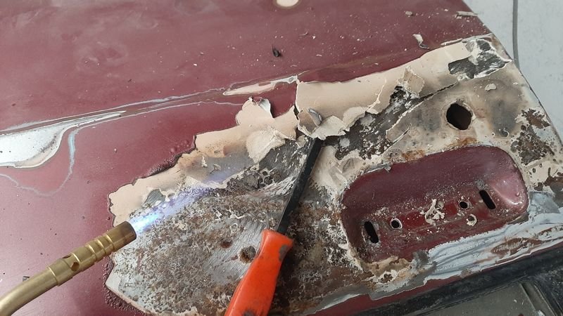

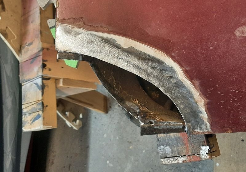

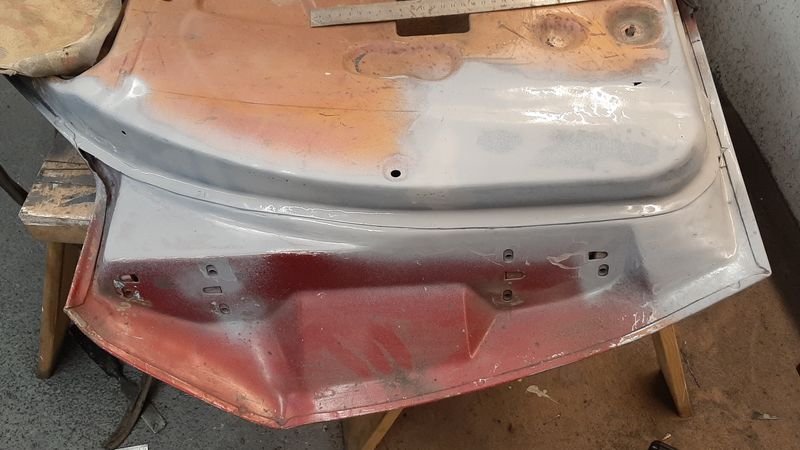

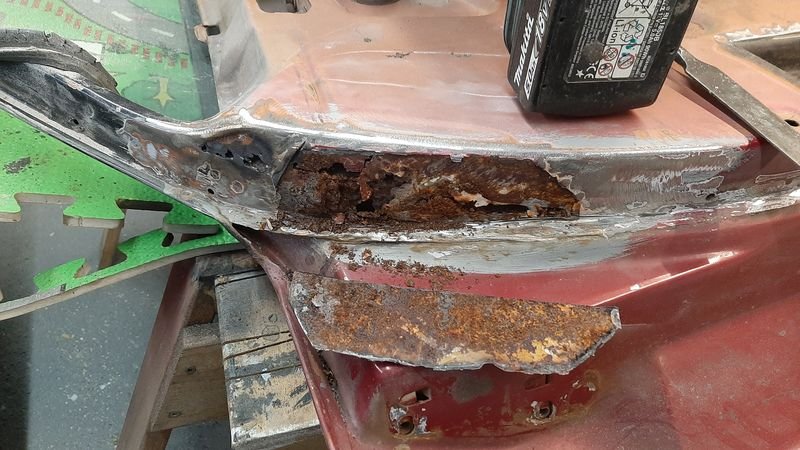

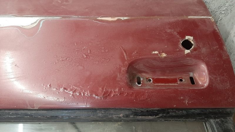

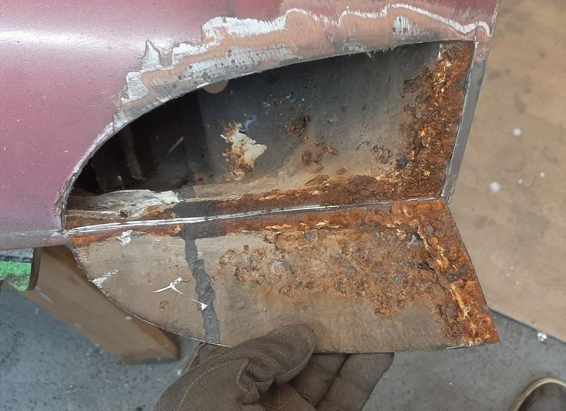

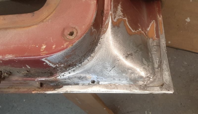

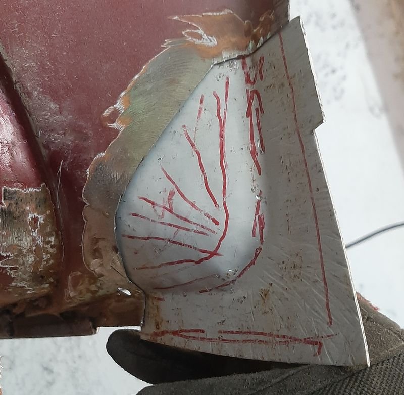

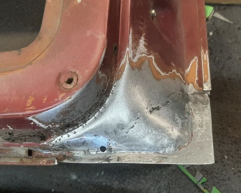

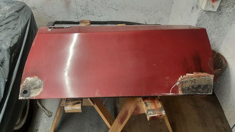

Making a start on the Drivers side rust Starting with the Drivers door. I was thinking it was the best of the 4 doors based on the limited amount of rust that popped though on the outside and all it needed was a couple patches in the outer skin, but jokes on me it turned into a bit of a mission. Took this one off to fix (instead of leaving it on the car) because the hinges are worn out too. Starting with the rear corner. Chop Chop back to good metal bish bash bosh - the annoying hole in my firewood chopping block came in pretty handy for forming this piece, and it turned out pretty good zip zap it in Front side Edges dressed over and tidied up Then the front Corner Crunchy! Left a bit of the outer edge to avoid messing up the door gaps etc. Lots of spitting welds from the rust despite my best efforts to dig it out. Ill be filling the doors with wax etc eventually, it wont last forever but hopefully wont need to dig in again in my lifetime. Next step: The inner leading edge that holds the door rubbers. Its pretty bad and theres a suspicious looking repair at the base of the window. This old primer and bog is hiding something... YUM! An old patch tacked over rust. Ended up chopping a fair bit out, not just the rust but to gain access to the inner skin, as that needed repair too. Patch job was done - while it cant be seen it still needed to be flush for plug welding the outer over it, and strong as its a pretty structural part of the door. At this point I didn't even try to form the edge and bought an 'front door inner repair section' which turned up in two days (its pretty much cheating!) Chopped most of it off except the bits i needed Filled in the missing bits the panel didn't cover and smoothed it out Then chucked some primer over it to show up all the imperfections again! Then flipped it over to address the cracking paint shituation around the door handle. Obviously something is going on under the paint so its all got to come off Little bit of heat to soften up the bog and it just slides off revealing the horrors beneath Did what i could to remove the surface rust and straighten it out, but there is no real access to get a dolly or a hammer in there to dress the metal so it is what it is. You can see the door below the body crease has a generous layer of icing too that im just going to ignore as its not cracking or whatever and has been fine for 30 years So that's all the rust on this door, just need to put a pile of wob back in to build the area i removed it back up to match the rest of the door

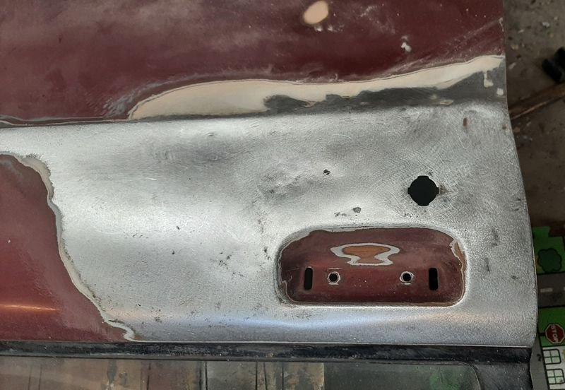

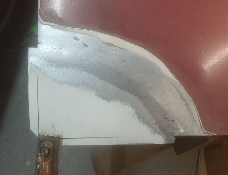

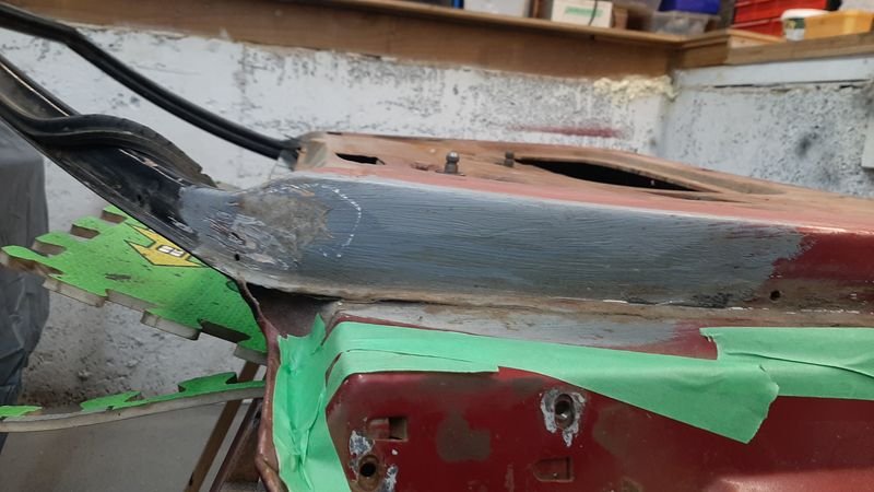

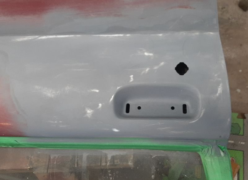

With the front end all together, time to put the front back on BUT! Gotta tidy the all the panels up and fix some rust first Used my first patch panel on the drivers fender, its a bit more extensive than the passenger side Still had to make the inside bit which i did before chopping the outer away to give me something to built to This fender is a replacement, the blue is its original colour. And ready for some hammer and dolly action before filling it with more filler than i would have liked, (i rushed the welding and it sunk a bit), but as its aesthetic filler, not 'structural' its still much better than it was. This weird bit on the top of the passenger door too, seems like the door channel dribbled water to collect into that spot or something, managed to cut right across the hole for the door seal clip thing so had to build half a hole into the patch panel, and the grommet thing popped right back Then time for some paint. Its been looking worse rather than better. How it started, just after we got it running for the first time and cleaned it in the driveway: How its going - immobile, exploded across the garage in 1000 bits and looking like shit. Masked up and the 1k lacquer base we got 'matched' and then some clear. Didnt turn out particularly great especially this first go (i needed more paint flow out of the gun, and i also should have put a coat of 2k hig build primer on to seal the filler an), but neither is the current paint, i dont want to hide anything either, its mainly to seal everything and put things back to no worse than before. The whole car really needs the paint taken right back and redone anyway, which may happen eventually, but not now. As you can tell that rear quarter panel is now better than it was, but still a bit wavey. Thats fine - not really prepped the front half of the panel at all, it still needs around the wheel arch and dog leg cut out and patch panels welded in, so on the front half the paint was just to seal it all up and get it one colour again, The rear 600mm of the back end is all good tho, so we also put the tidied up bumper and lights etc back on, which also covers up 50% of the new paint anyway, so that 'side' (the back end) is DUN as far as panel work etc goes. Front panels got spot painted too, and went on much better than they came off! i suspect the last time these were bolted on they were thrown on and bolts cranked down, not adjusted at all, same goes for the doors so pretty happy that some time spent loosening bolts is working out nicely. Will make it much easier doing the sills and scuttle (eventually) with everything else in the right spot The nose cone i dint paint as i knew this needed some more yanking, hammering and filler work to line up with the fenders nicely, but only doable once the fenders were back on and adjusted to the adjusted doors etc This nose panel is a cut and shut from a yellow one and a blue one joined though the drivers headlight bucket. That all needed about 3mm of filler to get it lining up to the fender and bonnet, whcih was a fair bit less than what came out of the same spot then i took it off. (re) learned my lesson from the rear and entirely primed it properly first Then upped the thinner to increase flow so got a thicker base and lots of clear. Turned out much better, but the colour mismatch is a bit more obvious too, nice colour, but not quite as pink/mauve as the (dusty!) bonnet which is also back on) Grille and buckets in and front bumper - had to give it a tweak in the press to close up the 'V' a bit more/push out the centre point. Its not not perfect, (you can see the bumper is almost touching the grill in the centre but less towards the sides) but much better than it was, and apart from needing to take the outer fenders off when doing the sills eventually, the front end is all done too. Back together and on the ground Body work on this side is done* (for now). *'Only' the entire sill below the doors that needs doing, oh and the other side... Anyway very much looking forwards getting it outside and giving it another wash, cleaning out the shop and to being a passenger when we turn it around to do the other side
