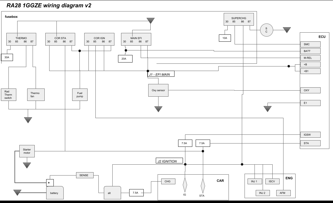

It was the 7.5a fuse. finally tracked down my fuse box lid with the diagram on it, and although i had checked all the fuses. it was located in a separate stack of fuses that i thought were spares.... dumbass. runs good now!

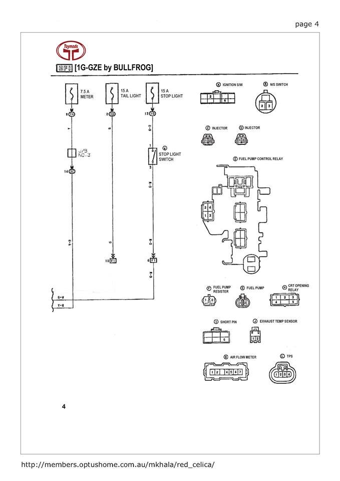

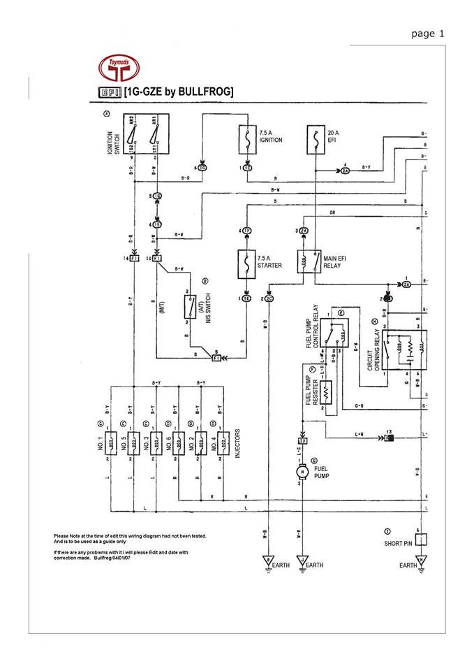

youre right, i cant see what the starter is wired in on the above diagrams at all. it must be related to the NSW or else it would start in any gear with the auto it also looks to be that if the AFM wasn't plugged in, the circuit opening relay wouldn't operate. something else ill double check i plugged in/is seated correctly. i definitely removed this for another reason

also - ignore that last diagram, that apears to be just a bare bones wireup of an ra28
ive had it hooked up to a grunty (will start 5.7 hemi dodge ram with no battery fitted) jump starter. but i dont even hear the starter relay click when i turn the key. are you sure the acc circuit gets power when the key is turned to start? ive even left the auto shifter pluged in, perhaps just that 7.5a fuse has blown. ill double check the wiring around the shifter though

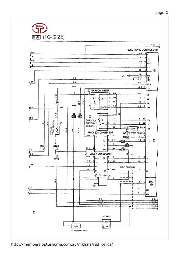

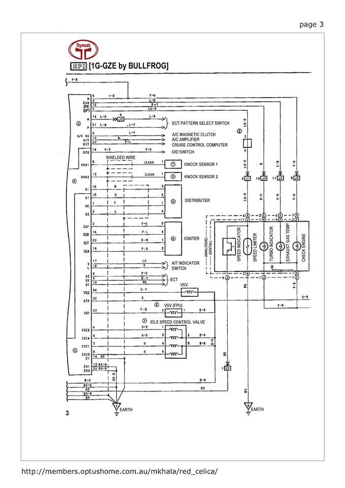

Hello OS collective, I once again have underestimated something. i got my modified driveshaft back today, and as per usual, only yesterday decided id see if the engine would want to start after the manual swap. inevitably, it did not, No problem i thought, probably just needs the ecu to be told its in park, as none of the gear position lights had lit up. Today i went over the auto trans with a multi meter and found what pins were connected when in park. jammed some paperclips in the corresponding plugs and had "P" show up on the dash. still no cranking. doesnt sound like the fuel pump primes, but i cant remember if i could hear this before or not. i dont hear the starter relay click, but the radio ect does turn off when i turn the key to start. Does anyone know what needs to be done to get a 1ggze to start after the auto has been removed? cheers!
