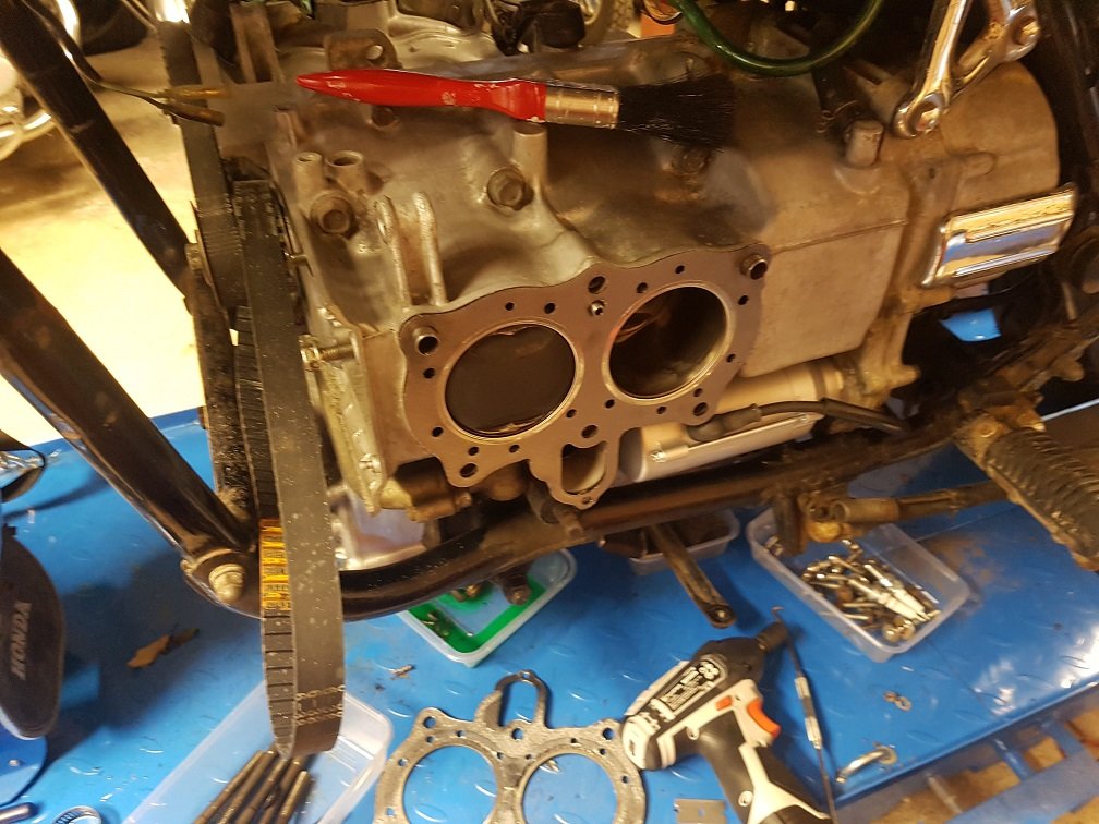

Just when I though the mechanical gods were cutting me some slack with the local seals, I went to reassemble the rocker assembly only to find out why this head was in the parts bin. The thread was completely stripped on one of the bolts. One with a dowel no less. Yay. Things ground to a halt, as I didn't have any helicoils. Bike night Tuesdays are great. And the infamous Seedy Al turned up: With one of these: Ooosh, M8x1.25 here we come. A quick helicoil and we were back together Gaskets on (Its so happy!): Head on Timing belts are brand spankers even though they look old. Just got a bit filthy from the trip plus engine disassembly and cleaning. Believe it or not, I am cleaning it up as I go. The engine was filthy, and the paint has come off in places and the alloy is stained dark. So can never get it looking mint without a spraybomb. Orders of magnitude better than what it was though. The engine even does a complete 720 degrees without binding. So I must have done something right? Just need to set the valves then the covers can go back on. Tonights job.
