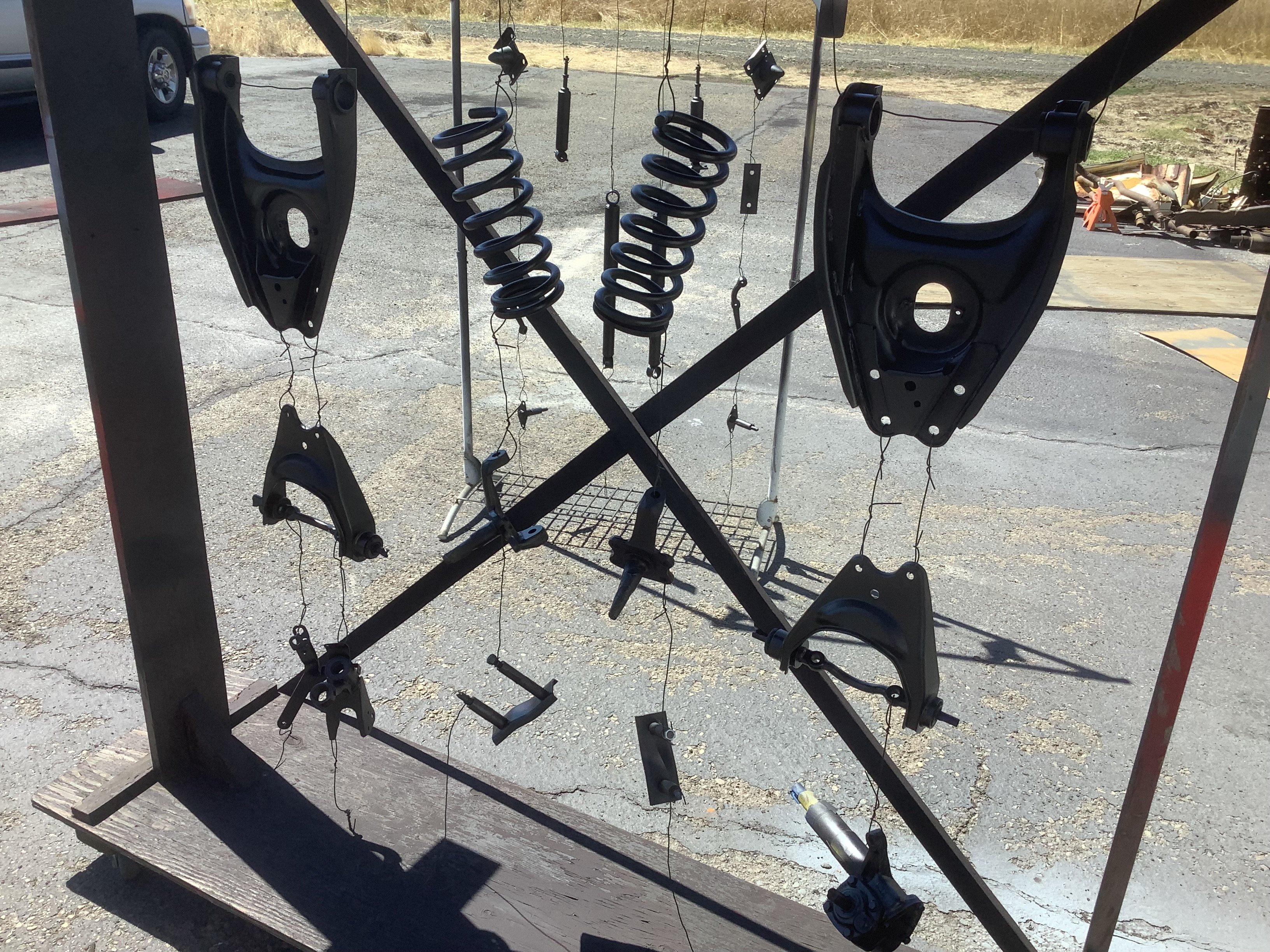

So 2 years later I’m back to this KEI as I have wrapped up my Dodge Colt (mits galant) wagon restoration. Got it disassembled and everything inventoried and assessed. It’s going to need a fair bit of rust repairs but I’m game. Got the ball rolling by sandblasting and painting these parts. Plan is to have it completed next summer.
