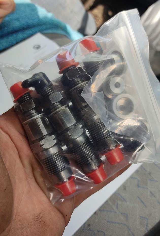

    Also She's a bit fucked there Jim. Meant to be 160psi opening, best was closer to 130psi, worst was a good bit less and dribbly + shit spray patterns all around. Won't skip injector servicing again!!

    Yeap I'm blaming the injectors for sure, I've been putting off getting them serviced for years and have put likely well over 200,000k on them and I've got no idea if the previous NZ owner ever got them done either. Had been getting a hot smell when climbing big hills (hot hot not coolant hot) for months now which I'd been blaming on my 3" exhaust being a bit close to something, that with the dump pipe cracking all the time makes me now think the EGTs were getting way up there + the Mrs pointed out we'd been noticing more black smoke for a while too. Dropping the injectors off to Ireland diesel this morning for rebuild with genuine Denso parts and yeah have a Kiwi head kit here ready to go on, came with a thick grade 5 gasket so once I measure piston height I might end up getting @GuyWithAviators to send down a genuine grade 3.
