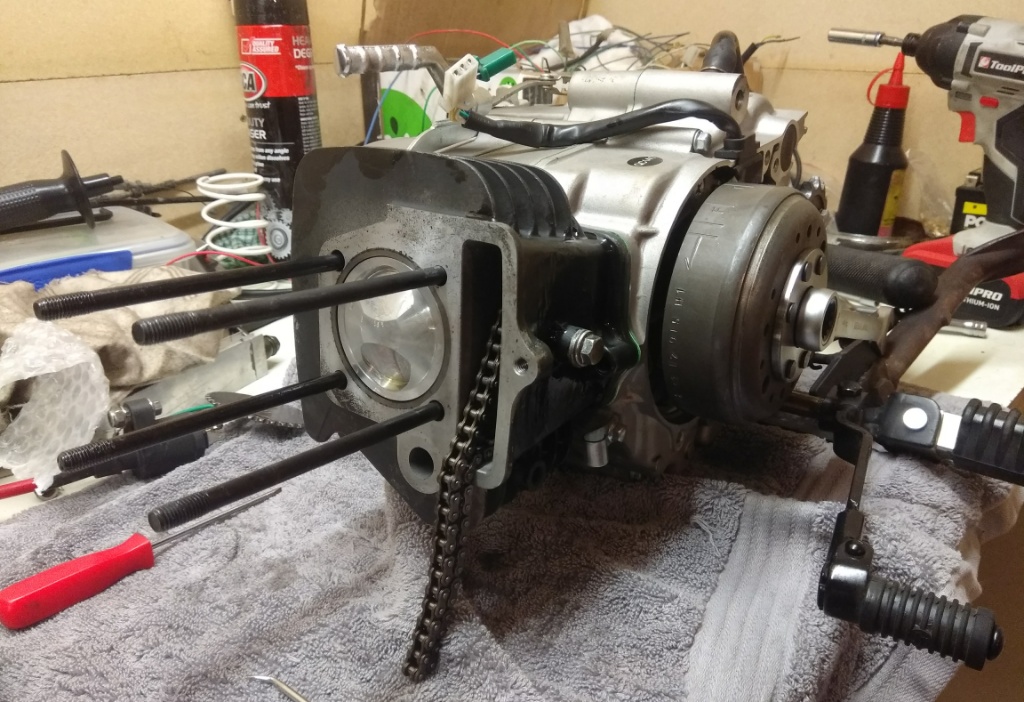

Set the tappets, chucked a new plug in and took it for a ride today. 165mj is pretty much spot on at WOT, has gained so much power right through the rev range with this top end, have to lean hard forward to keep the front down in second lol But after maybe 10 minutes running around it started developing a rather annoying misfire through the mid range FFS.
Took it for a ride, 155 main jet, 20 pilot, shit it hauls! Wheelies so damn easily it's a handful! Cracked the head pipe, that put an end to the ride. Running a bit lean up top with the 155 in it though, can hear and feel it's happier at 3/4 throttle than WOT. Chucked a 165mj in, should be pretty much spot on I'm thinking, will find out tomorrow.

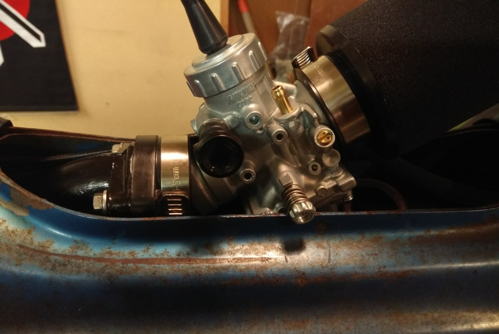

I'm running a 24mm on my 70+cc Gyro, it's about perfect sized for the engine. 12mm would have been such a restriction! Engine out, again. If I wound the idle hard in the carb wiggled into place, bit of hacking-I mean shaping- of the inner skin + grinding the adjustment screw right down small gave just enough clearance, 1 hole through the outer skin to let a screw driver through to adjust and it's done! SO MUCH COMPRESSION!!! I want to index the cam side cover so the "CDI" writing is level, there's a little tab that sits it where it is and this on the inside Can't see much reason I can't just put it on level?
Yeah man, I'd be thinking 28mm should be a decent size for it tbh. 19mm is way too small imo
Yeah mate the VM26 can be set up for 2t easy, Mikuni sell 2t emulsion tubes for them. Another option for less $$ is the 24mm PWK I've got sitting here waiting for a good home, you've got a lathe so it can easily become any size up to 28mm...

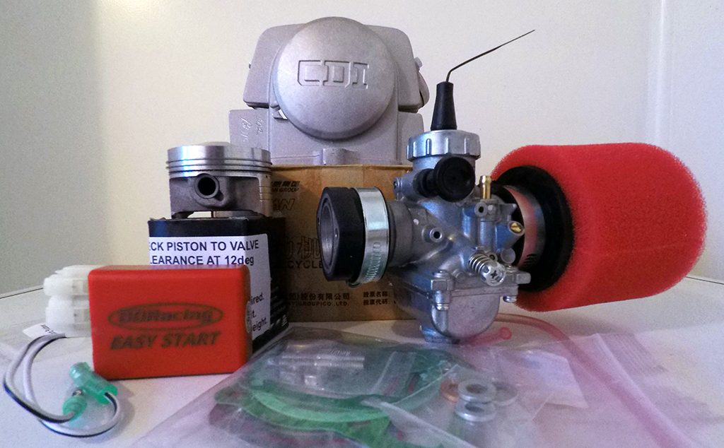

So yeah I'm bored with it already. Hopefully this lot may help relieve the boredom Ported big valve high comp head with added squish band etc, balanced high comp piston with enlarged valve cut outs to suit the head. "easy start" CDI with switch-able adjustable rev limiter and a genuine Mikuni VM26 carb with adapter to suit my manifold.
