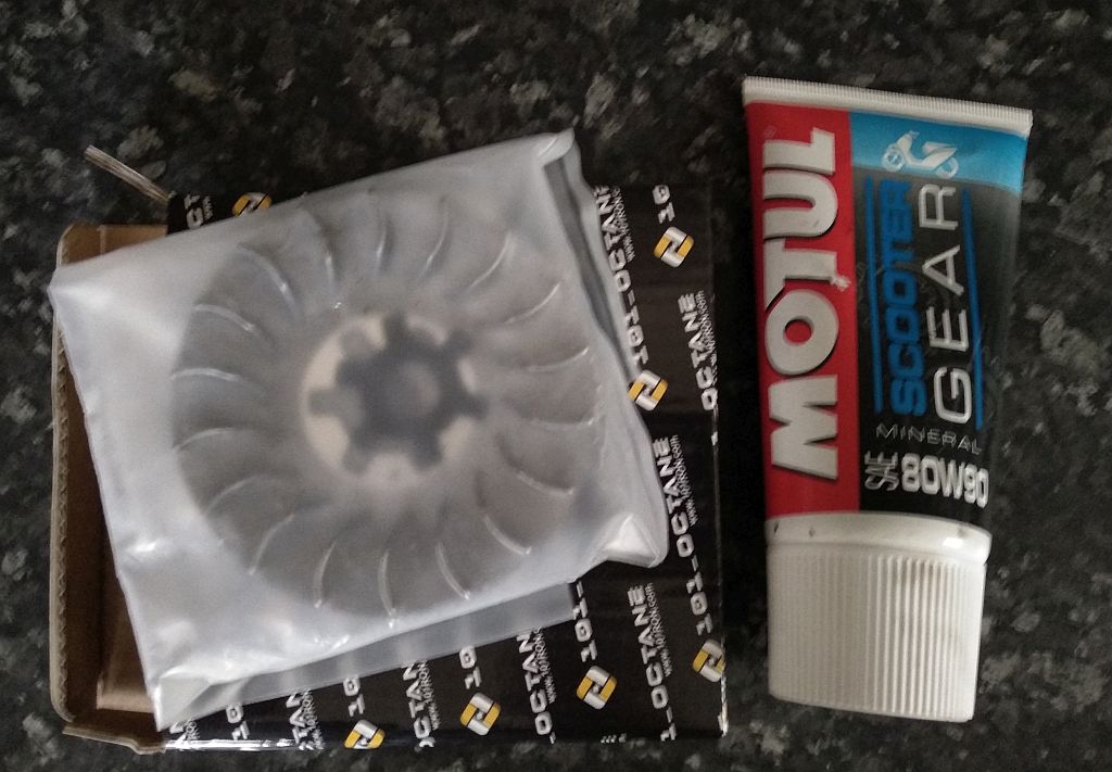

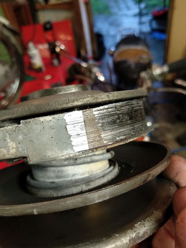

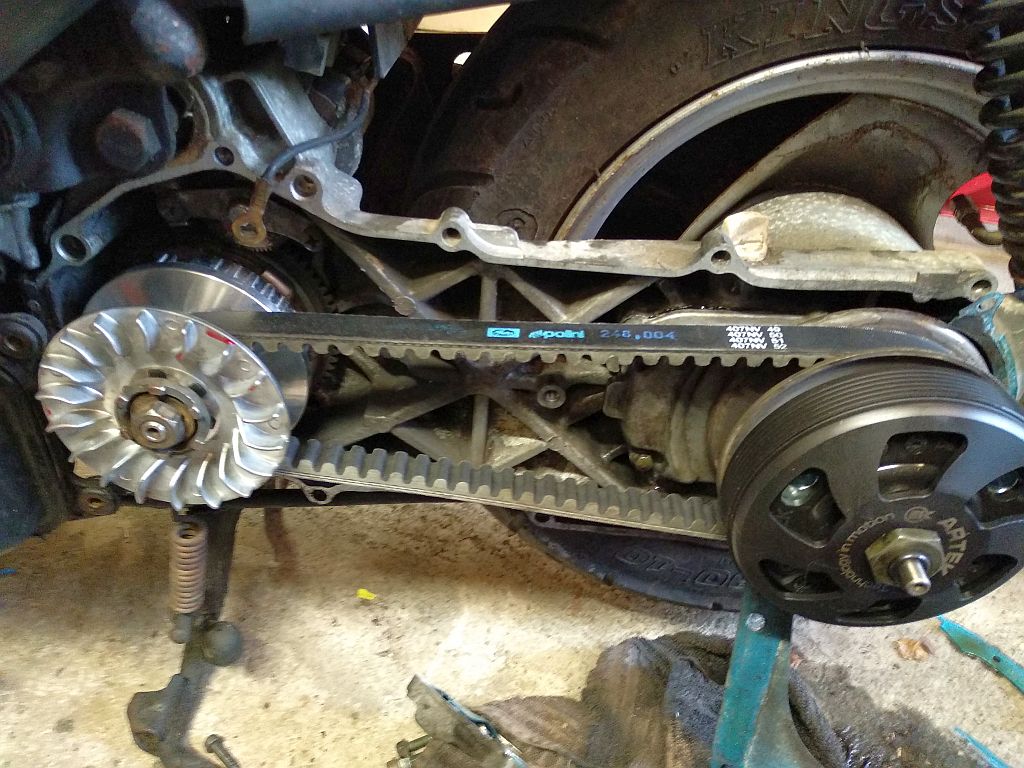

Sandy's Jog had been having issues with clutch slip since I got it going, whipped the cover off and it rapidly became obvious as to why... It's been a very long time since there was any pad on those shoes! The torque driver was fried too. So since I have a parts wreck here I figured it'd just be a simple case of swapping over the bits from that and calling it done... Maybe not Oh well I might as well raid the stock shelves then! ARTEK K2 clutch (really really nice kit!), Polini Hi-Speed variatior kit and Polini Kevlar reinforced belt should do the trick! The gearset input bearing sounded pretty bad, so while I had it apart to swap out the bearing I cleaned out the disgusting sludge from the gears And went back to the stock shelf MUCH better! Works damn well, although it's all rather overkill for a stock 49cc, so I may yet chuck a 70 kit and a decent pipe at it in the near future just cause it'd be a waste of a race clutch right? Oh and once again @64vauxhall came through with the goods and did a seat for it a while back Should be all good to go now!
